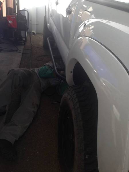

  15. Oct 1, 2013 at 7:20 AM
    #55
    Mademan925
    Mademan925 [OP] Senor Taco
    Nov 7, 2012
    #90668
    7,640
    Nick
    Discovery Bay, CA
    2014 4x4 TRD OFFROAD DCSB
    enough to go over stuff
    Got the rock sliders welded on. My wife thinks they are steps.
