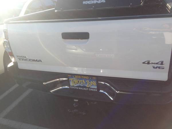

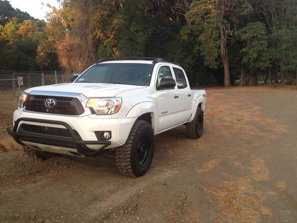

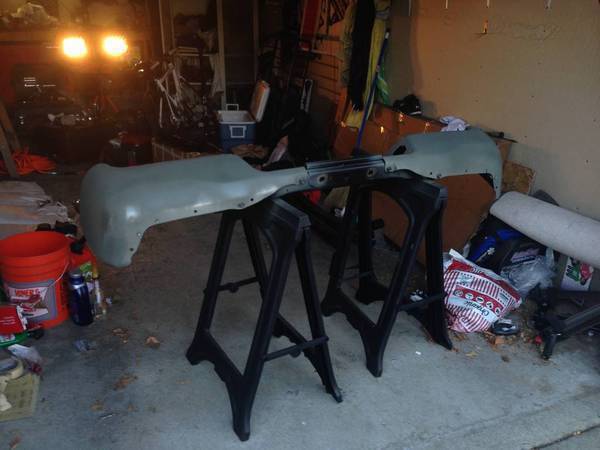

    Painted the chrome bumper with bedliner. Turned out great. The bumper is held on with 6 large bolts. I sanded the bumper. Then used two coats of primer then 4 coats of bedliner.

    Suspension: 2.5" Toytec coilover suspension with Blisten 5100 all around with 1.5" Block in the rear. Body: TRD Sport Hood, Matching Grille, Mirrors, Decal Removed Accessories: Folding Tonneau Cover
    Nice. This looks awesome. I had posted a question. As I want get the Off Road and then swap out the grill and bumper with the white like the Sport. Was also going to do the hood to get the hood scoop.

    Thanks. I wanted the offroad for Atrac and the locker. The hill im comming up in my sig pic would have been impossible without atrac. I ordered the white grill for the sport the day I bought my truck. I painted the rear bumper with bed liner because Im going to get a steel all pro one next year, but I couldnt stand the chrome. My truck is now chrome free. I keep checking craigslist for a sport hood. I'll get one eventually.

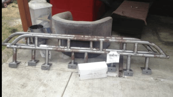

    I like your bed rack set up a lot

    Sick set up! What paint did you use for your avid bumper?

    I used rustoleum etching primer. Then I did rustoleum spray bedliner. (like 4 coats) turned out great, Used the same stuff on my rear bumper and rock sliders.

    Thanks. Its just two of KBVOODOO's brackets that mount to the bed cleats, two bike fork mounts, and a standard cargo rack.

    sweet build.
    love the rear bumper idea. how hard was it to remove the plastic step tops?

    The bumper is hard to get off. Its 6 bolts 2 on each side, 2 above the hitch and two license plate lights that need to be taken out. Once you get it off. Behind the license plate there are 3 small screws. take those out. The plastic on top has clips on the inside of the bumper. The side peices come off last and are the hardest. They are each held on with 1 clip and 2 screws. The bottom plasic has two screws underneath and two clips ontop under the squares that can be removed with a screw driver.

    WHERE DID YOU GET THAT BED RACK?/TIRE RACK?

    Its just two of KBVOODOO's ( another tacoma member) brackets that mount to the bed cleats, two bike fork mounts, and a standard cargo rack I picked up on eBay.
    Here is a closer pic on my old truck.
