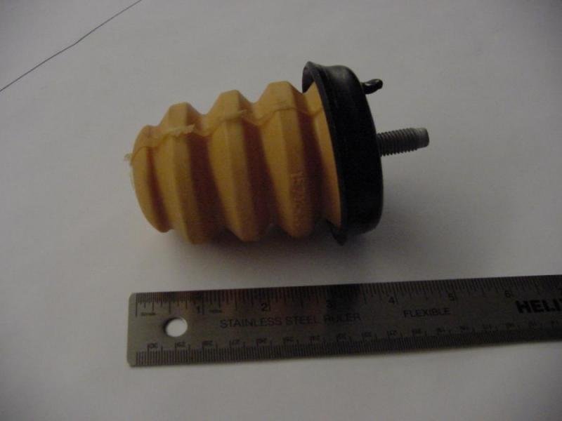

    Oh by the way. If you want a great substitute bump stop over rubber, get them from GM. Their full size Chevy Silverado bumps have been fantastic on my rear end! It's like landing on pillows in the rear! Add some thick washers to the stud to equal out to 4.5" mount to the frame and you are set.
    669763d1336057305-can-only-buy-one-pair-_ce5efb7b8d58b67f3005a83ada0668d22a845979.jpg
    Part# 15712438

    Wonder if this would work for 1st gen, hmmmm. Good find.

    Should have told me a week ago. I got the ones below because I had them in a 2.5 and they were great.

    Been running them for two years now. And I jump my truck. They have been awesome stops. Since they are meant for a full size truck, they can more then handle the rear of the second gens. Even more so of the first gens.
    I KNOW they would work on first gens. You can make anything work. If the rear end of the 1st gens are anything like 2nd, you can mount them to the frame like I did mine.

    So the shock extensions do not fit icons but it was worth a try. Hopefully the longer bump stops will keep the wheels off the fenders with the new spacers.
