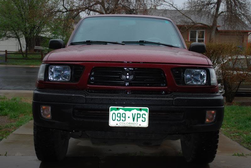

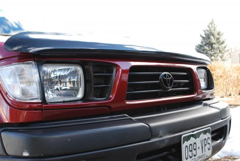

    The only thing is the top edge of the bumper/valence is perfectly in line with the bottom edge of the grille and fenders. If I "tilt" the bumper/valence up to fill that gap, then the sides that wrap around to the fenders won't have even lines.
    The issue is the 98-00 bumper/valence drops down in the center. That contour is to accommodate the 98-00 grille which sits lower than both the 95-97s and 01-04s. So a gap is created between the bottom of the 95-97 grille and 98-00 bumper/valence.
    When I literally held up the 01-04 bumper/valence I now have to the front of my truck, I believe it will line up much cleaner with the 95-97 grille.
    We'll see :notsure:
  10. Jan 12, 2014 at 10:56 AM
    #430
    Madjik_Man
    Madjik_Man [OP] The Rembrandt of Rattle Can
    Dec 2, 2009
    #26893
    19,780
    Colorado Front Range
    1998 Ext Cab 3.4 4x4 TRD 5MT, 2004 DC 3.4 4x4 TRD
    20b2564e-ef16-4ed2-9116-f567eff32969_zps_35f58fce8e2f817e39faf5a68f9451ac2bb1115e.jpg
    You can still see that there is a little gap with the stock set up but not nearly as pronounced.
    Strangely the 98-00 grille doesn't sit lower than the 95-97 as I thought. They're both lined up with the bumper fillers.
    I figure come spring time when I'm finishing the 01-04 bumper I have, I will remove the grille and spray paint the a/c condenser, that bracket, et al black. That should hide it better

    Maybe it's the angle of the photo, but it looks to me like the driver's side corner of the bumper/valance is sagging. Looks like no gap on the passenger side and at least a 1/2" gap on the driver side. :notsure:

    I think it may be the angle... I'll have to look closer.
    At this point both of the sides of the bumper are being held on by zip ties. Those piece of crap white plastic brackets that get bolted on the side have broken off.

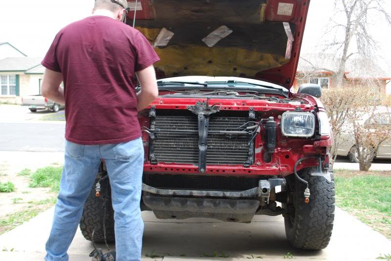

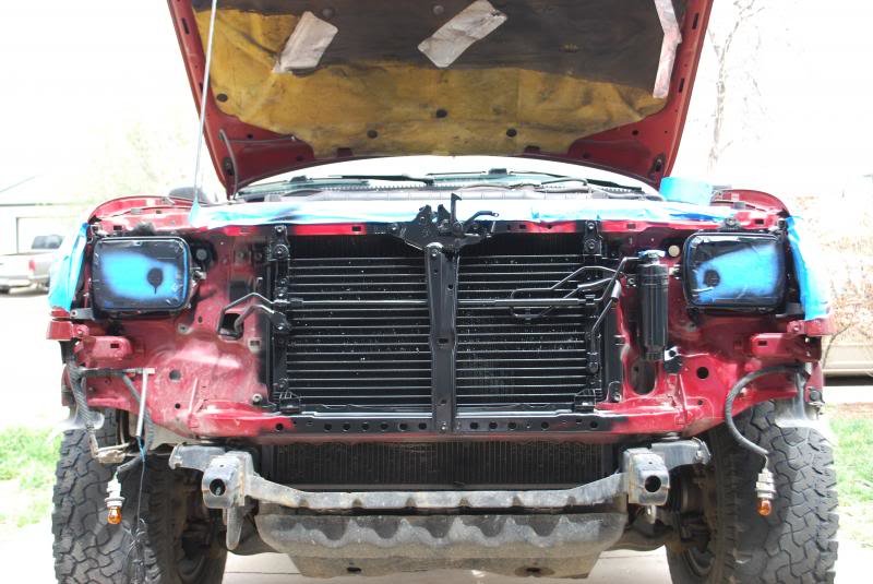

    So Jon comes over and I thought, "today will be the first day we just hang out and not mod/molest a truck."
    Next thing I know he must have slipped Ol' Red a roofie... because he has Ol' Red pretty much naked and is groping him...
    I have no idea what he's making my truck do to him here :(
    Took the grille and bumper/valence off to accomplish a couple of things.
    1. See if the 01-04 bumper/valence would work. Negative ghost rider. It just did not match up with the 95-97 grille whatsoever.
    2. To paint all the crap on the core support so it blends in behind the grille better.
    3. Most importantly... put Jon's 01-04 horns on my 98. NO MORE "MEEP MEEP!!!"

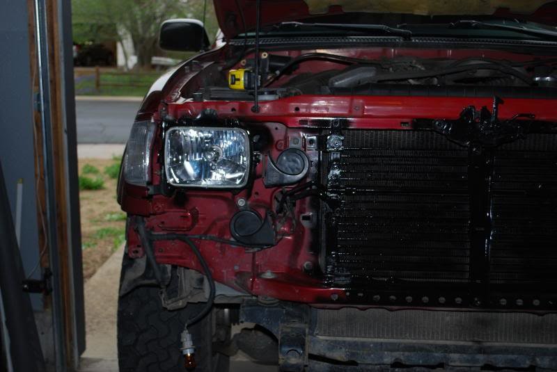

    Surprisingly Jon wants the wussy 98 horn so a part of Ol' Red will be mobbing up rocks and racing in the desert.
    Painting behind the grille... gave Ol' Red some eyelids
    Here's where I mounted the 01-04 horns. One in the stock 98 location and the other underneath the headlight. There was a threaded hole already in the core support and I just so happen to have the perfect bolt for it. It's the perfect spot because it does not interfere with the 95-97 grille.
