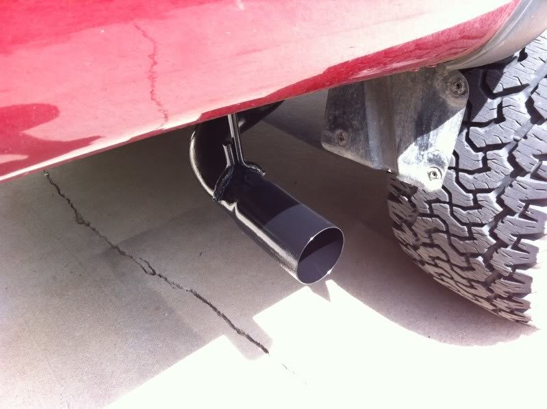

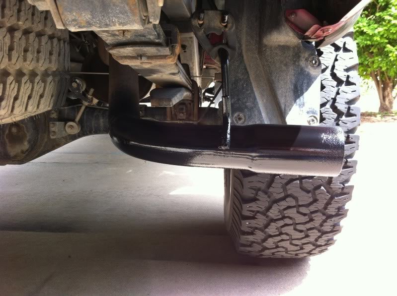

    Wire brushed all the rust off my exhaust tip and painted it

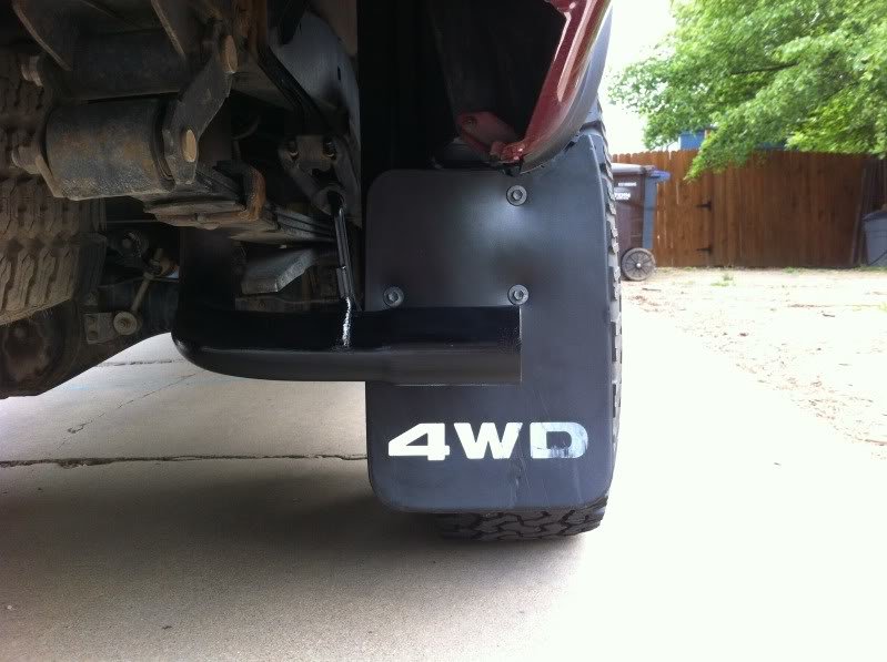

    Looks good! I'd take the mudflap brackets off though to clean up the look a little. Just a suggestion

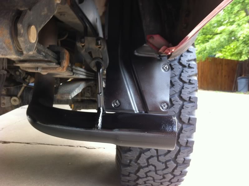

    Yeah, I'm about to go outside, take all the mud flap brackets off, clean them up and spray them down with rust reformer primer (just in case).
    Take off and clean up all the mud flaps real well (something I don't really incorporate into my normal wash routine) and give them a nice 303 treatment.

    Thanks.
    FYI if you ever do this, most primers are not heat rated enough for the exhaust.
    So I just wire brushed it, cleaned it, then sprayed the high heat (grill paint - 1200 degrees F) directly on it.
    I'll let you know how it holds up.

    Done
    And done

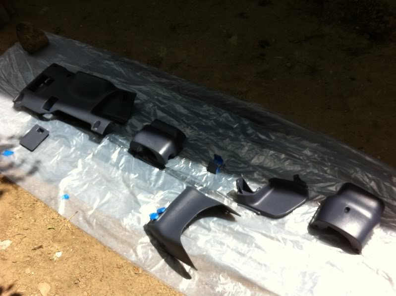

    Pulled all the dash trim pieces out, primed and painted them black. I'm kind of hung up on whether or not to keep them semi-gloss or not. They're glossier than the OEM trim pieces (stereo faceplate, gauge cluster surround, etc) but I don't want the grungy look of flat. I like the ease of clean up with the semi-gloss so far. Maybe I'll try to find something in between flat and semi-gloss... Is that matte or satin?
    Below is a before shot... they're drying in the garage because of all the cottonwood flying

  14. May 3, 2012 at 1:12 PM
    #54

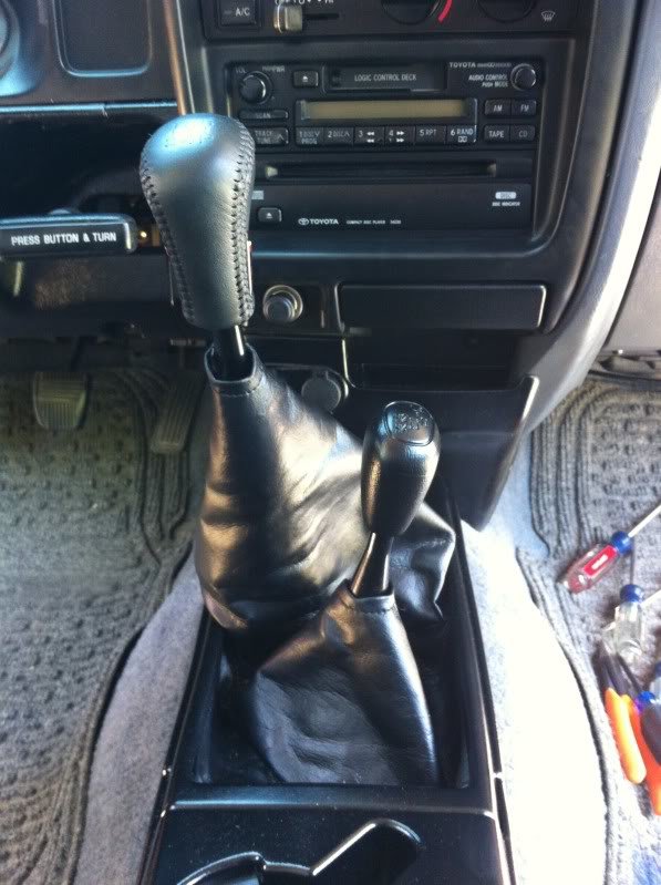

    So far I've painted (as you know) my center console/cup holder assembly, shifter trim, vinyl dyed my shifter boot(s), and vinyl dyed my transfer case knob. I have no smell whatsoever.
    The worst was the TRD transmission shifter knob I bought. The friggen glue smelled god awful. I bought it back in November or something.... let it sit in my garage until about 3 weeks ago. My garage stunk the whole time and my truck stunk quite a bit as well while that thing still off gassed.
    My hand will still smell a bit after driving too.

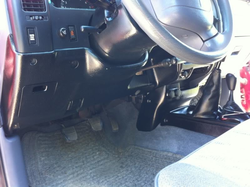

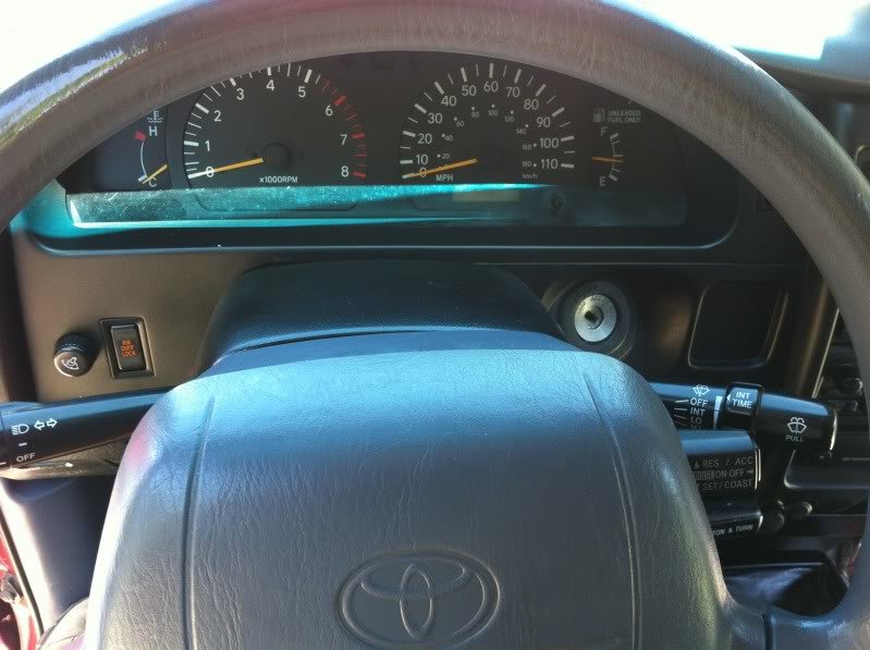

    And yet another post as to why I named this build what I did...
    Installed all the dash trim pieces that I painted black yesterday.
    The semi-gloss is not that good of a match to the factory OEM black trim pieces which appear to be more flat. However, it's better than the fading blue/gray I was constantly faced with every day.
    Anyway... if my spray painting skills didn't suck major balls (seriously, if I ever developed a huffing habit, I'd screw that up too) it probably could have come out better. And of course when reinstalling the pieces (namely the two caps that sandwich the steering column) I took major chunks of paint of the trim....
    ...so what do I do? Saturate the end of a q-tip with spray paint and do a little touch up. lol.... yeah, that's my style [​IMG]
