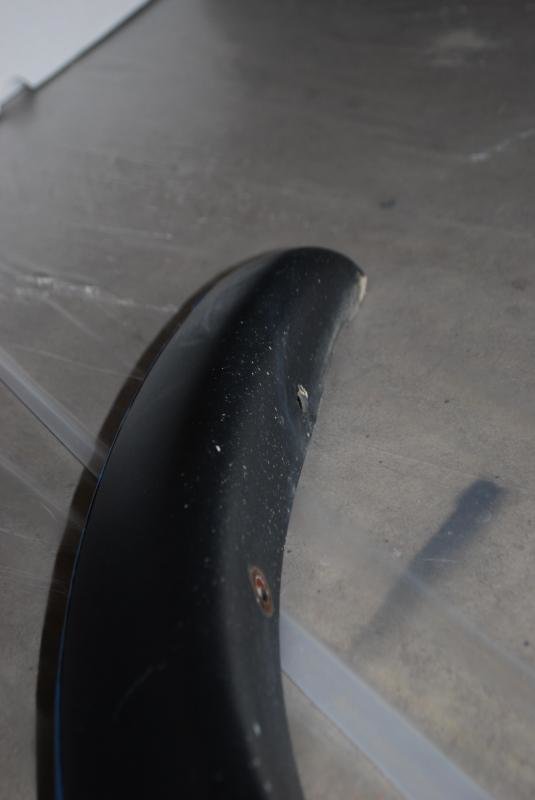

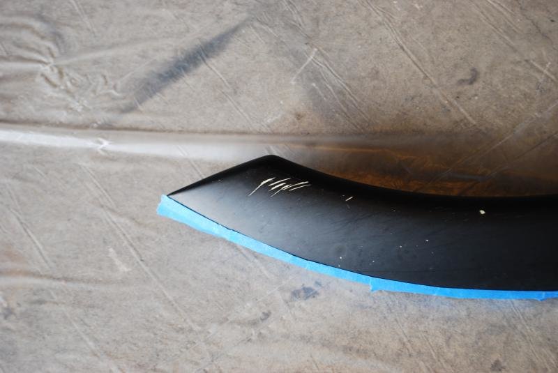

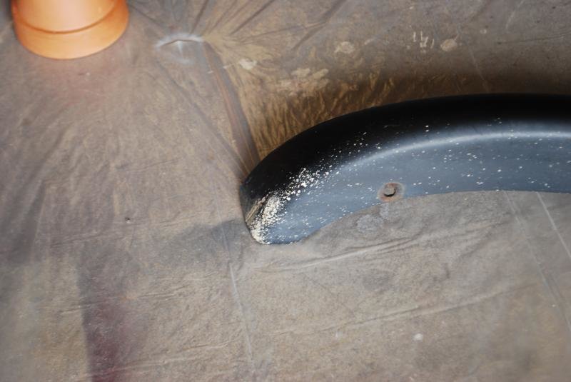

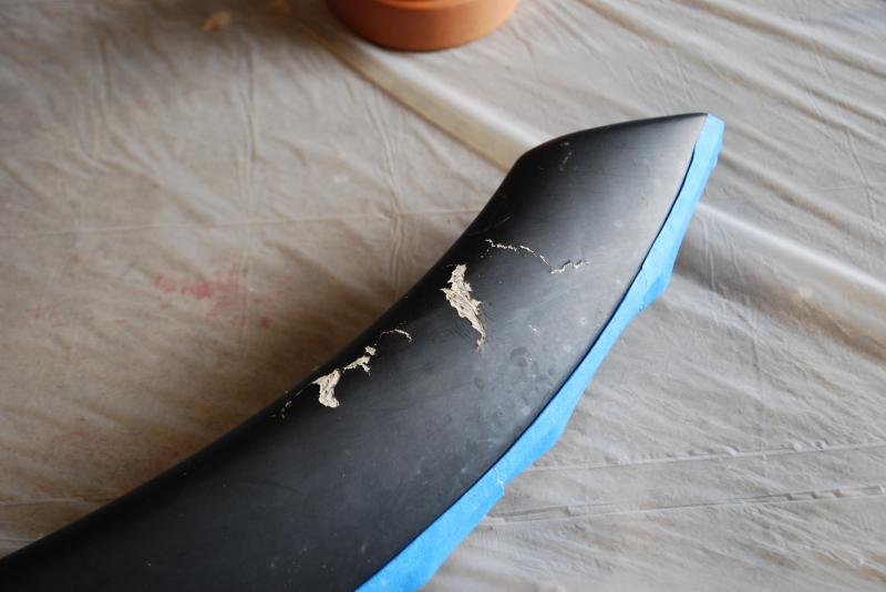

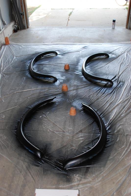

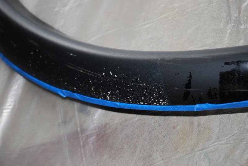

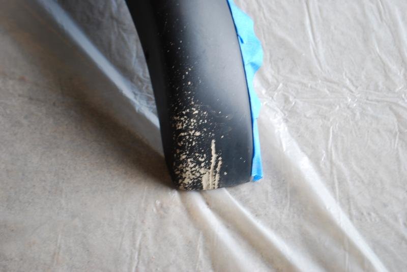

    Fender flare restoration in process.
    Deliberated on whether or not I wanted to color match them or not. Aside from deciding the black would look better with the grand scheme, it's also a fraction of the cost in materials.
    My flares are all chewed up. The 98-00 flares are fiberglass so the only way to do it right would have been to repair with fiberglass, sand, etc...
    Way too much for my blood.
    Decided I'd try filler+primer to see if I could fill the nasty gouges then sand them down. After a few coats in selected areas I realized this process would be more than I'd want to deal with.
    So I embraced my "fuck it, good enough" philosophy.
    Clean with soap/water, dry, mask, wipe with prep wipe, let dry, 3 light coats self-etching primer and about 4 or 5 light coats Rustoleum semi-gloss black enamel.
    Here they are just before primer:
    Here they are drying:
    I'll put them on tomorrow afternoon/evening.

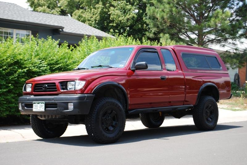

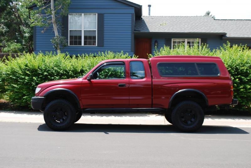

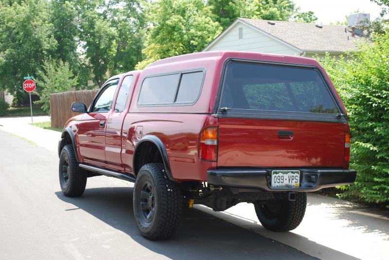

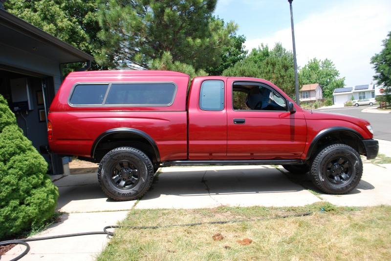

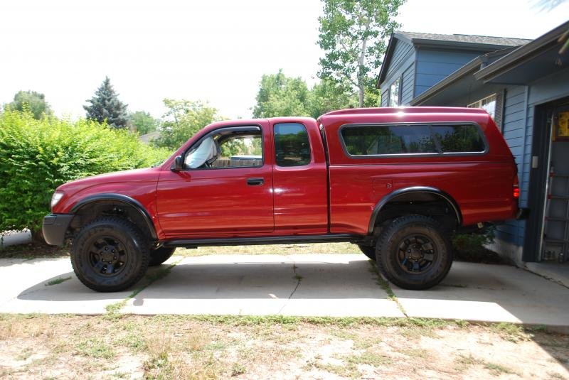

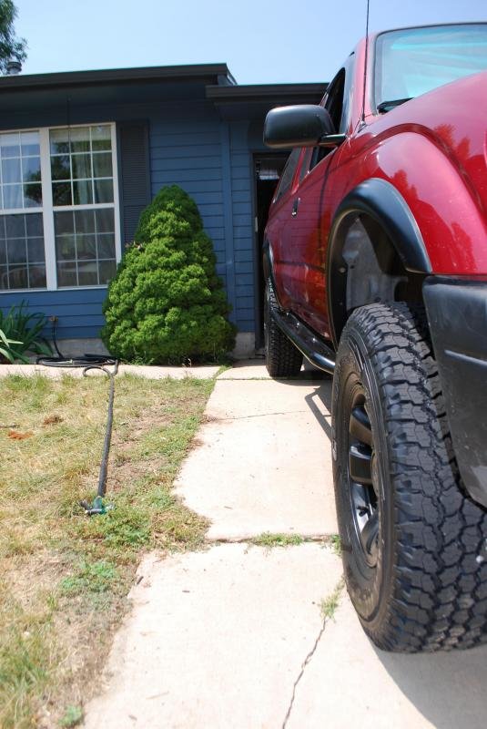

    Discount Tire wouldn't use the black lug nuts 45acp gave me because they were meant for the steel wheels, not the alloy wheels. So I placed an order for the correct black lugs.
    Anywho... here's the truck all dialed in, lest those black lug nuts. Discount Tire also put fucking tire shine on without telling/asking me. I fucking hate glossy tire shine.
    Just have to refinish the front and rear bumper and he'll be looking young again.
    Painted rims and new Goodyear Adventure All Terrains 31x10.5 r15

    Looks really good!
  19. Jul 15, 2014 at 12:03 PM
    #599
    kigmob
    kigmob Well-Known Member
    Jul 18, 2012
    #82906
    1,134
    James
    New Orleans
    97 TRD S/C 4x4 V6 5spd
    ICON/TC TRD Supercharger URD 2.2 and 7th
    Looks good! :thumbsup: but why only 31's?
  20. Jul 15, 2014 at 12:07 PM
    #600
    dispatch55126
    dispatch55126 Well-Known Member
    Mar 12, 2014
    #125193
    976
    MN
    2004 Xtracab SR5
    Complete OME kit w/ 881's and dakars. All-Pro Sliders, CB, HAM Radio and various other minor stuff.
    That's as big as I can go without regearing.
