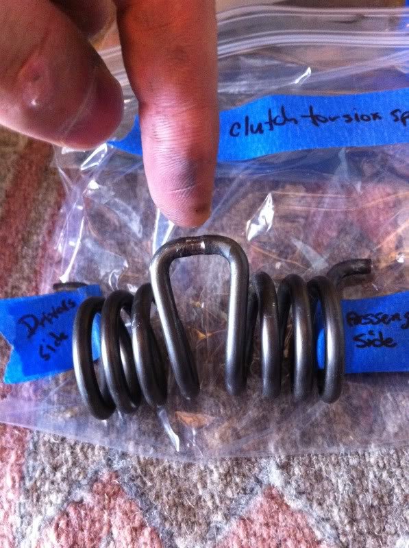

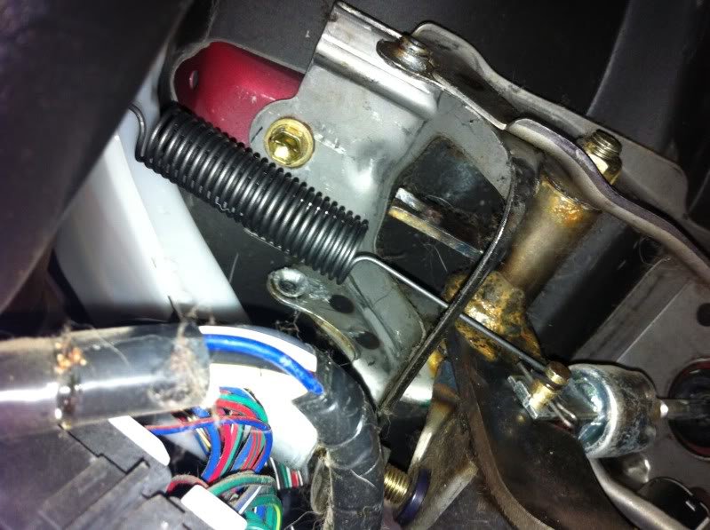

    Did the "clutch pedal squeak" mod (thanks trmarshall1 for the brake pedal return spring!)
    I actually took the bottom portion of the dash off (I mean, it's four bolts and a screw) because I'm not a contortionist and I had a hard time getting leverage on the torsion spring.
    I also only have a large crowbar... that didn't fit under there, so I was using the largest flathead screwdriver I have for the prying. I had a slight bitch of a time getting that middle part (2nd pic) out of the groove on the pedal. I'm going to go back out there and just bend the one end of the spring around the head near the cotter pin, for peace of mind.
    But all in all, it took me less than 10 minutes. Took Ol' Red for a test drive and I love the feel of the pedal now. Just slightly tighter feel than original. Plus it returns to the utmost position which is nice for the cruise control switch. (I'm just going to have to get used to not sticking my foot behind the pedal now :) )
    Oh... and most importantly. NO MORE SQUEAK!!!

    I did the same thing with mine, works much better. Seems like it would be a lot more practical for them to just be made that way! And when u did mine my hand slipped and I gouged my knuckle good on that galvanized looking metal piece where the spring hooks, I was of course in the runnings parking lot when I did it lol

    How'd the linear spring swap mod go?
  20. Jun 4, 2012 at 6:13 PM
    #80
    Madjik_Man
    Madjik_Man [OP] The Rembrandt of Rattle Can
    Dec 2, 2009
    #26893
    19,705
    Colorado Front Range
    1998 Ext Cab 3.4 4x4 TRD 5MT, 2004 DC 3.4 4x4 TRD
    Excellent.
    I love the feel of the clutch much better now and of course, no friggen noise.
    Thanks for the spring.
