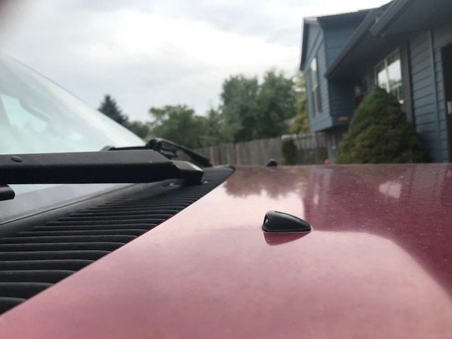

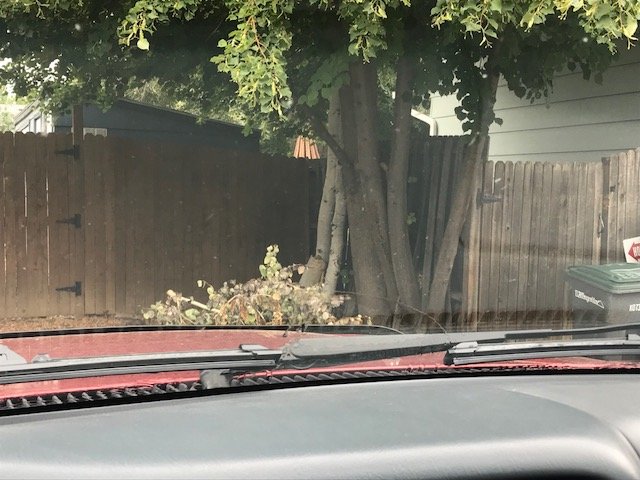

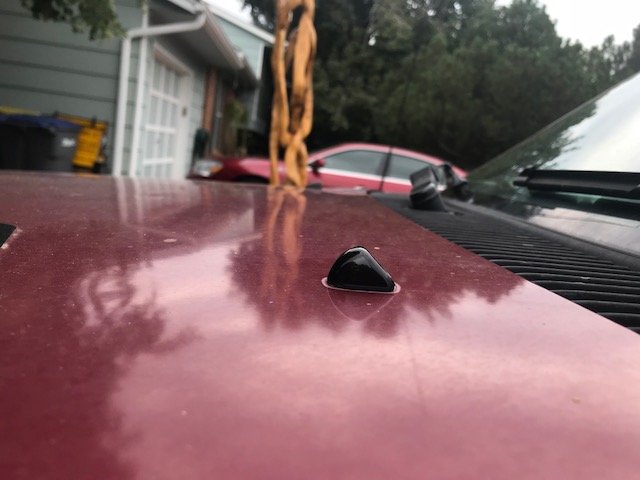

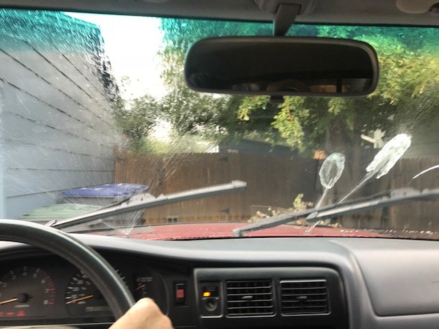

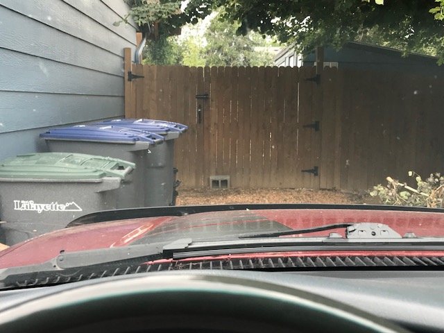

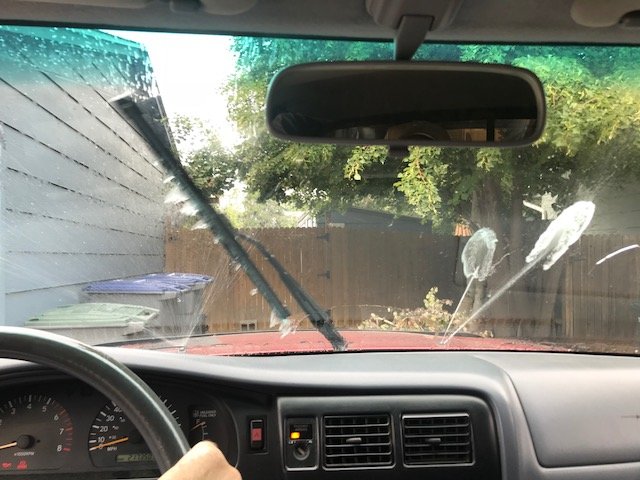

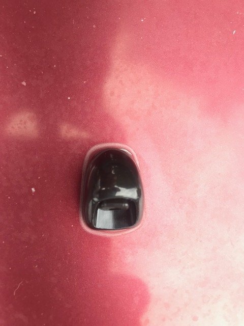

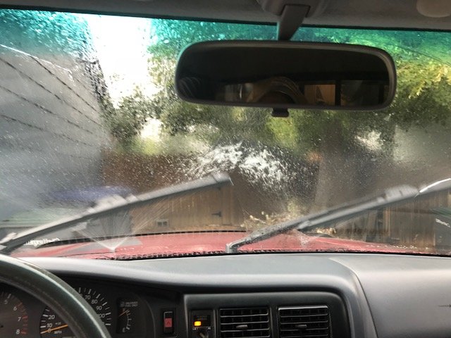

    Just installed the Odyssey sprayers. Great upgrade. I love how you can adjust them left/right and up/down. They're perfectly dialed in on my windshield now and the dual fan sprays cover the entire windshield. They definitely do not have the same velocity as the OEM ones so I'll be interested to see how they perform in wintry/mountain highway conditions.
    Things of note that might help:
    The barbs are positioned at the 12 and 6 o'clock positions. Take a flat head screw driver and gently pry one of the barbs back to slip the nozzle through the hood. If your OEM ones are anything like mine, they'll disintegrate into pixie dust as soon as you touch them.
    I also had to use a little bit of heat (bic lighter) to get the passenger side supply hose off the OEM nozzle port. My hoses definitely show a lot of age. Be careful. Lastly I had to use a pick tool to get the old port out of the hose after the nozzle grenaded.
    The Odyssey nozzles come with a gasket that sits between your hood and the nozzle. No need to reuse the OEM ones. However the OEM ones would have fit nicely. So check to see if whatever nozzles you buy comes with the gaskets. If not be sure to save and reuse the OEM ones.
    They definitely have a significantly higher profile than OEM but a smaller base so it will show a funky paint border:
    OEM in the background
    OEM in the foreground
    But it's okay, you do not see the nozzles when you are in the driving position:
    Comparison of driver's side Odyssey to passenger's side OEM spray pattern. This was before I adjusted the driver's side. Huge difference:
    Here is with both Odyssey nozzles on and adjusted:
