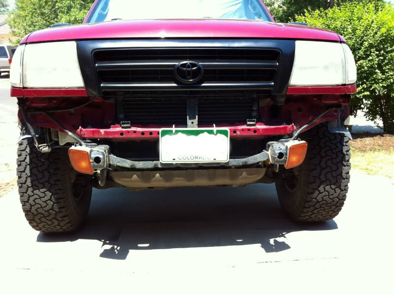

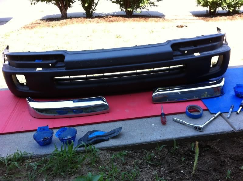

    Very easy. Instead of trying to remove the valence from the bracket that holds it to the frame, just remove the bracket from the frame. You'll see two 14mm bolts per frame end (by the bumper stops). Remove those 4 bolts.
    There are also two 10mm nuts (with rubber grommets on them) that you will need to remove as well. There is one per side kind of near the fender well behind/under the corner light. There are vertical thread hanging down through a hole in a bracket attached to the valence. Take off that 10mm nut thing and then gently pull the bracket over those threads.
    Lastly there are two piece of crap plastic screws that hold the bottom of the valence to the frame. When I tried unscrewing mine they just turned and did nothing. So I had to break them apart (now using zip ties)
    I'm on my phone but when I get back I can post pictures of everything if you want. Of course hit me up if you need help tomorrow.

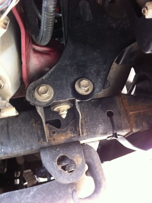

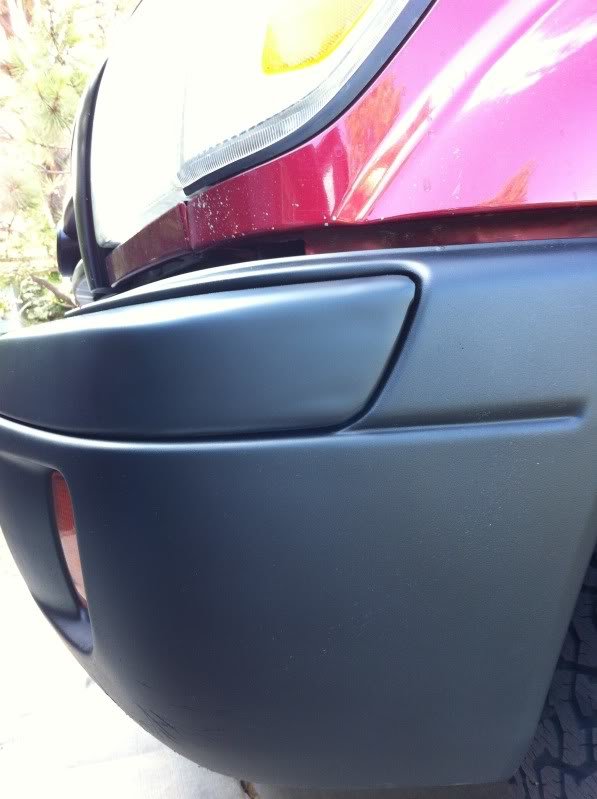

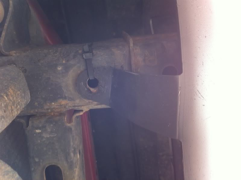

    Here are the two 14mm bolts. This is looking up from the ground on the passenger side. Very easy to spot. You can also spot the zip tie where that plastic screw was holding the bottom of the bumper to the frame.

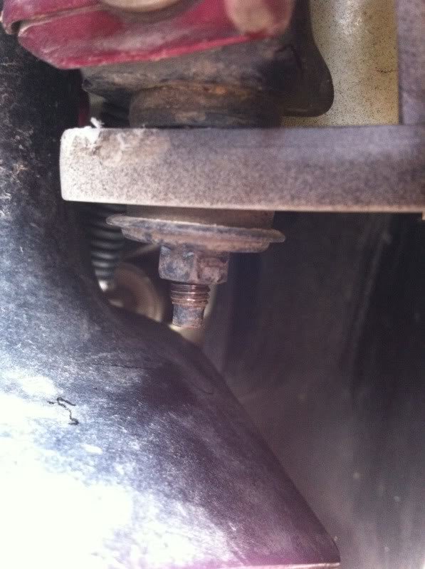

    Here is that 10mm nut with rubber washer. This is taken from inside the passenger side fender well looking to the front of the truck. This is below/under the corner light. You can see the blinker light wiring harness in the background for reference
    And here is the (the remains) of that plastic screw holding the bottom of the bumper to the frame. This is looking straight up from the ground. And honestly the zip ties are holding it in place more securely than the piece of crap screws ever did.
    Remove those four 14mm bolts (two per side), two 10mm nuts (one per side) and two plastic screws (one per side) and the bumper will come off. Now that I know what I'm doing, it would take less than 2 minutes to do so.
    Let me know if you need any more help, today or tomorrow.

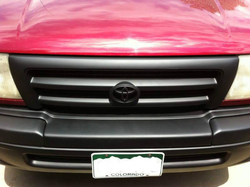

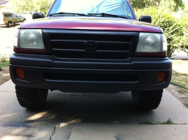

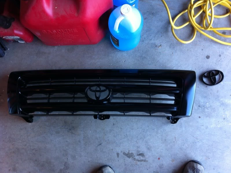

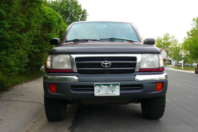

    Painted the former semi gloss black grille flat black to match the bumper

    Lookin' much better. Got any pictures of the whole truck with the new painted front end?

    I can get one tomorrow.
    The thing that triggers my OCD now is I need to restore my headlights again.
    They look even more awful now.

    When I mounted mine I just rested one end on my cat carrier for support while I worked on the other end. Any ole thing will do... just get a box or something. Makes life easier.

  18. Jun 21, 2012 at 10:48 AM
    #118
    Madjik_Man
    Madjik_Man [OP] The Rembrandt of Rattle Can
    Dec 2, 2009
    #26893
    19,780
    Colorado Front Range
    1998 Ext Cab 3.4 4x4 TRD 5MT, 2004 DC 3.4 4x4 TRD

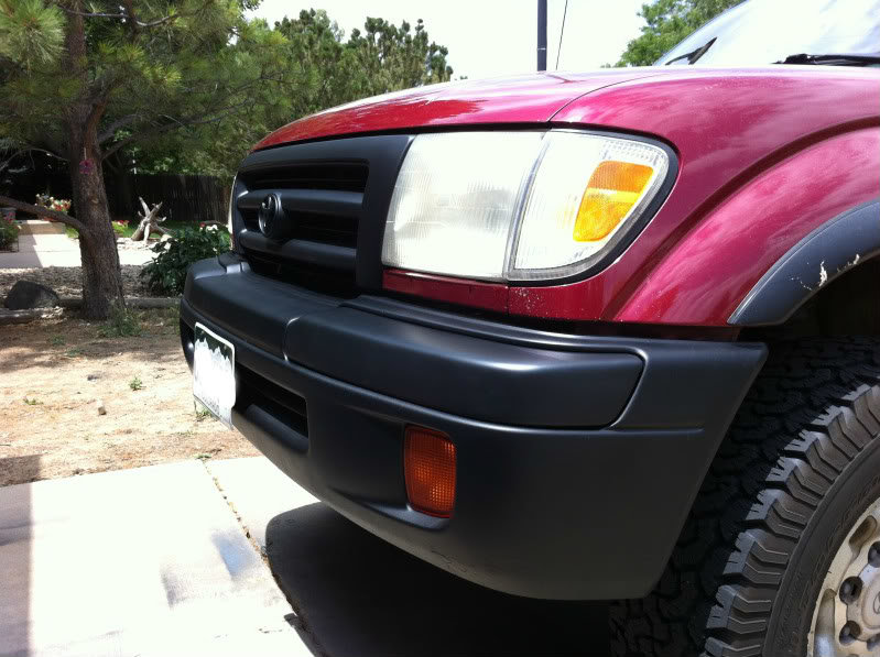

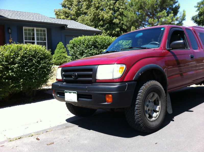

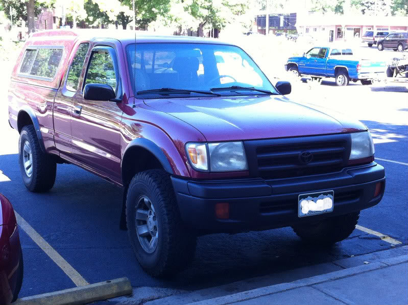

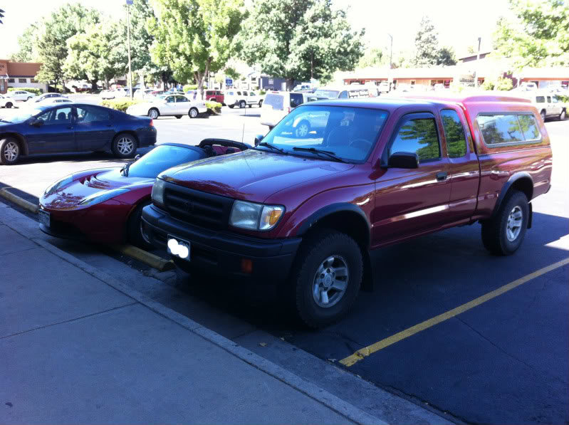

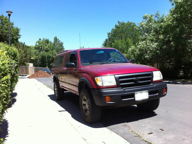

    3 in the shade, 3 in the sun. Please excuse how dirty my truck is... by far the longest I've gone without washing it.

    You did an awesome job with that bumper man. Looks great! Pretty damn clean '98.
