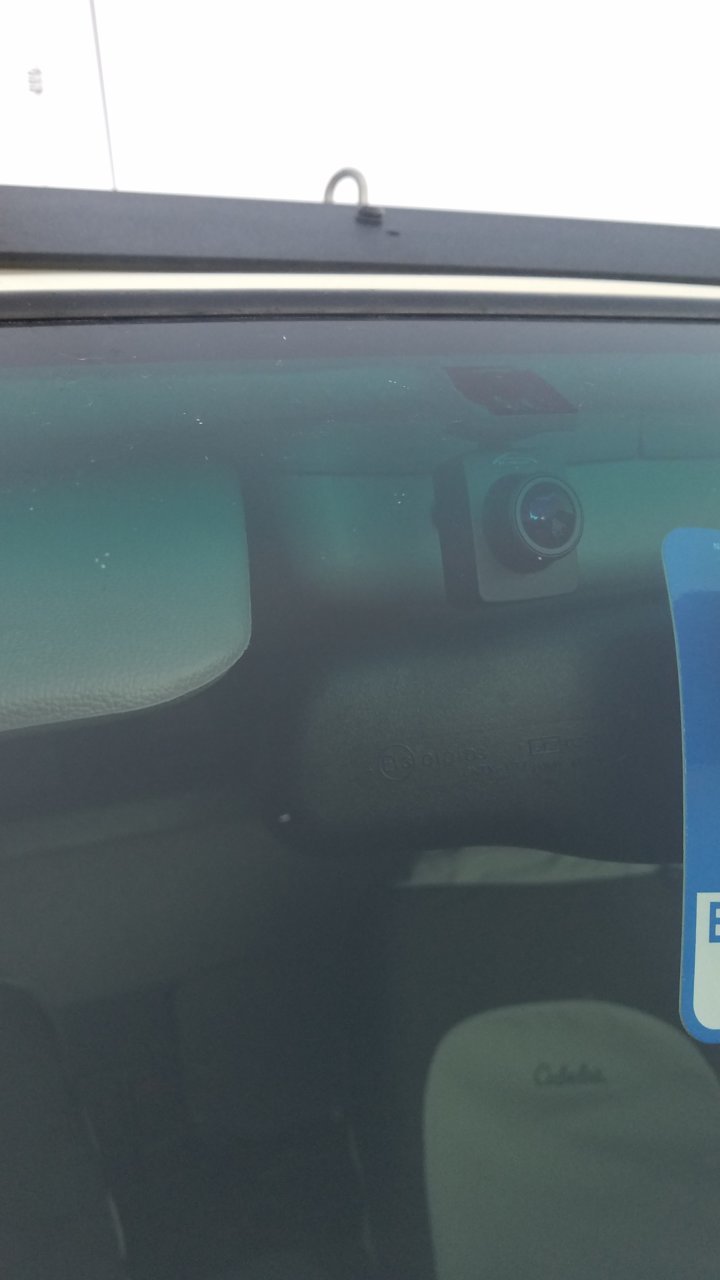

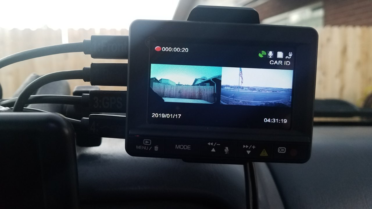

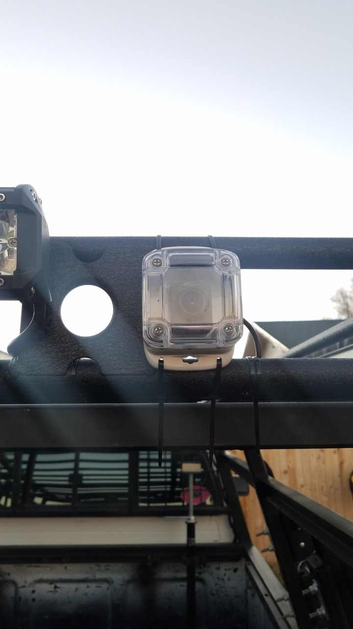

    Added a dash cam to my truck. I still need to route the cables but I'm happy so far.
    Split screen
    Front camera
    Rear camera

    What model did you buy? I have been looking at them for a bit now. Still no decision.

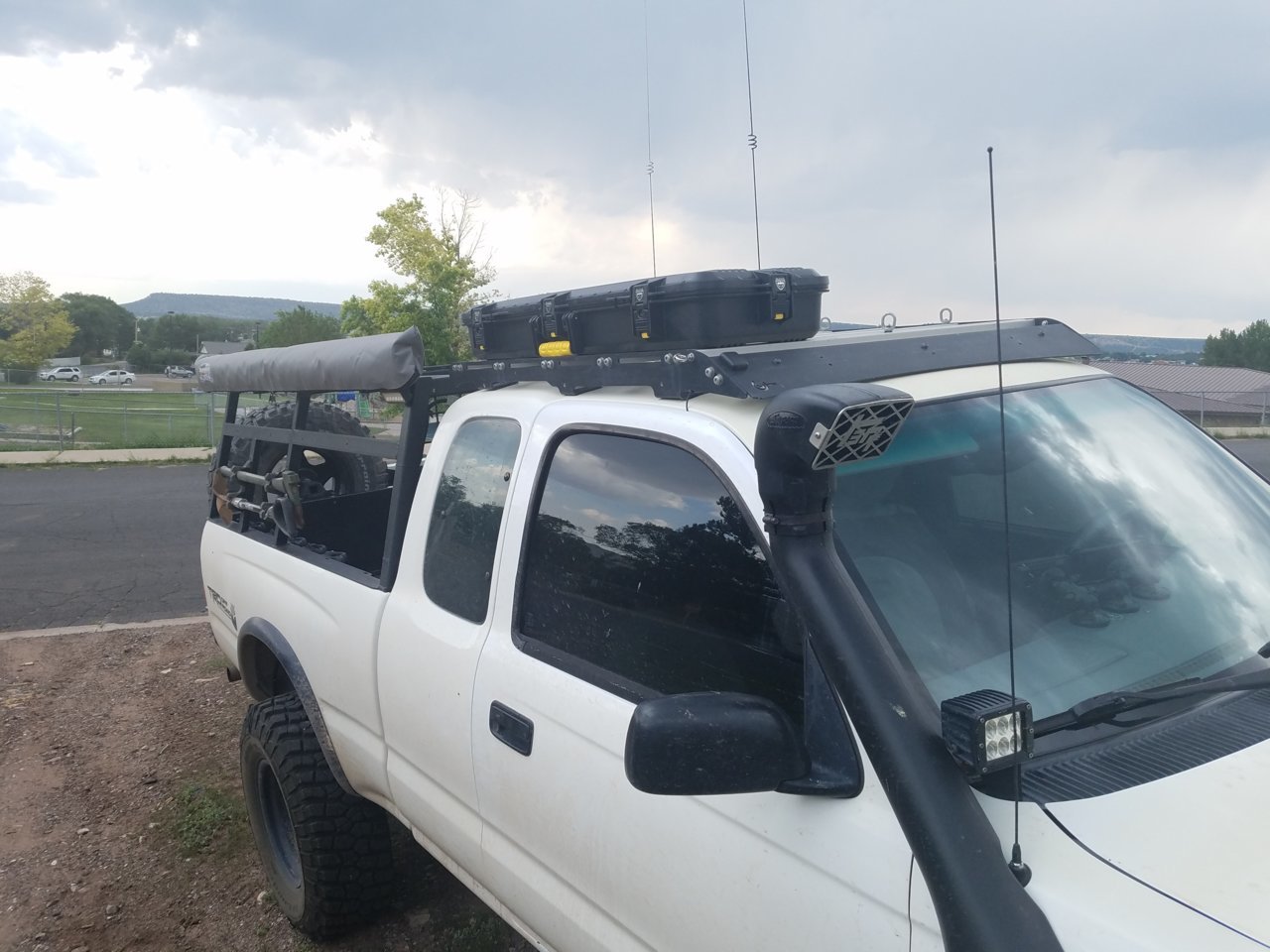

    Awesome build! Curious, what case do you have on your roof rack and how is it attached to the rack?

    36" Plano Gun Guard AW Tactical case from Amazon. I used carriage bolts in the roof rack channels and drilled holes through the bottom of the cases.
