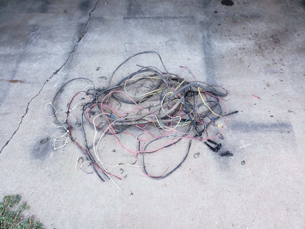

    I took a lot of shortcuts with my wiring in the past. Well today I pulled all of the excess wire and redid the rest. I still need to redo the wiring to the rear and bed of the truck.
    This is the mess I removed.
