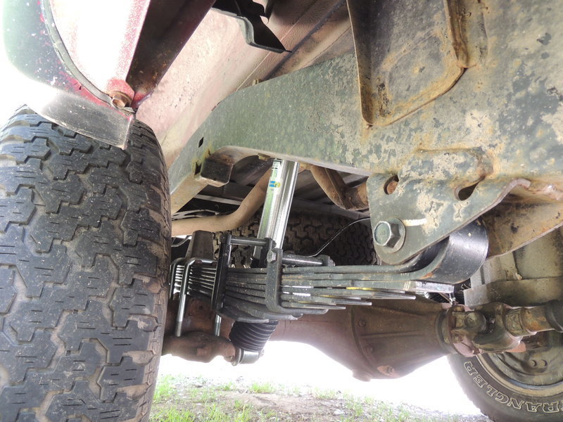

    Adjusted schedule on the 16” wheels and tires due to this:
    A question for you on your rear suspension, I have the OME full HD spring pack with their AAL, and I’m wondering about the Toytec progressive overload. I carry quite a bit of weight and under domestic cruising loads I loose the rake, and same with pulling a trailer. Are they a pretty straightforward install, longer u-bolts and such. Do they about 1-2” lift just from the pack thickness? Current look:
    This is after the full OME swap with the OME greaseable shackles and the new Bilsteins.

    I finished my Tundra brake upgrade today. It is okay, I may need to see if I can bleed the brakes again.
    I have the OME Dakars without their AAL's. Instead I installed the ICON progressive AAL's and the u-bolts that came with that kit, that added about 1-1/2" lift. And I used the factory AAL and shackles.
    It is a pretty soft ride when empty.
    I don't have much rake, I would like maybe an inch more in the rear.
    I use my airbags for heavy loads, but it gives a stiffer ride when empty.
    My Tacoma is 5280 pounds empty if that helps with your calculations.

    Looks good, I’ll have to chat with Wheeler’s and see if I have to pull the AAL. So it would look as though the short leaf on the bottom of the OME pack is the overload, another thing to confirm. Right now a house wiring project has my attention. But thanks for the response, we have about 7” of fresh wet snow and it is getting warmer so the truck is just going to sit for awhile.

    My OME Dakars came with the two AAL springs, I just chose to use the ICON's I already had. I used the factory AAL for fear of the two OME AAL's would be to much.

    Yeah, I was going through my thread and saw the that mine did come with a pair of overloads as well, so I have an inquiry into Wheelers so I’ll see what they say, probably wishful thinking to try for some arc to springs, the design seems to favor a slight smile to a straight spring. Might go with some Timbrens to help out with the saggy butt, towing syndrome, kill to birds with one stone as far as bump stop upgrade as well. It would be nice to get the Billies 5125 a bit more extension, improve the ride a bit, although it does ride pretty nice both loaded and empty? (Yeah right, haha)
    Good call on the Icons, not sure what the Wheeler’s AAL pack is so, maybe their in house stuff. My idle parts pile for Taco is pretty lean, fairly substantial for my 85 and the diesel, always tripping over something out by the driveway.
