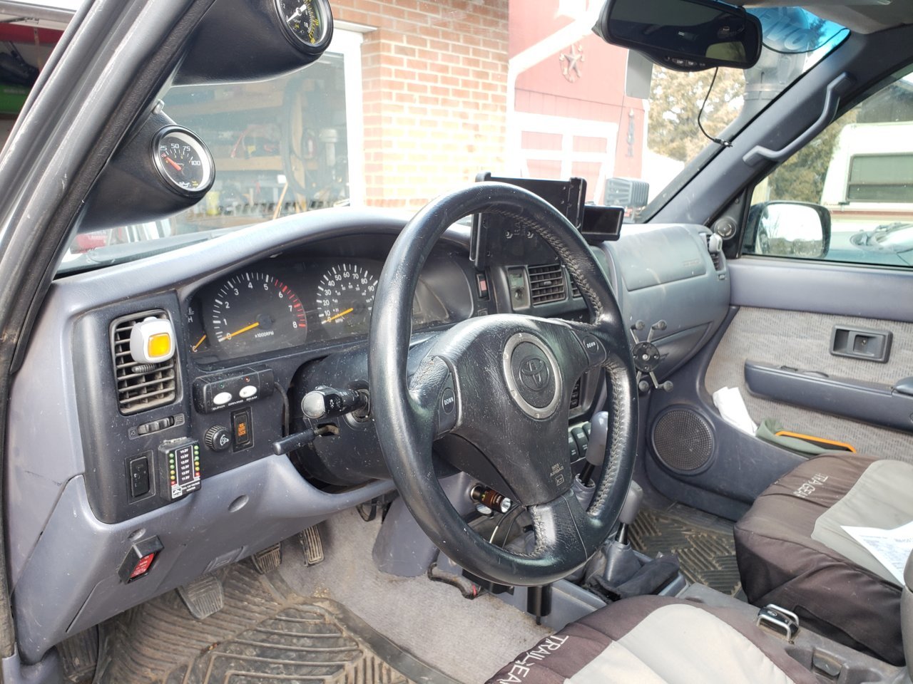

    I swapped out my old steering wheel for a Lexus IS300 one with a Rav4 center section and 4Runner column plastic.
    I still need to get the correct clock spring and do the resistors on the C/C shaft.
    But I like how it looks.

    I really love this swap.. What do the up down buttons control?

    Nothing right now, I was thinking of running them to my front driving lights.
