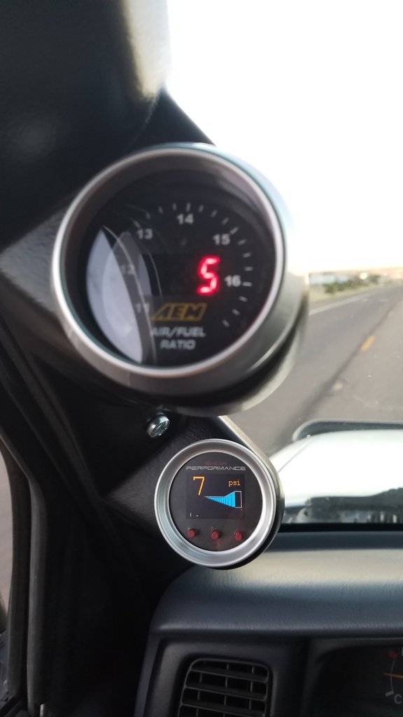

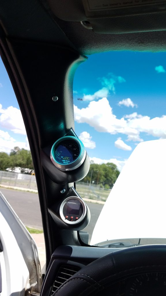

    I still have a ways to go, but I was able to install a few items.
    Snow Performance Stage 2 methanol injection.
    Gauge pod with Snow Performance controller and AEM air/fuel gauge.
    SwampYota and 04yota like this.

    I dig it! Was it hard to wire your speakers to the ceiling like that?
  5. Aug 26, 2017 at 1:15 PM
    #25
    Phessor
    Phessor [OP] Well-Known Member
    Feb 15, 2014
    #123156
    3,580
    Bob
    1998 TRD XTra Cab
    Stuff
    No, I removed the A pillar covers, loosened the rear side pieces and worked the headliner out. Just make sure that is where you want them. Then I taped the wires to the headliner and reinstalled it.

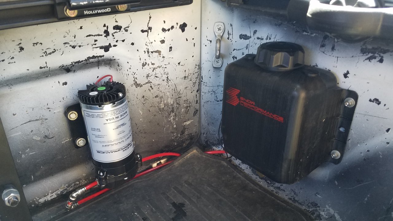

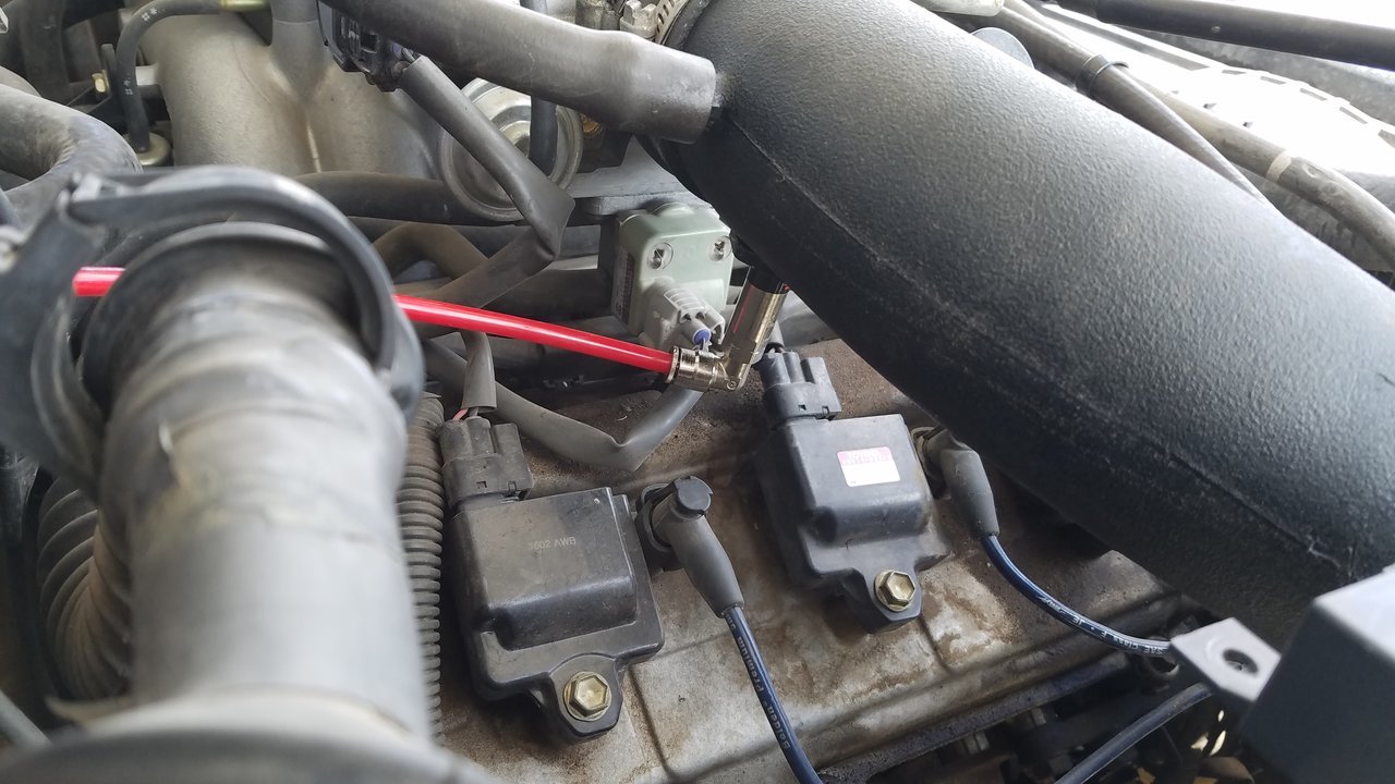

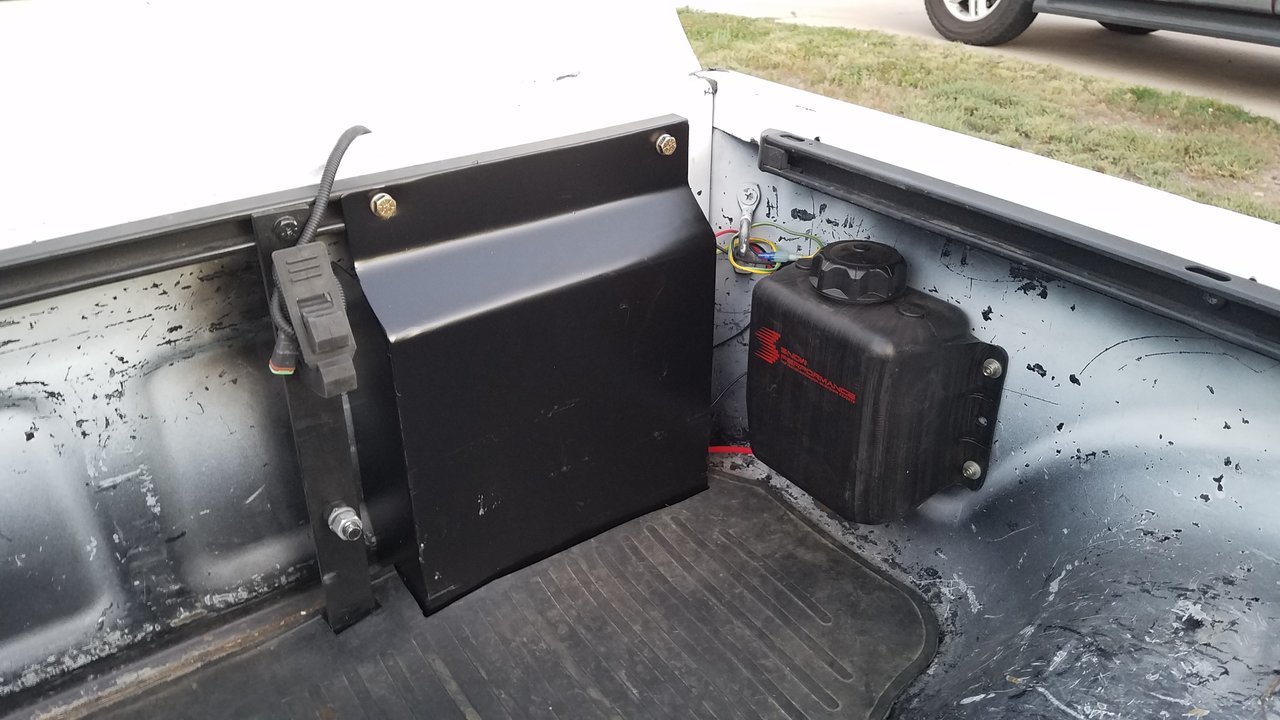

    Built a shield for my methanol injection pump and solenoid valve.

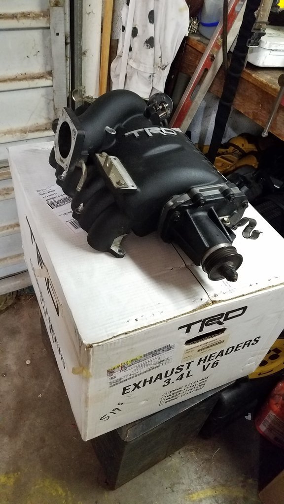

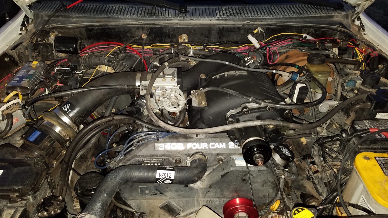

    Changed my water pump, thermostat, belts, hoses, spark plugs, injectors, valve cover gaskets and timing belt. And I finally put my supercharger on.

    Making boost!

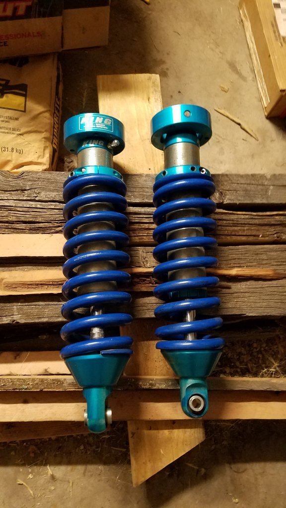

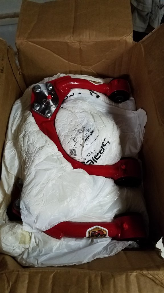

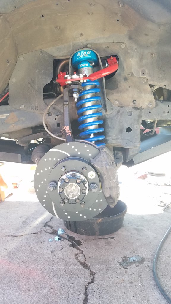

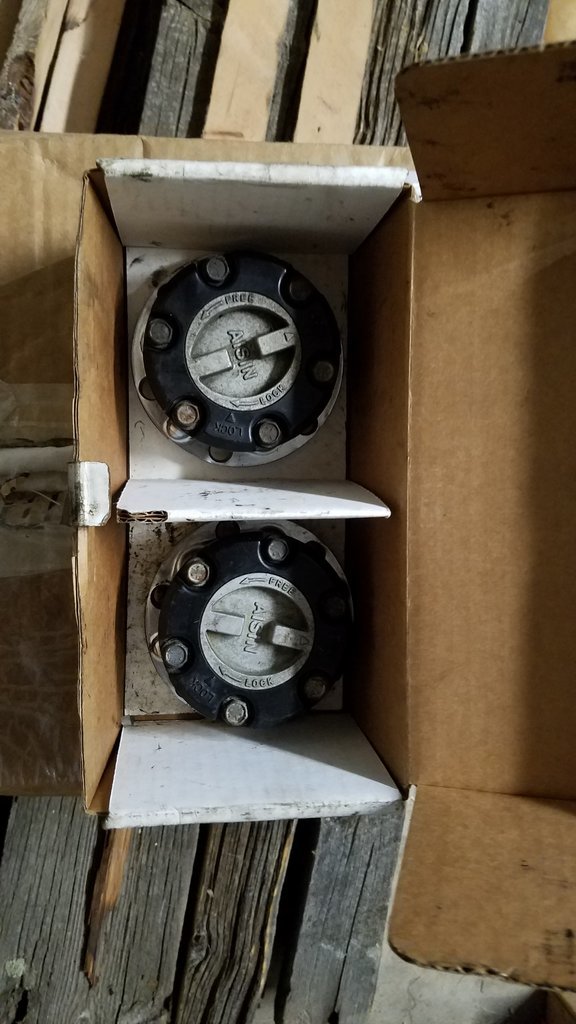

    Just a couple of upgrades today.

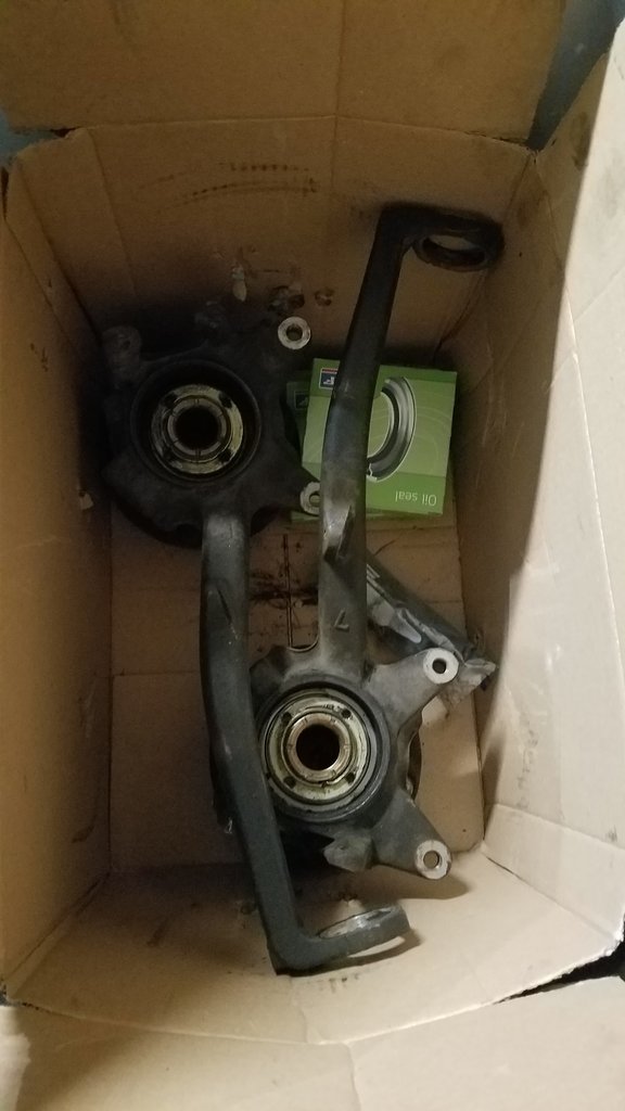

    Installed my King shocks, JBA upper control arms, EBC yellow brake upgrade and converted the front to manual hubs. Just need to fix the inner shaft.
    Now it's leveled.

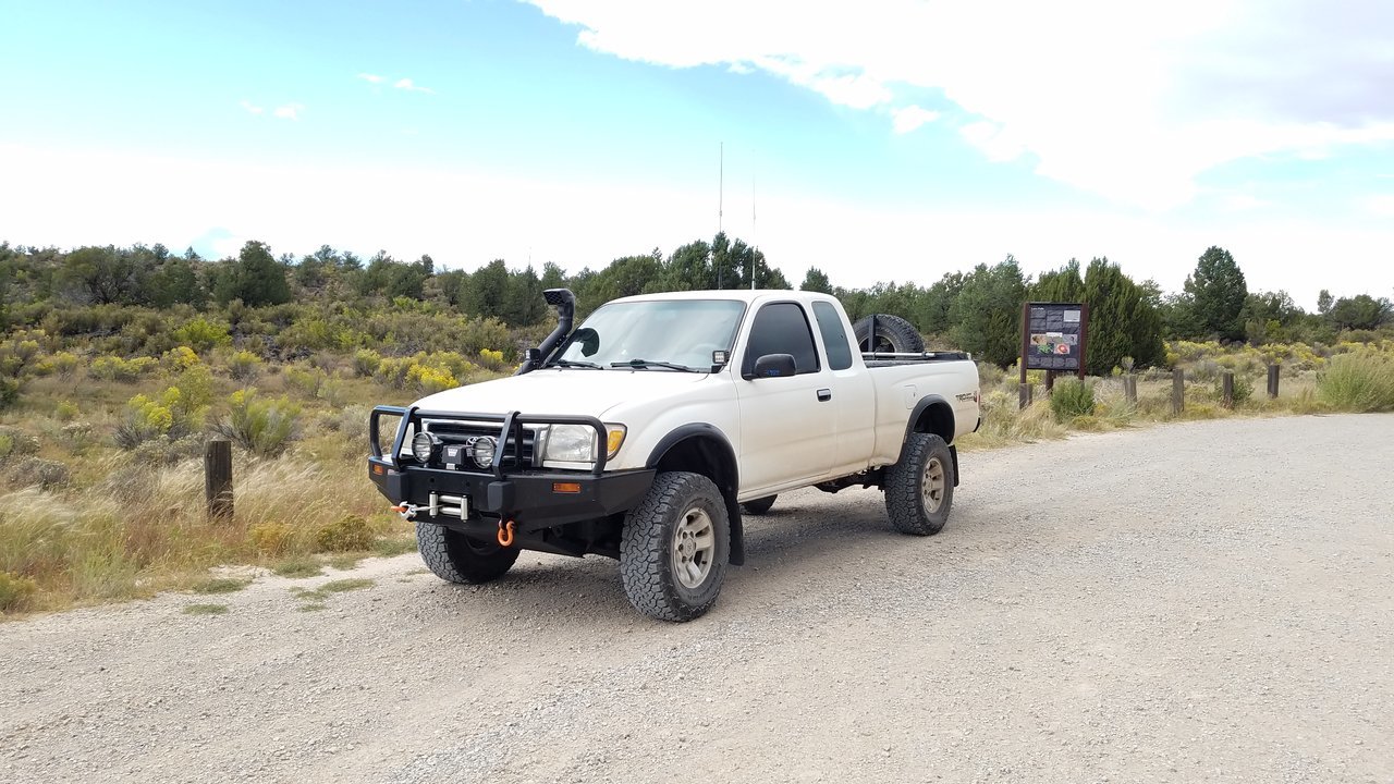

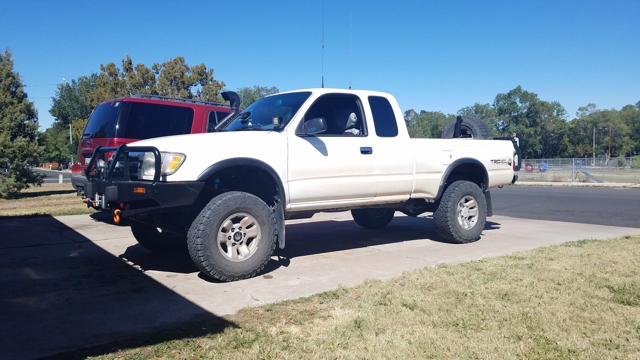

    Took my favorite shortcut home today...
    Why a snorkel?
    Installing a snorkel has more Benefits than just fording deep water.
    The stock intake of a 1st Gen Tacoma is located in the passenger wheel well and is susceptible to catching all of the debris that can be thrown up from the tires like dirt, rocks, etc.
    A Snorkel raises the intake to a higher level allowing much cleaner, cooler air to enter the air box and engine.
    Clean cool air = more power, less dirt build up and a happier truck.
    Oh, and you can drive through water if needed and it looks cool!
