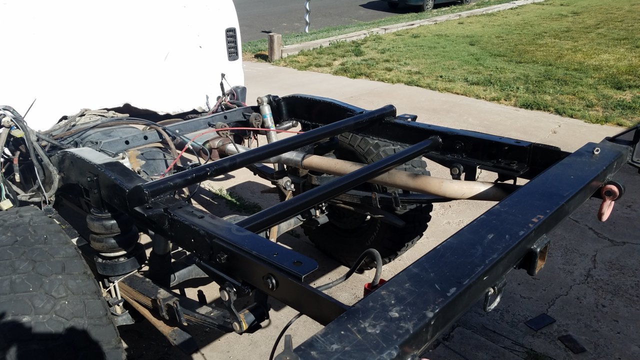

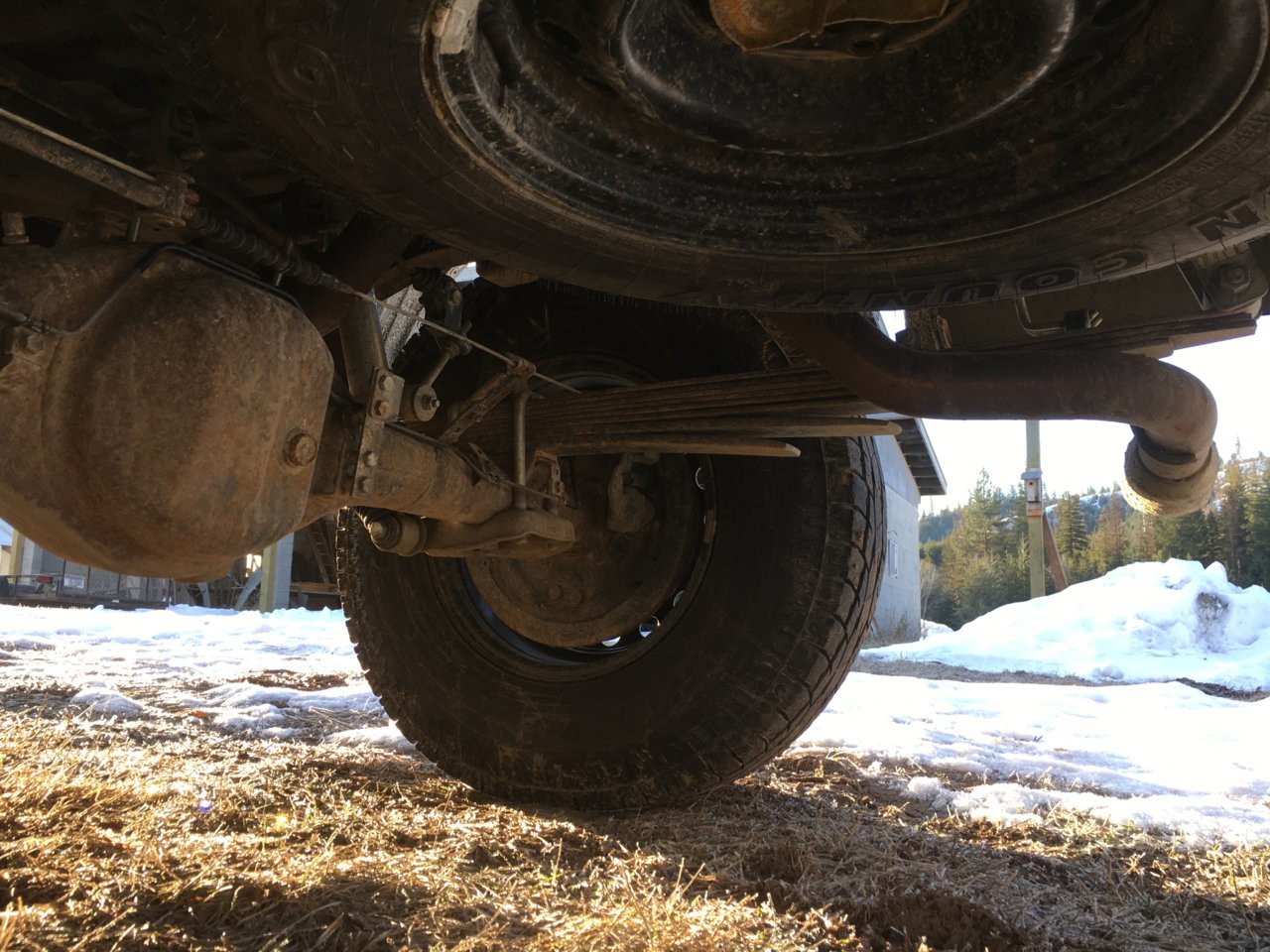

    Are those Timbrens?
    It looks like you only took out one of your OLs, or did you only have one to begin with? OME stuff seems to update from time to time perhaps.
    My truck has 2 overloads and the AAL:
    I think I’m going to pull the trigger on the Icon pack, did you use their U bolts or have to get longer ones?
    Thanks..

    Firestone https://www.etrailer.com/Vehicle-Suspension/Firestone/F2304.html
    My original OME leaf packs had two overload leafs. I removed them both and installed the factory overload leaf in their place.

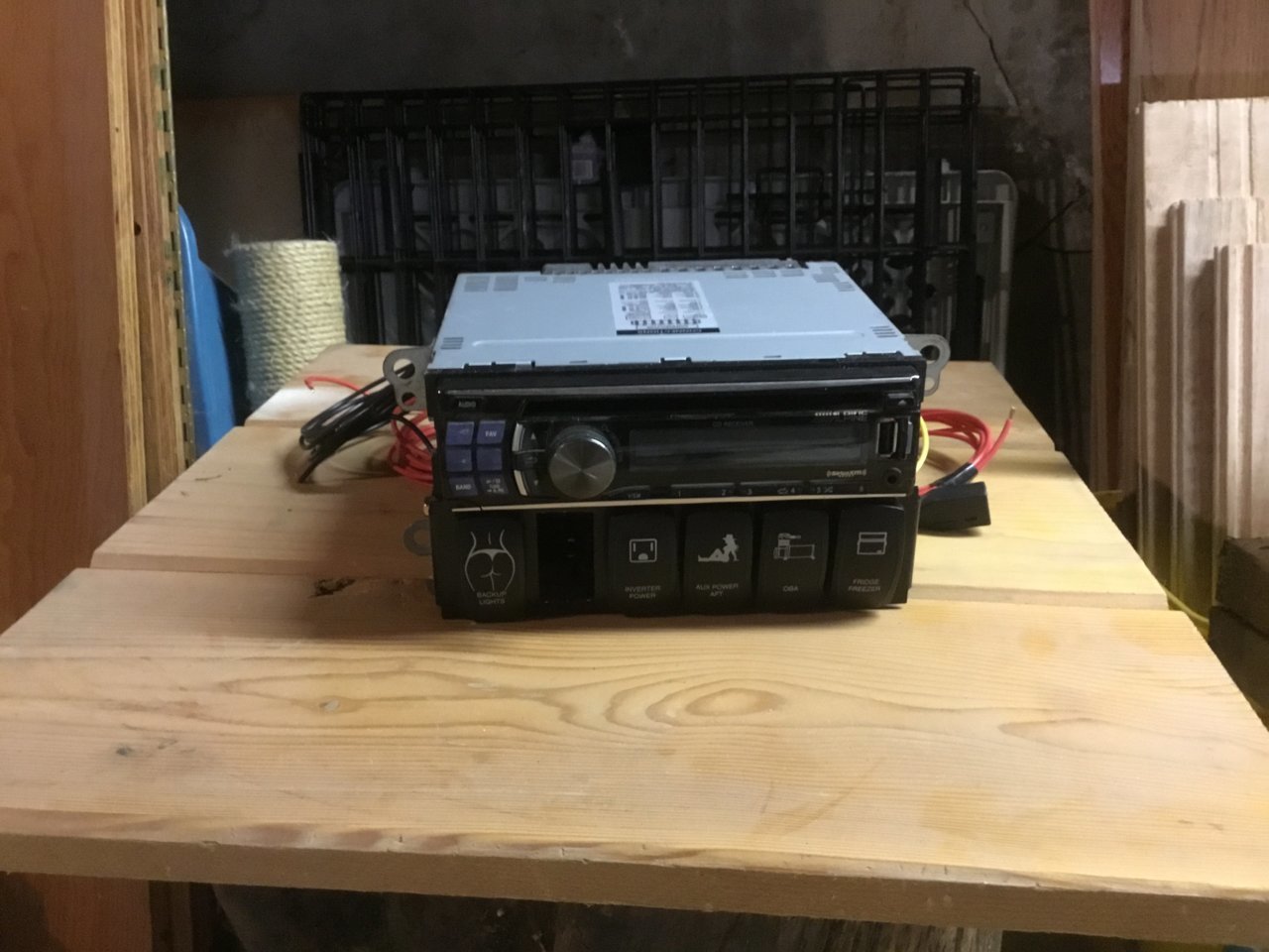

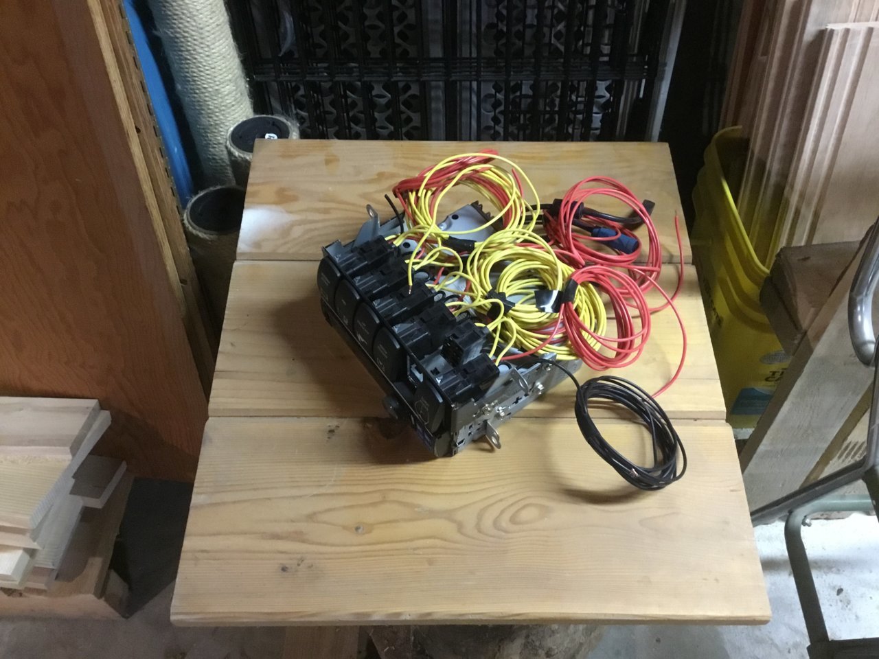

    I’m neck deep in re installing the stereo and new Paranoid fab switch plate, may even get some of the stuff hooked up:CDB1DBDA-5FC4-4005-8A75-3329725BB486.jpg
    I went ahead and installed 6 switches below the stereo:
    and 2 in the clock void. Don’t have that many loads yet but some day....
