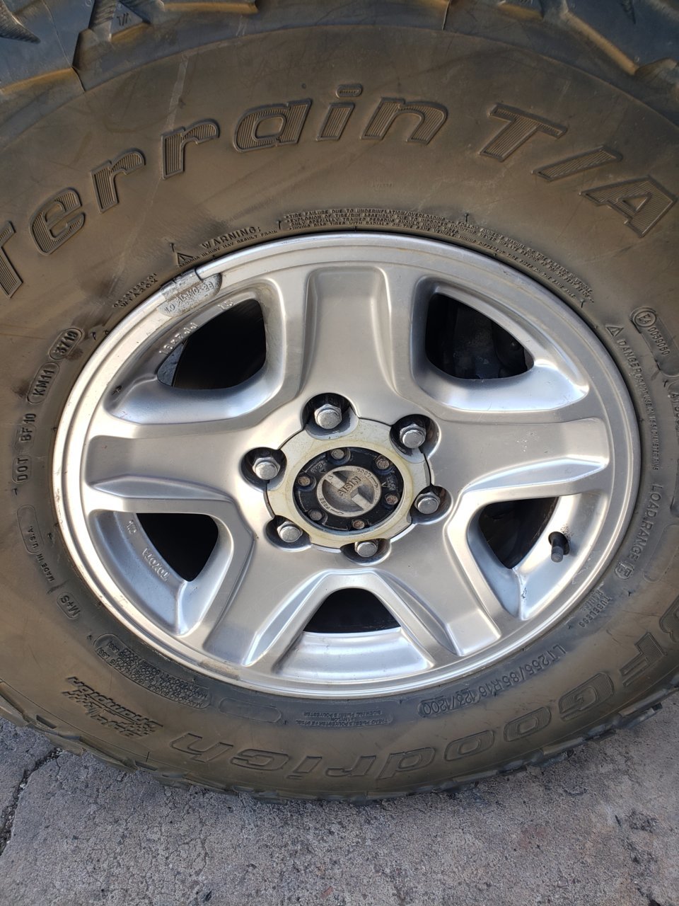

    Modified a couple center caps for my manual hubs.

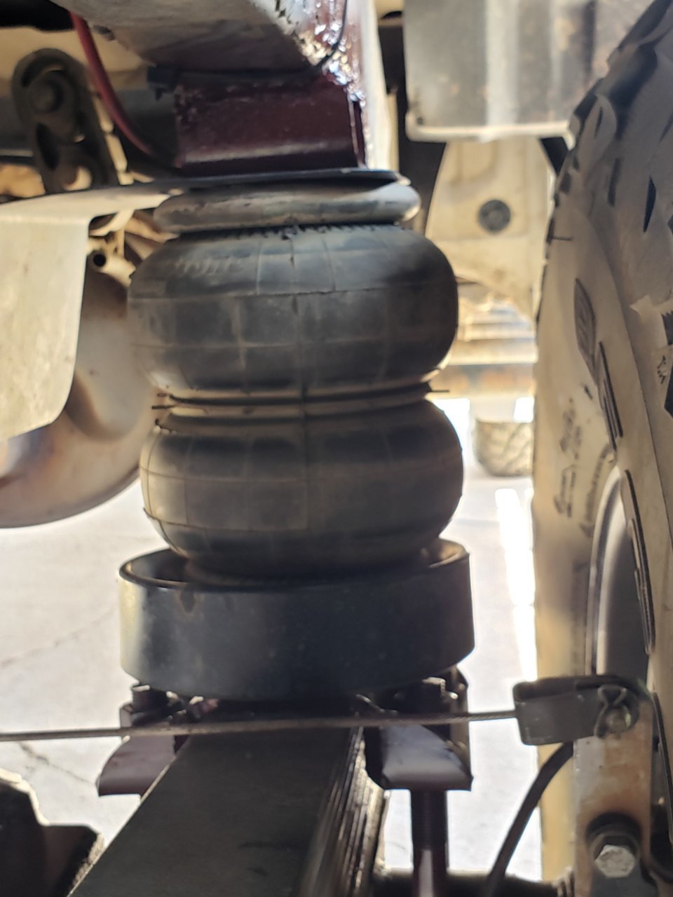

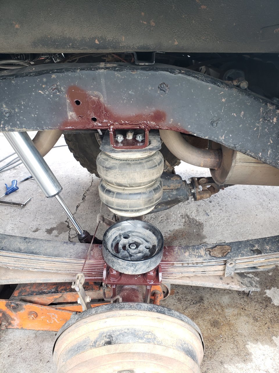

    Redid my airbag mounts and cradle. Now they are centered on the axle and there is more room before they make contact.
    Suspension extended.
    Suspension sitting at ride height.

    I really like how you centered it. Do your packs hold up your weight before the bags make contact? Or are the bags almost always holding it up?

    Phessor
    Phessor [OP] Well-Known Member
    Feb 15, 2014
    #123156
    3,575
    Bob
    1998 TRD XTra Cab
    Stuff
    With no weight they are not even touching the cradles. I should be able to get a full load and have the airbags to keep from squatting.

    I assume the second pic is the no weight pic?

    Correct, no gear weight, just the rack, basket, tools and bumper weight.
    And the bags have the recommended 5 psig in them for no extra weight.

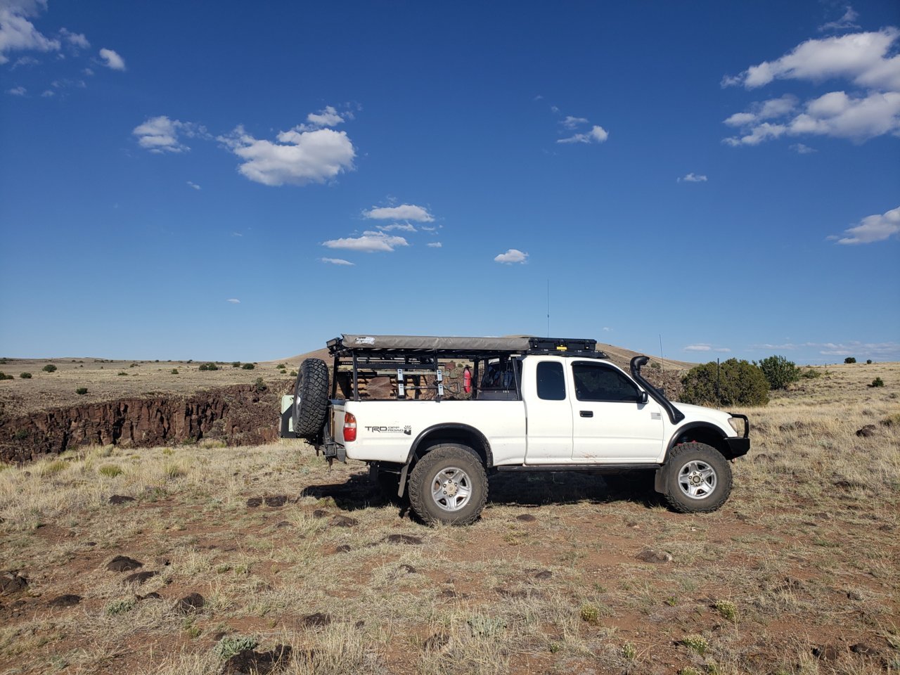

    Did section 5 of the New Mexico BDR today with my awesome wifey.

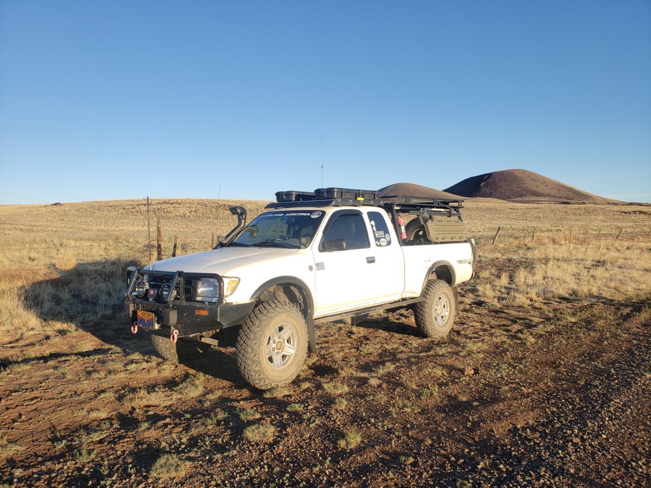

    More exploring...
    Took a detour home this morning.
