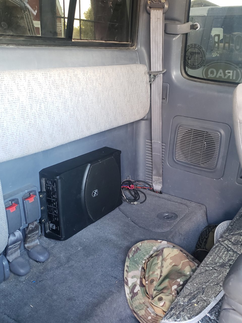

    I had my powered sub mounted under the drivers seat, but the new power seats didn't have the room. So I needed to move it.
    At first I was going to mount it under the passenger seat, but then I realized my kids are growing up and I can't fit two of them back there.
    So I removed the bottom seat cushion and mounted my sub to the back of the cab.
    My SureCall cell booster transceiver will mount to the right of the sub.

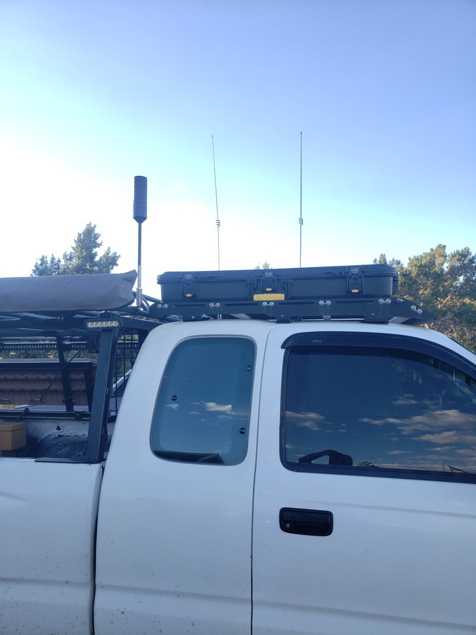

    I also mounted an antenna for a future cell booster install happening soon.

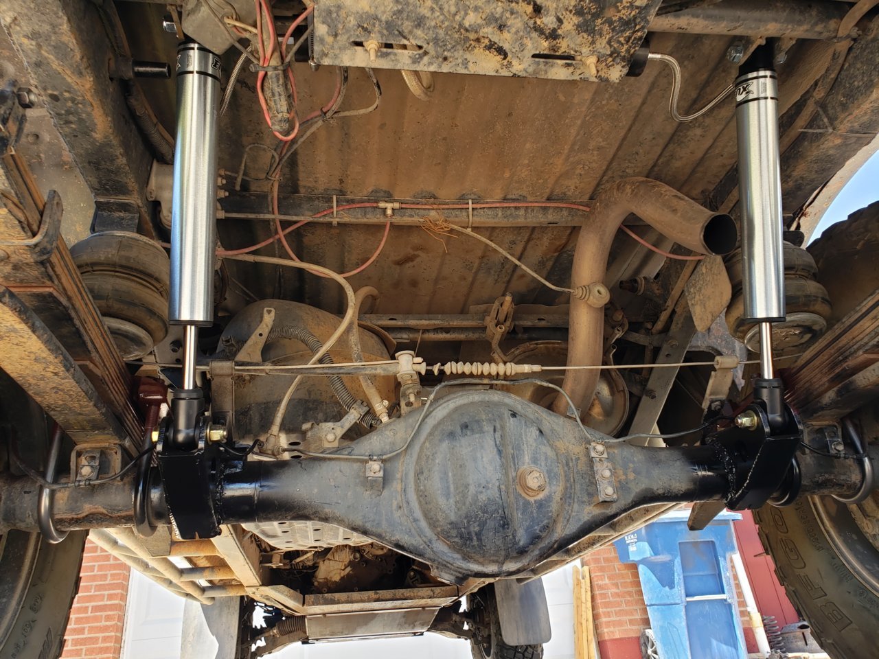

    Well, looks like I get to cut the bottom brackets off and move them down. I climbed under the truck to get a measurement at ride height and unloaded. I am at 2.5" of shaft showing and I can see where my rubber bumpers on the shocks have made contact with the bottom of the shock body.
    Also, I made a rather aggressive quick steering and braking maneuver to avoid an object in the road, with all of that up travel my ass end lifted WAY up in the air. Had a little pucker moment!
    So I need more compression travel and less extended travel. I am not looking forward to cutting off the brackets and welding new ones back on.

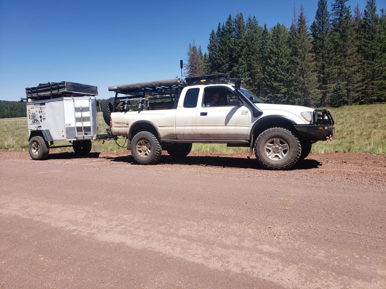

    Out exploring...

    I'm in the same boat. I'd like to see if I can stuff in slightly longer shocks though when I do. Only problem is ADS only goes from 10 - 12 and who knows if its worth it since the pack only cycles 10".

    Well that wasn't fun! I hope that this helps with the compression. I know I lost a lot of extension and up travel.

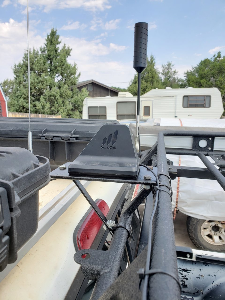

    So I picked up a SureCall mobile phone booster a while back. It does increase a weak cell tower signal. My plan was to have it available to myself and my wife, so I picked up a WeBoost antenna that I mounted to my rack in hopes that it would work with the SureCall booster. Short answer, no.
    So I made a mount for the magnetic SureCall antenna today.
