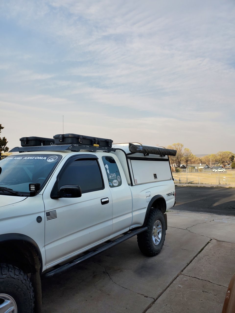

    ARE DCU topper? NICE!
    That looks pretty sweet on your rig! Looking good for certain.
    Those are sweet, have one on my full-size truck128118EE-B4AA-43C0-8734-AF45FEB860E1.jpg
    In retrospect I should have gone taller, but it is pretty sweet with lots of headroom and you can sit upright in it, access is great.

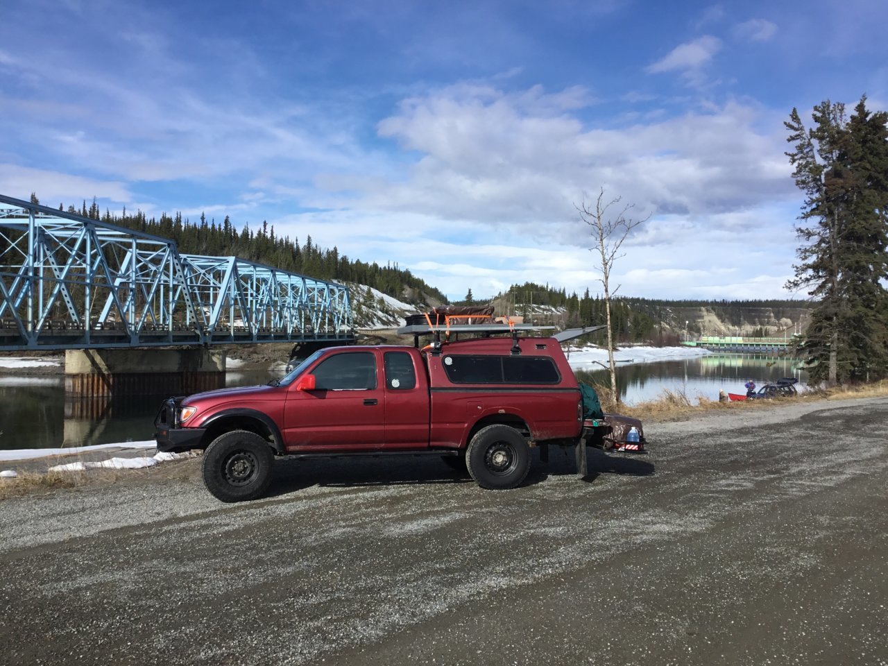

    Oh and 1 obligatory AlCan shot outside of Whitehorse- CV19 quarantine stuff- waiting for the Purolator courier office to open so I can drop off my CV19 test and get my self towards the border tomorrow:

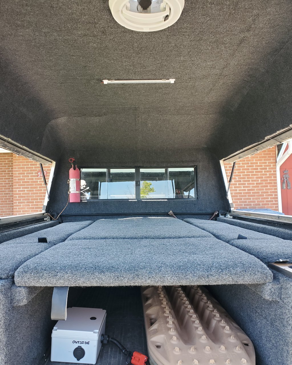

    Last outing before installing front sliding window and finishing the interior carpeting.

    You install the front slider? How hard was that? I wish mine had that feature?

    If you have the 12" x 40" framed in section up front it is pretty easy. I ordered my window through Tom's Camperland for $120.00
    Just cut out the front piece of aluminum, deburr and clean the surface and then screw it in. It came with butyl tape on it. All I had to do was change the locking clips, they were on the wrong side.
    I just need to get some kind of seal between the cab and shell.

    Motorcycle tube?
    Do I see 2nd gen bed/tie down channels in there?
    Looking good, and cozy..
