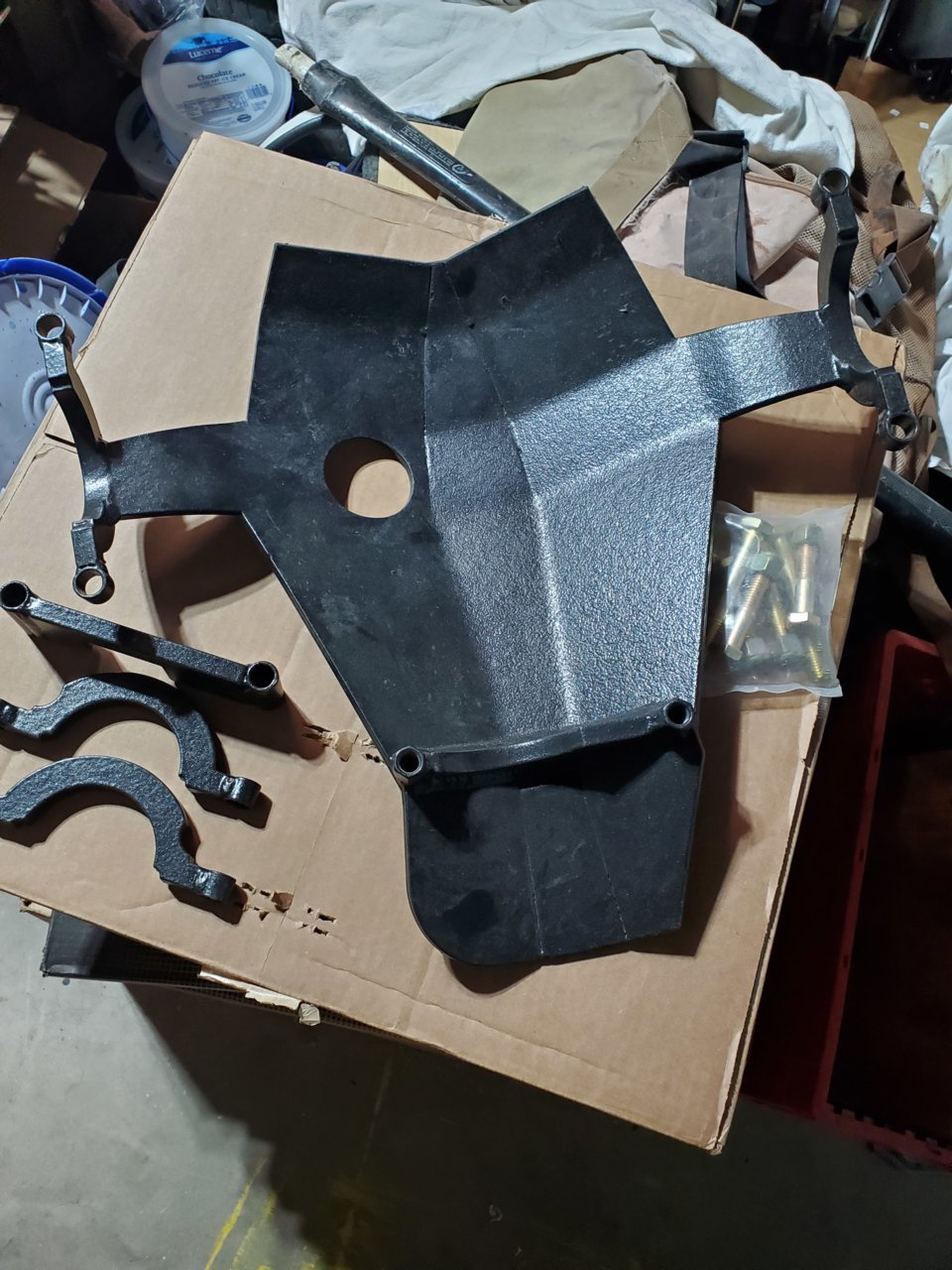

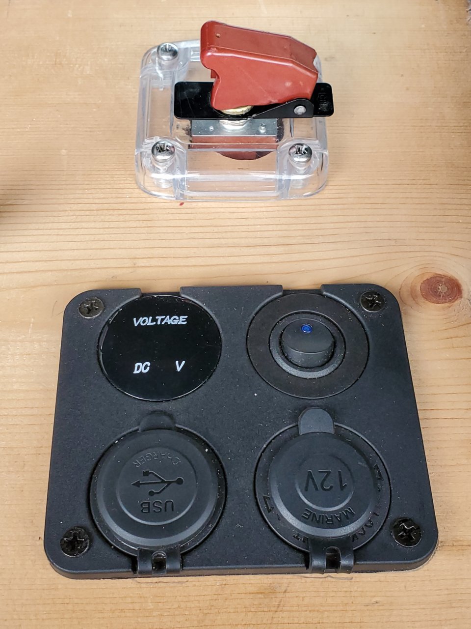

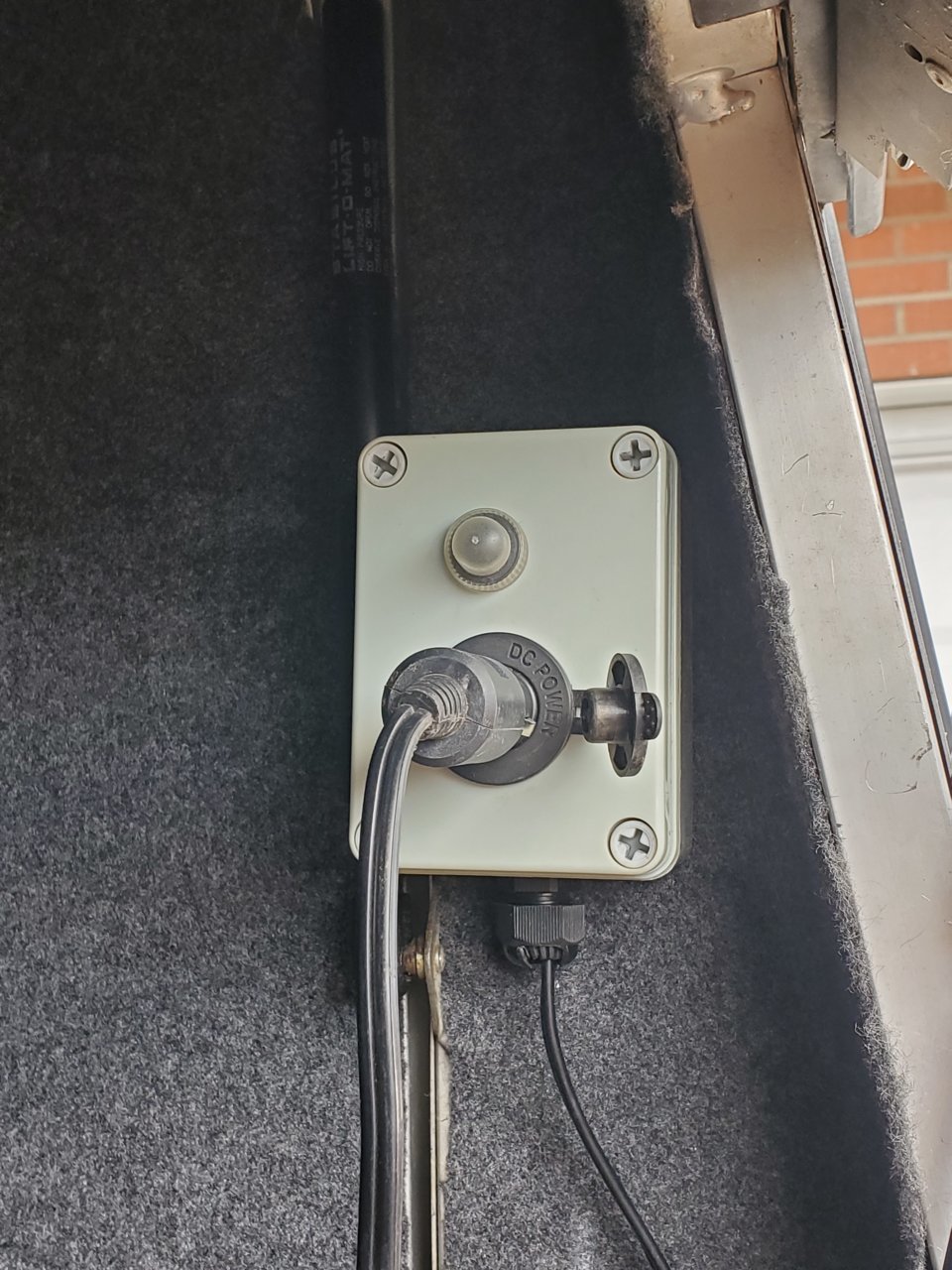

    One hole drilled and test fitted with Low Range elocker guard.
    I will remove it later and weld up the original drain plug hole.

    I also moved the Hella plug with a reset breaker for the refrigerator to the back of the shell. I figured it would be in the way of sleeping.
    I filled the old hole with a guarded switch for the interior lights.

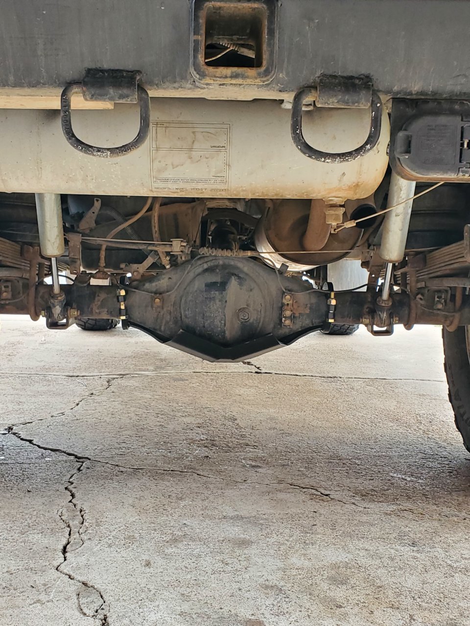

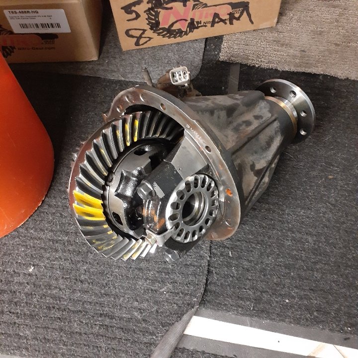

    The MadTaco had the rear differential rebuilt and received a new set of REM processed 4:88 gear set with new OEM bearings and a new flange.
    I'm happy with the results!

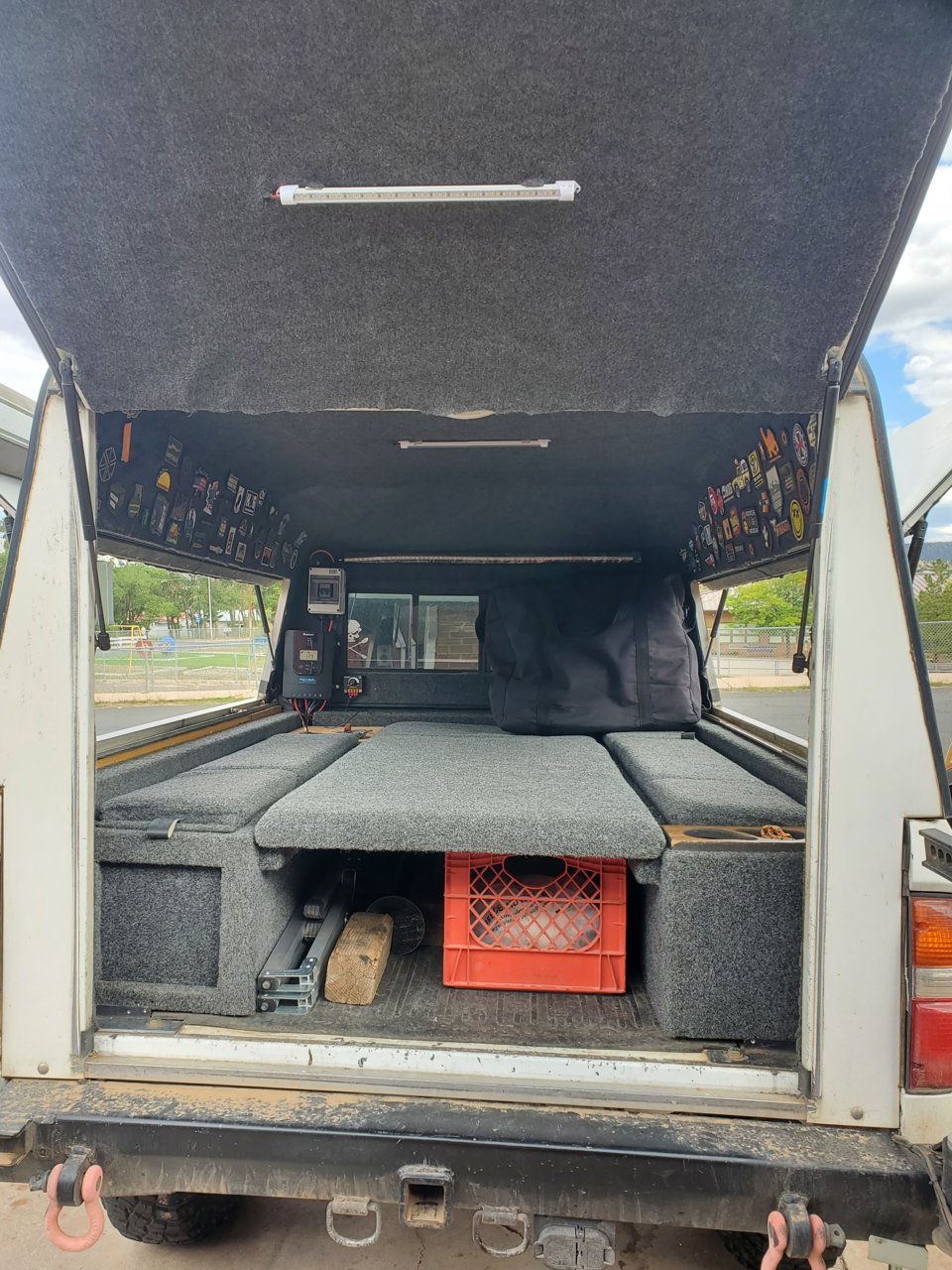

    I picked this bed kit up used and I've always struggled with trying to get it to work just right.
    So today I rebuilt it, tightened it all up, added some spacers on one side to make it fit nice and tight, and now it's level and sturdy.
    Ready to go camping.
