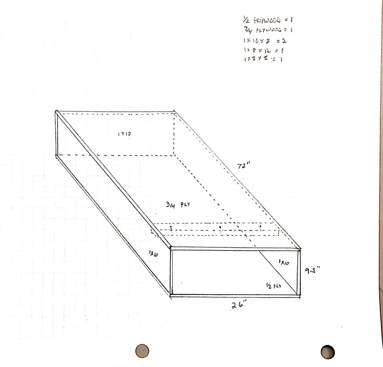

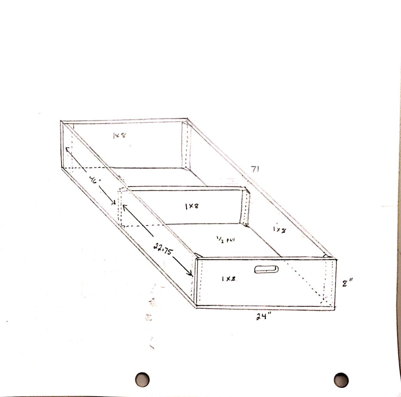

    I have been kicking around the idea of building a pull out drawer box for my bed. I t would slide in between the current bed kit giving me a 25" x 8" x 70" drawer for more storage.
    So I drew up some plans based off my measurements and needs.

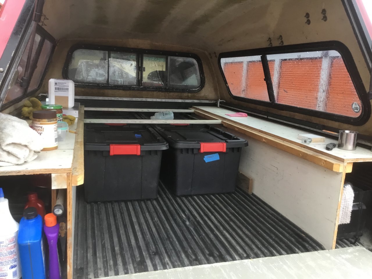

    On the fence about drawers, I use 15-17 gallon Sterilite industrial totes, 2 each side, usually with an old strap from a busted ratchet strap tied around either the handle or with these there are slots that one could use maybe- haven’t really set up straps for this generation of totes yet.
    A drawer would be great but a big one might be a PITA to remove for full bed use, which will always be needed with my rig.
    I am also pondering sectional top for the platform as a dometic is in the future plan.

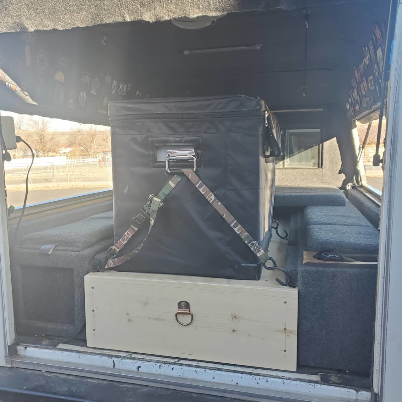

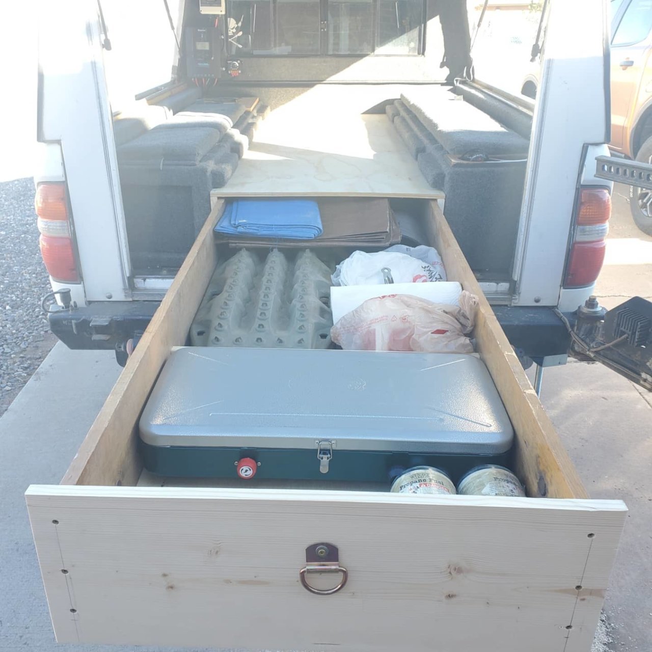

    I have been putting this off for quite some time, but I finally bit the bullet and spent some money today. It's a simple drawer system that can be removed pretty easily, but gives me a lot more storage than what I had. I still have to do a handle on it so the temporary one will get replaced at a later date.

    Nice, looks good, simple is always the best.
    Here is my coyote ugly setup. Due for some more reconfiguration, rip down the cleats, add another unistrut spreader and move the middle one aft a little. Hoping to set the dometic on the right side and split the upper platform into a two piece as well as an option for the solid piece(not pictured) it’ll be snug for sleeping but I can work with it for another year or so. Bonus-I can dismantle it all and have an empty bed in 10-20 minutes depending on how much road trip cargo is on board.

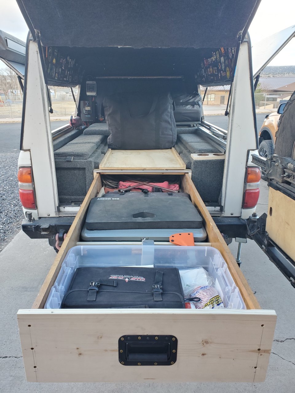

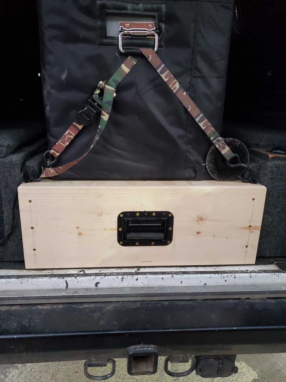

    Got the new handle installed in my drawer.

    Looks good, sure you aren’t a wood butcher?

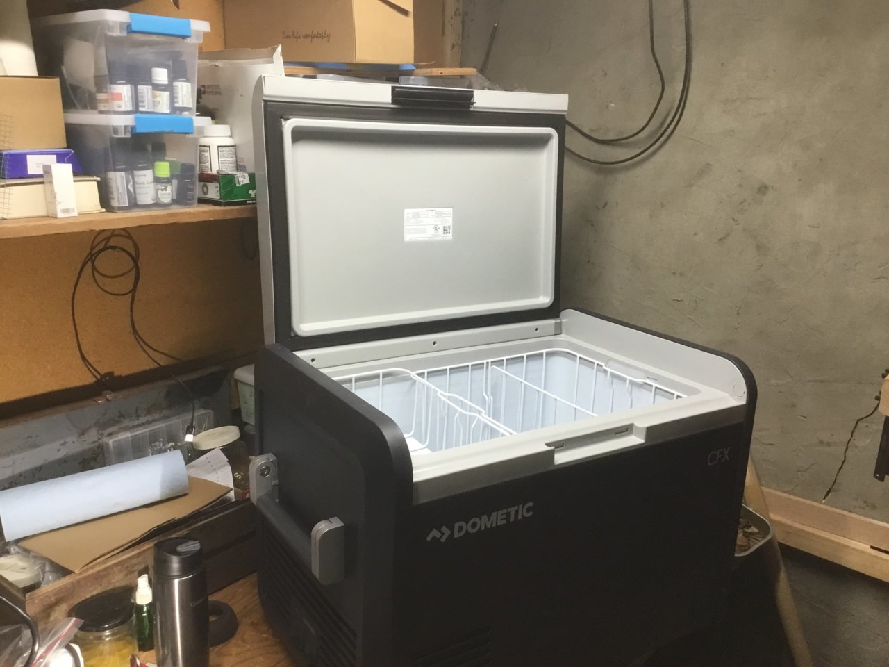

    Glad I didn’t go for the 75L DZ unit. It seems enormous but it will be doing double duty, in the cabin and on road trips until I get the all of the AE system upgraded at the cabin.
    Takes up half of the workbench:1CDFDD80-8320-480E-986F-7B1789B91AFA.jpg
    Definitely going to be creative living around it in the back of the Tacoma.

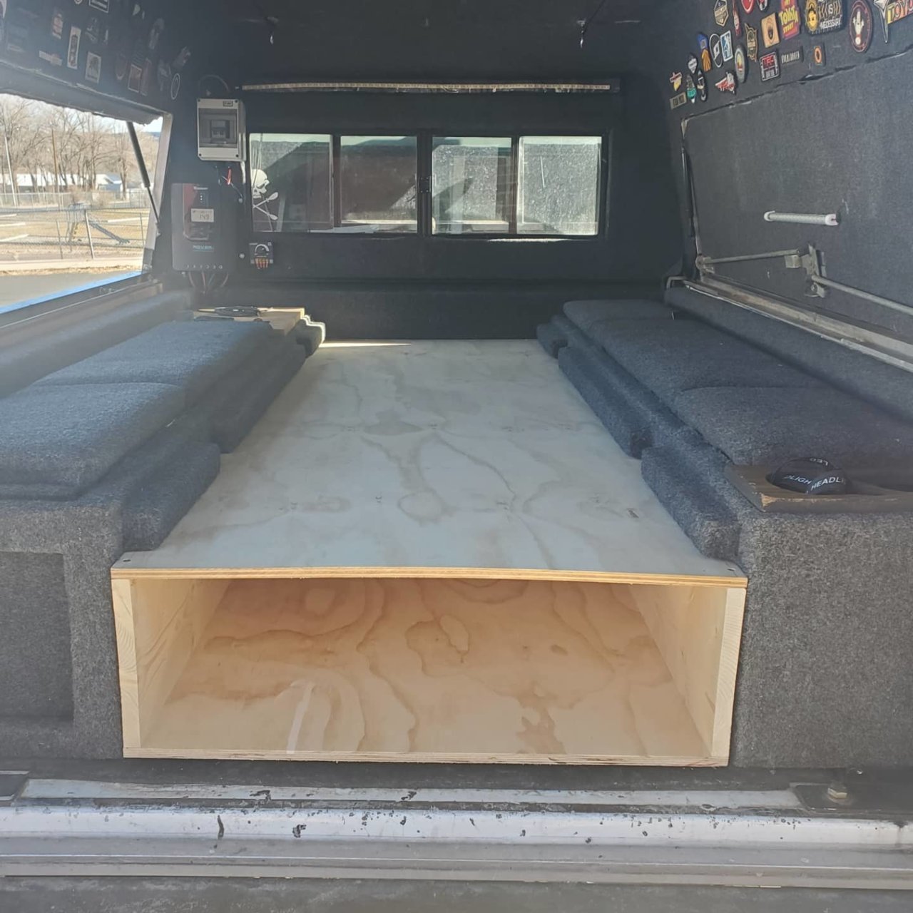

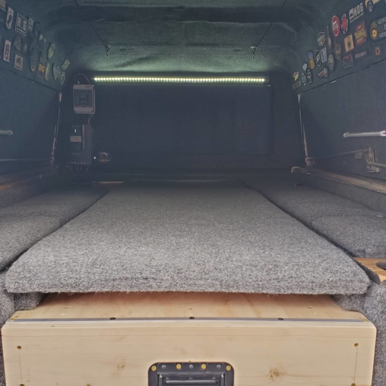

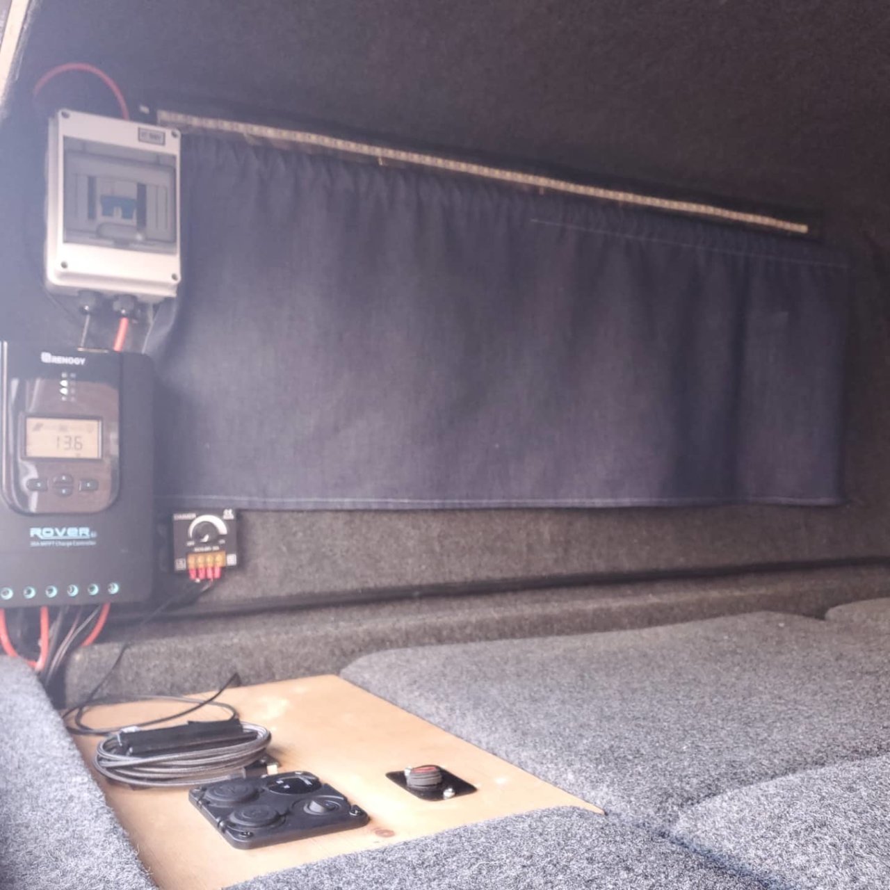

    Worked a little on my drawer for my truck bed, added another divider and organized it. Also had to rebuild the cup holder on the right rear corner as the other one broke.
    I added a curtain to the front of my camper shell. Sewing is not one of my gifts.
