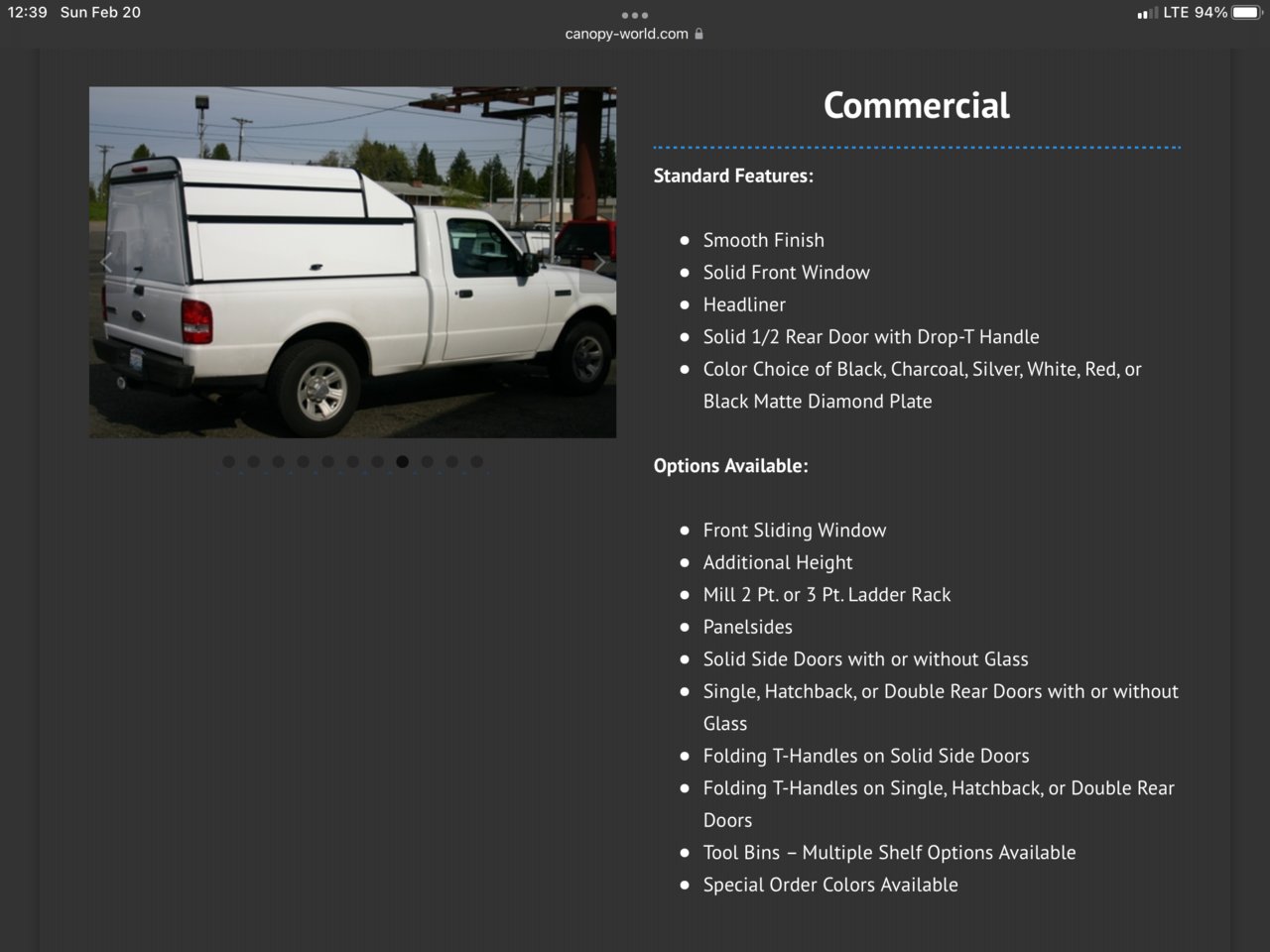

    Likely looking towards a RoyEl topper I like the look and available options on their commercial topper. Really wanted a Vagabond but they are out of my price range by a substantial margin given all the other stuff on my have to do list. Cabin improvements, shop construction and solar upgrades, along with the rest of the fleet -Roland( r/r engine), the white Buffalo (bed mount fuel tank, sliding rear window and dash replacement) along with Nina (84 C20- Torsten diff and work shell) and various other stuff.
    https://canopy-world.com/canopies/royel-canopies/

    I like my topper, the one you're looking at looks a little bit taller so that definitely gives you more head room.

    I do plan on going as tall as I can, the older I get the more I prefer more sitting up right room, and it will likely work out better being able to shift the Dometic over closer to the side, and not feel so cramped that way. I found out that one can order the ARE DCU toppers in 3 heights- cab height, +8” and I think another 8-10” above that, and the cost is still the same, no extra charge- I wish I would have known that when I bought one for my diesel, but even the mid height option helps a lot in the full size truck. I also really need to do a deep dive into their construction specs, it would be nice to have a sturdy frame and roof rack on the topper, I have to say that the racks I saw on the ARE didn’t instill much confidence in the longevity of the available rack offerings they had after seeing how light the tubing the frame was made out of. But weight is also a concern so I have to contact them and see what type of custom options they may have.

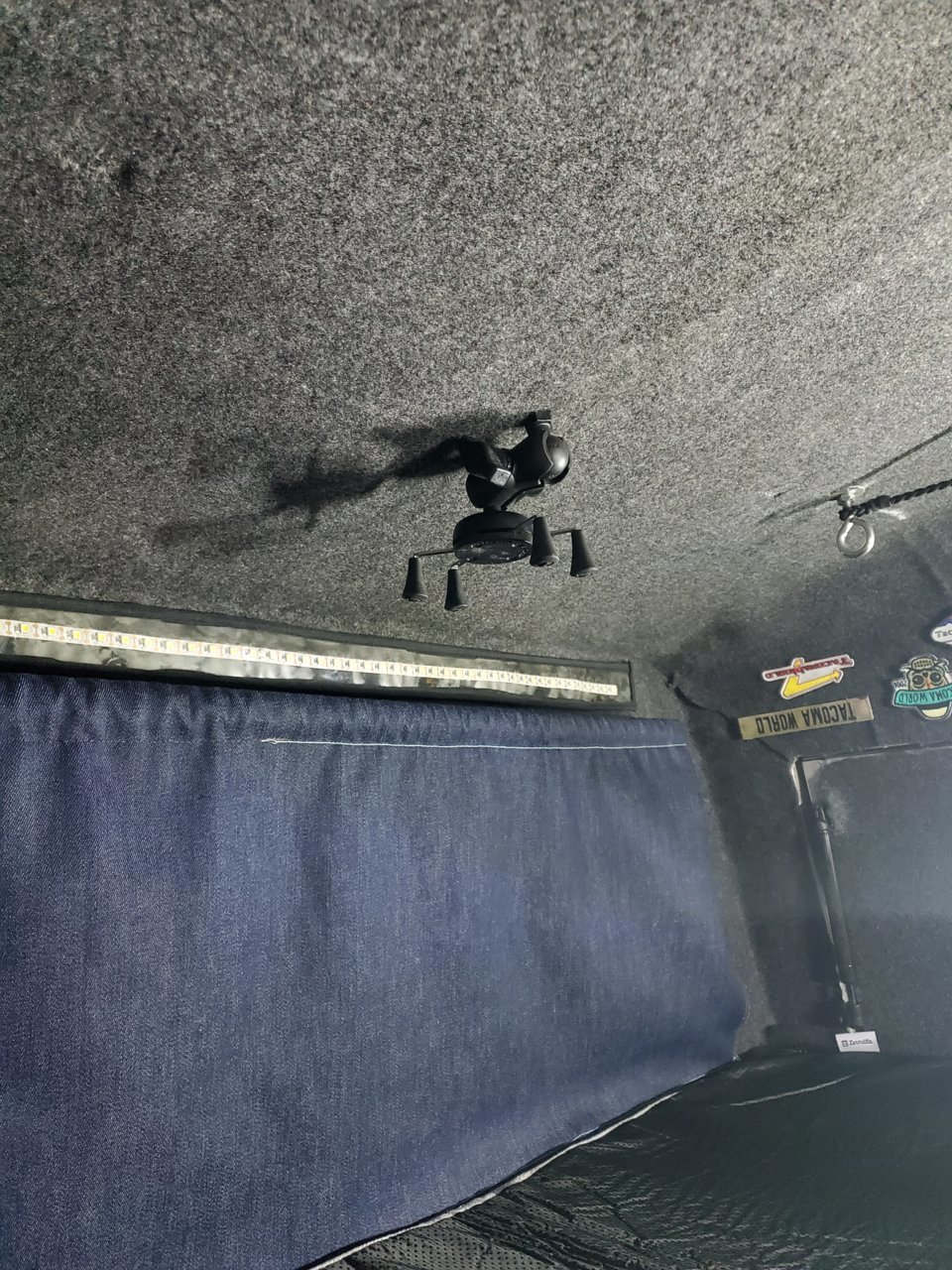

    Added my entertainment center mount.

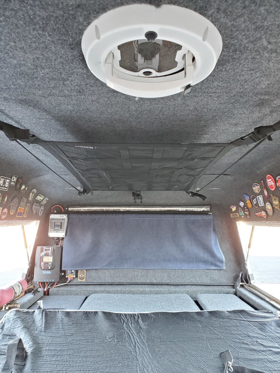

    Installed an overhead net for essentials while camping.
    It will also double as a clothes hamper so I don't have to dig for clothes in the mornings.

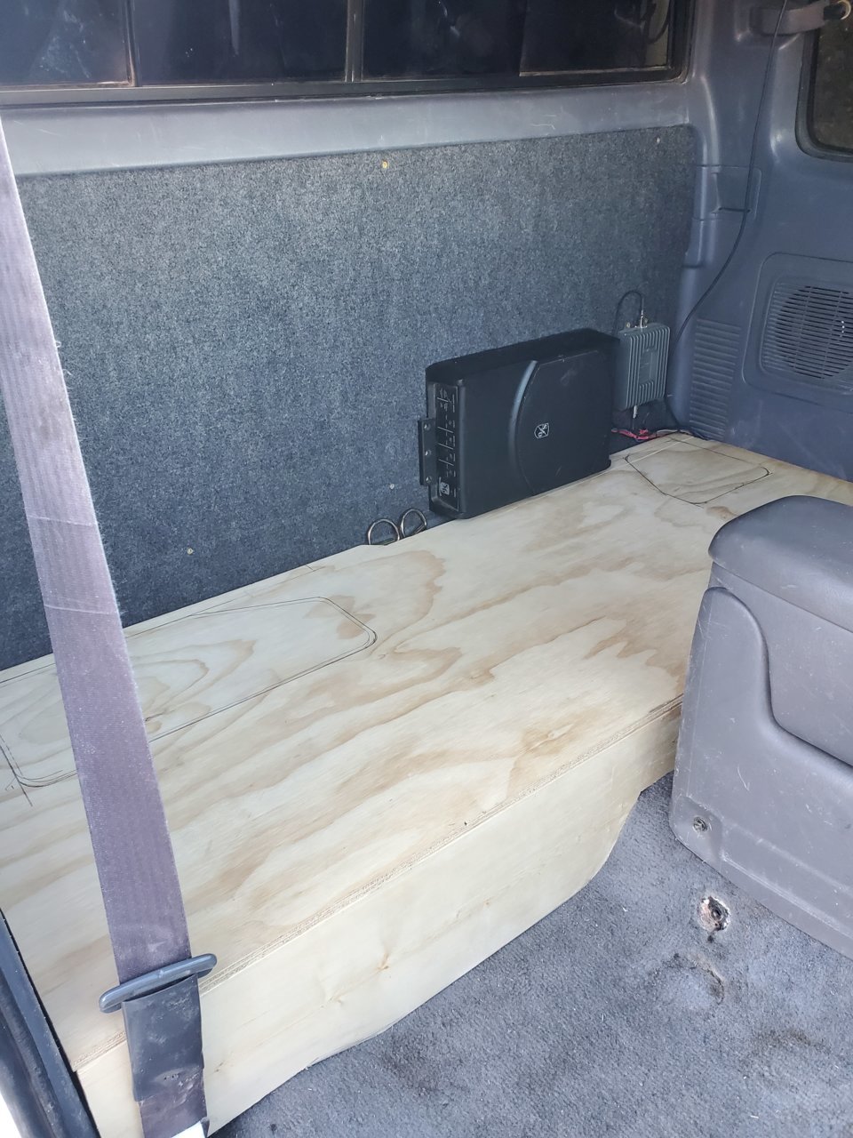

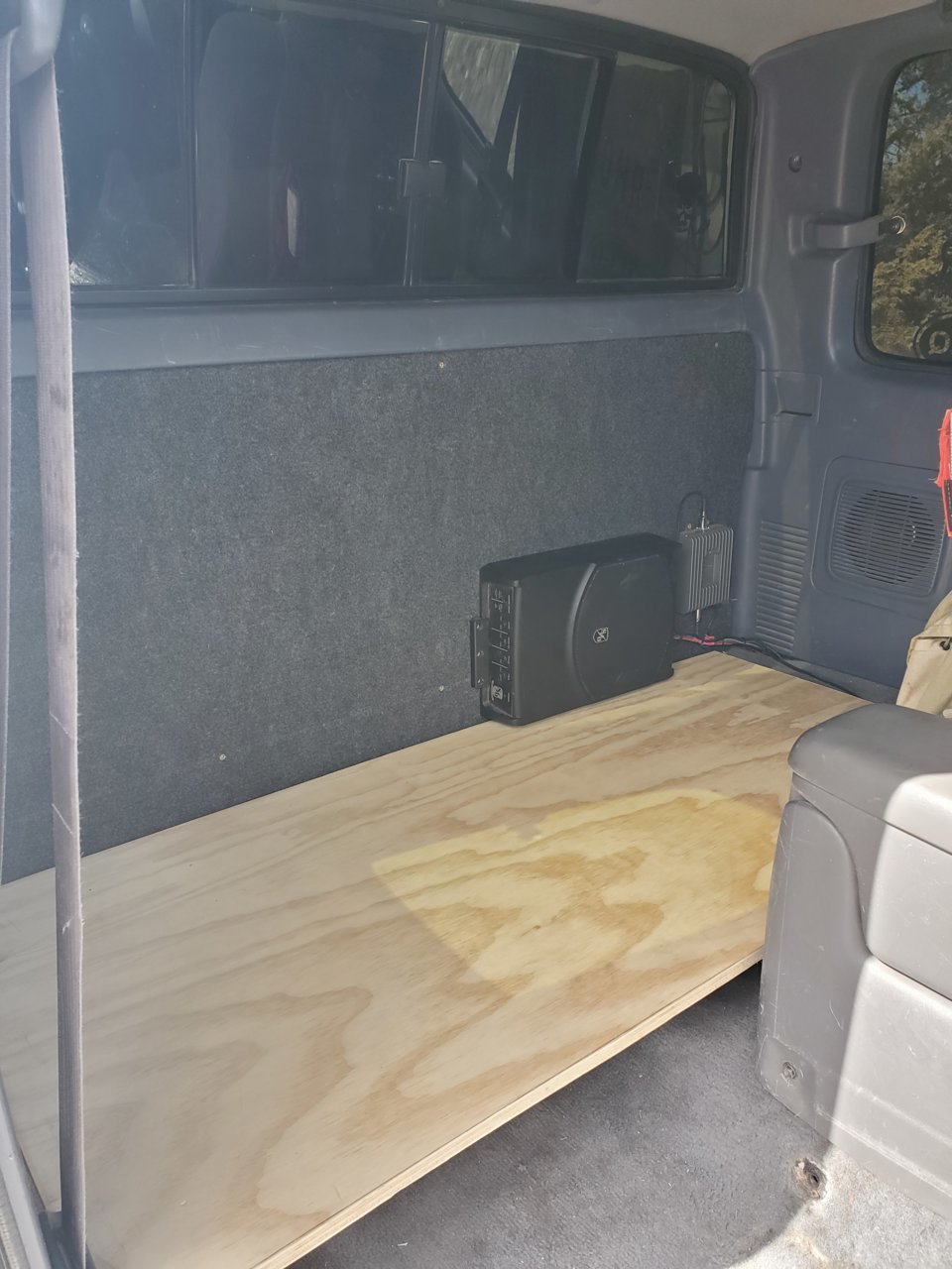

    I haven't used the back of my cab for passengers in a very long time. So the time has come to remove the back seats and seat belts so I can build a platform. I completed the back wall this morning, and now I'm starting to test fit the floor that will be the platform.

    I'm happy with how it turned out. No more clutter behind or under the seats.

    How hard was it to do all that, making me debate about doing something similar

    It actually wasn't to bad, a little time consuming but pretty straight forward.
    I used 3/8 inch AB plywood for the back panel and platform base. The front was a 1x8 piece of lumber that was the perfect height.
    I sprayed 3M adhesive and applied some speaker carpeting to the surfaces. I am going to spray paint the hatches with bed liner and then I should be done.
