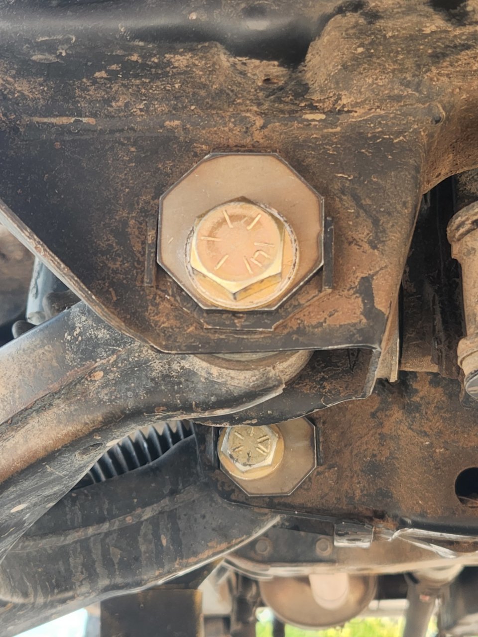

    Today I decided to install the octagon alignment cams I received from @ForestRunnerFrank99
    https://www.tacomaworld.com/threads/the-be-all-end-all-to-your-alignment.770995/
    It took about an hour and a half to complete the install, that included replacing the outer tie rod ends. I have an appointment for next week to get the front end aligned.

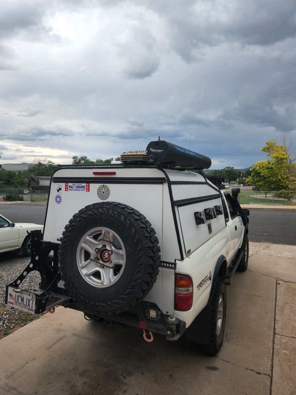

    I also finished my mounting system for my DCU topper, I have mounted the road shower and Maxtrax recovery boards on top.
    I plan to make a tube to hold my gas filler nozzles so they are not in the back with me.
    Just trying to get everything ready for next months adventure.

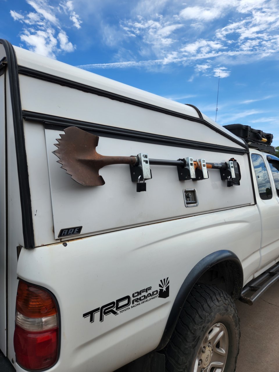

    Do you think whoever you take it to will know what to do with the octagons? Also what's that mounted to the side of the camper? Those three things that look like hinges
  8. Aug 24, 2022 at 6:17 AM
    #688
    Phessor
    Phessor [OP] Well-Known Member
    Feb 15, 2014
    #123156
    3,579
    Bob
    1998 TRD XTra Cab
    Stuff
    I stopped by the shop and talked to the tech. He knew about them before he even saw my truck. I told him if it's close enough to just do a toe adjustment.
    Those are my locking shovel and axe mounts. I was making more room, now I have to watch my head so I don't get cut.
    This wasn't one of my better ideas. .
