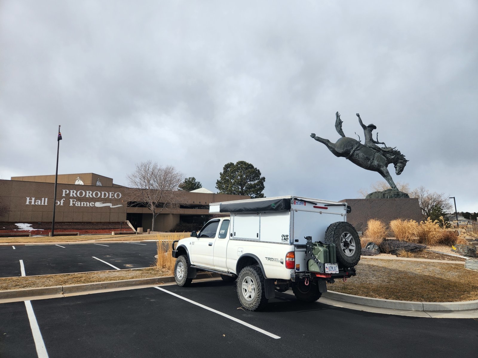

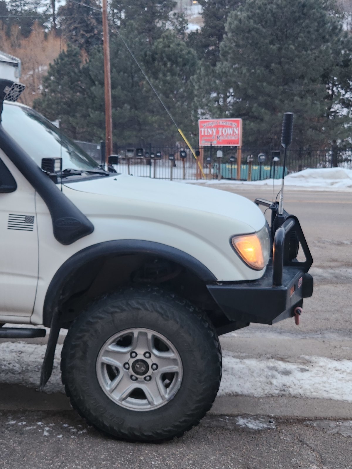

    A few local pictures...
    Cheyenne Mountain
    Pikes Peak
    Back roads...
    Looking down on Colorado Springs
    Pro Rodeo Hall of Fame Museum
    Tiny Town

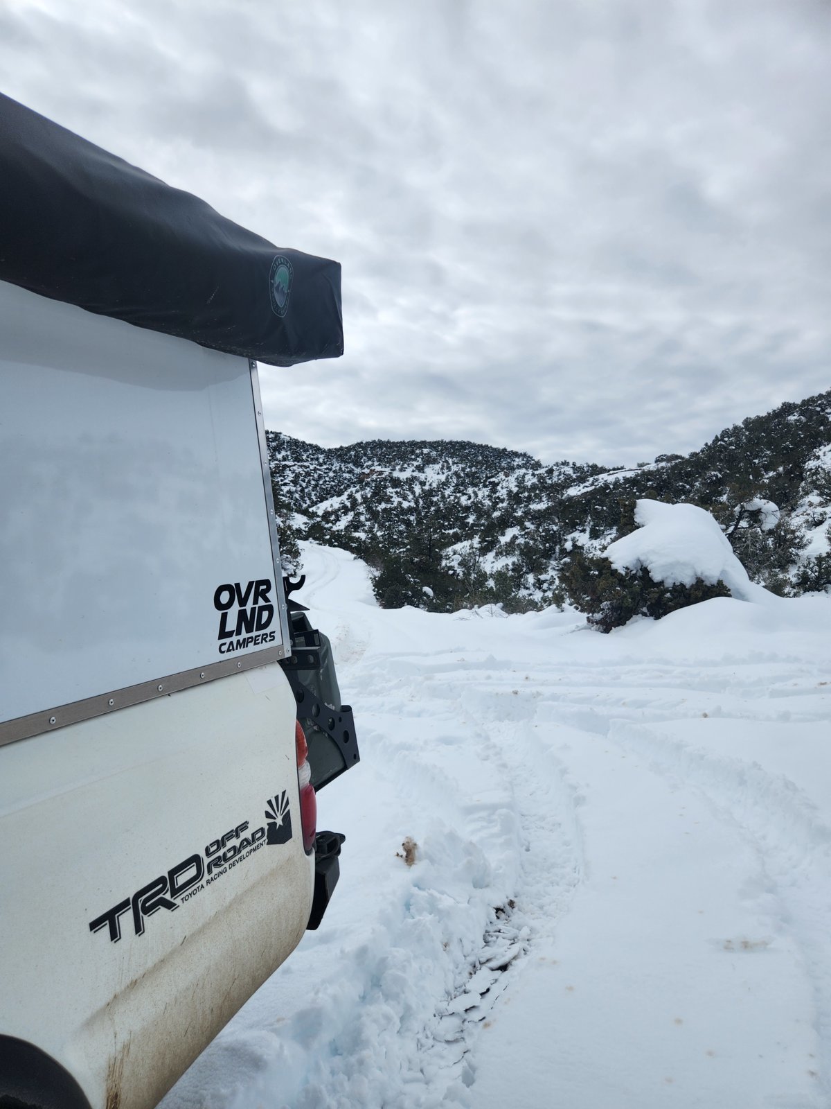

    20240316_152553.jpg 20240316_152804.jpg 20240316_153137.jpg 20240316_153734.jpg Went for a drive in the snow today.

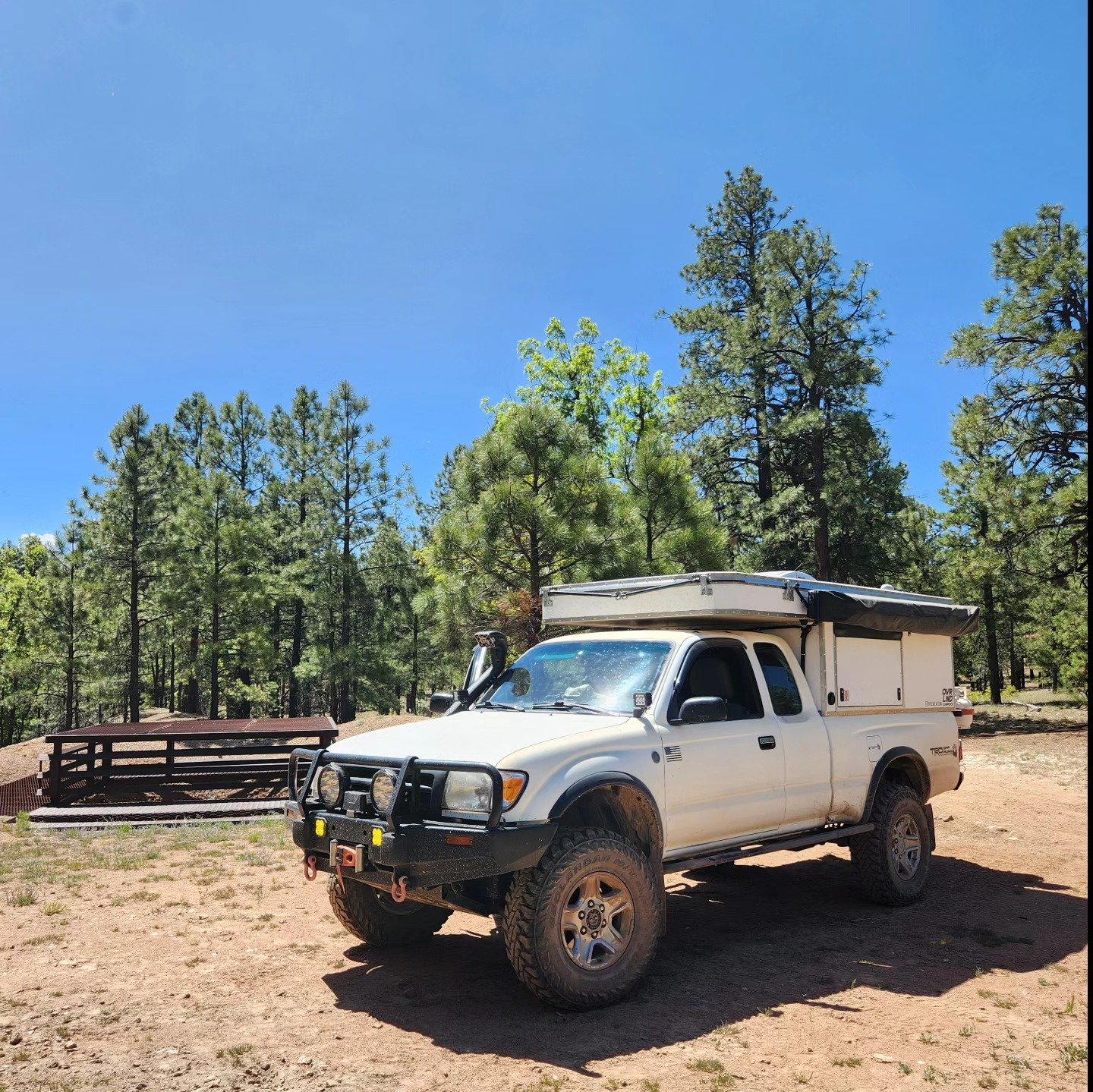

    Did a quick overnight camping trip up Phantom Canyon road.
    Arctic Taco, chrslefty, jubei and 3 others like this.

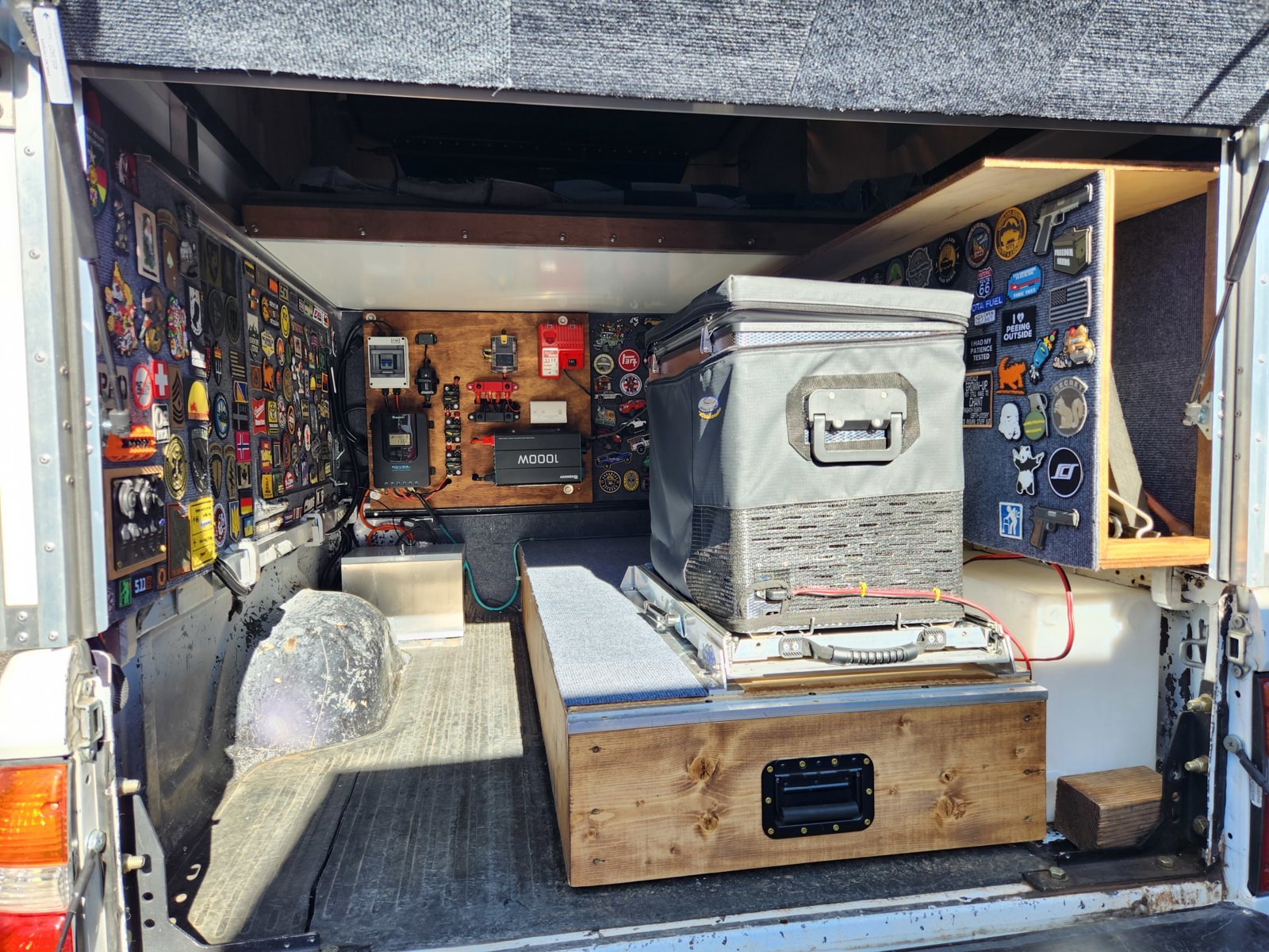

    Did a little work on my camper, insulated it, carpeted it, made a little cubby cabinet with countertop, placed my water tank, and plastered it with patches.
    I also added the switch panel in the rear. I still need to add inside and outside lights, then run the power.
    I still want to add a couple of shelves above the water tank and below the counter top.20240405_113203.jpg 20240405_113154.jpg 20240405_113148.jpg

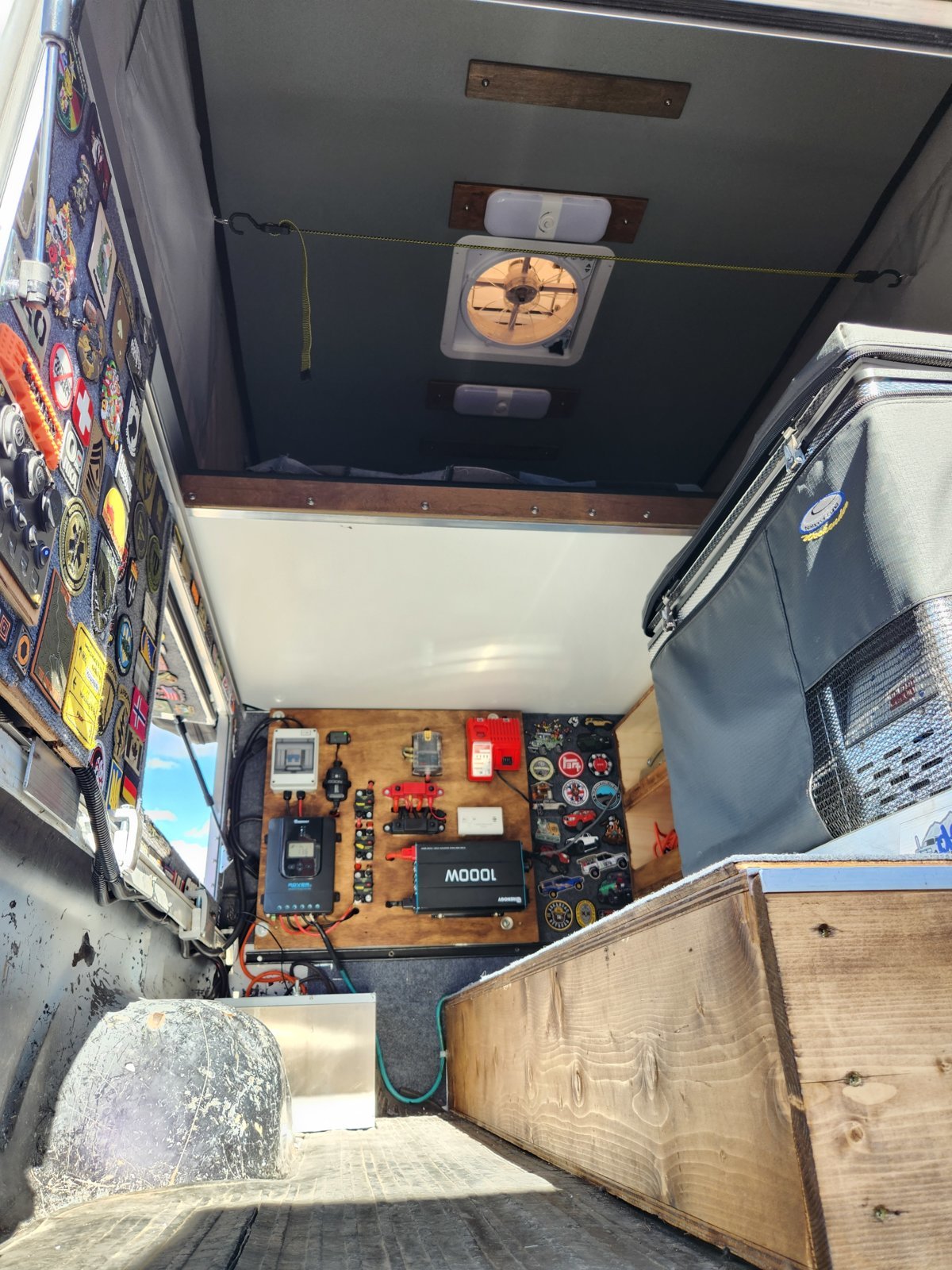

    A little more work on the camper today and last week.
    Installed my solar panel and wired it in.
    Installed my max-air fan and interior lights.
    Insulated the top.
    Stained the wood and finished the carpeting.
    Also got all my exterior lighting completed.

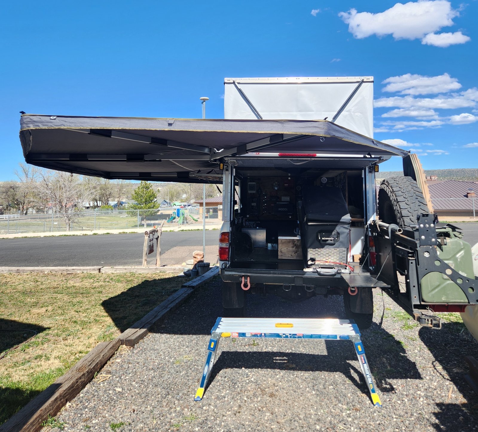

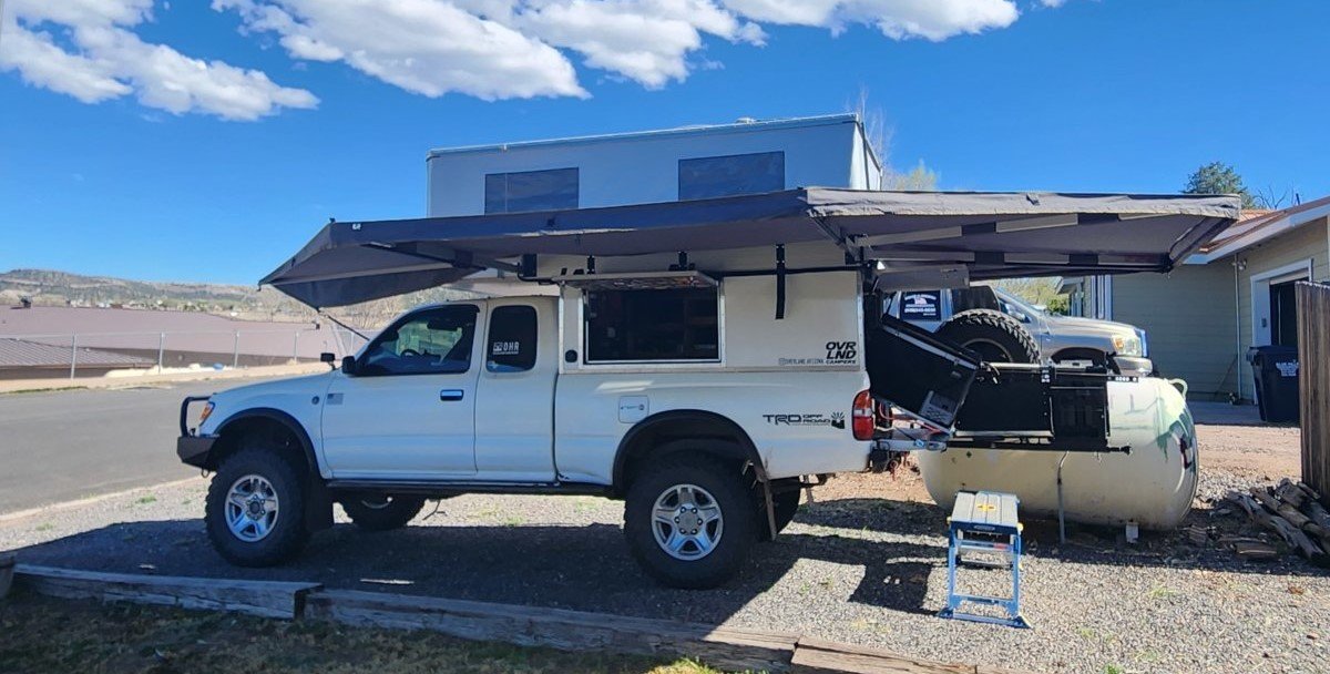

    Opened it up a little. I hope to get out more.

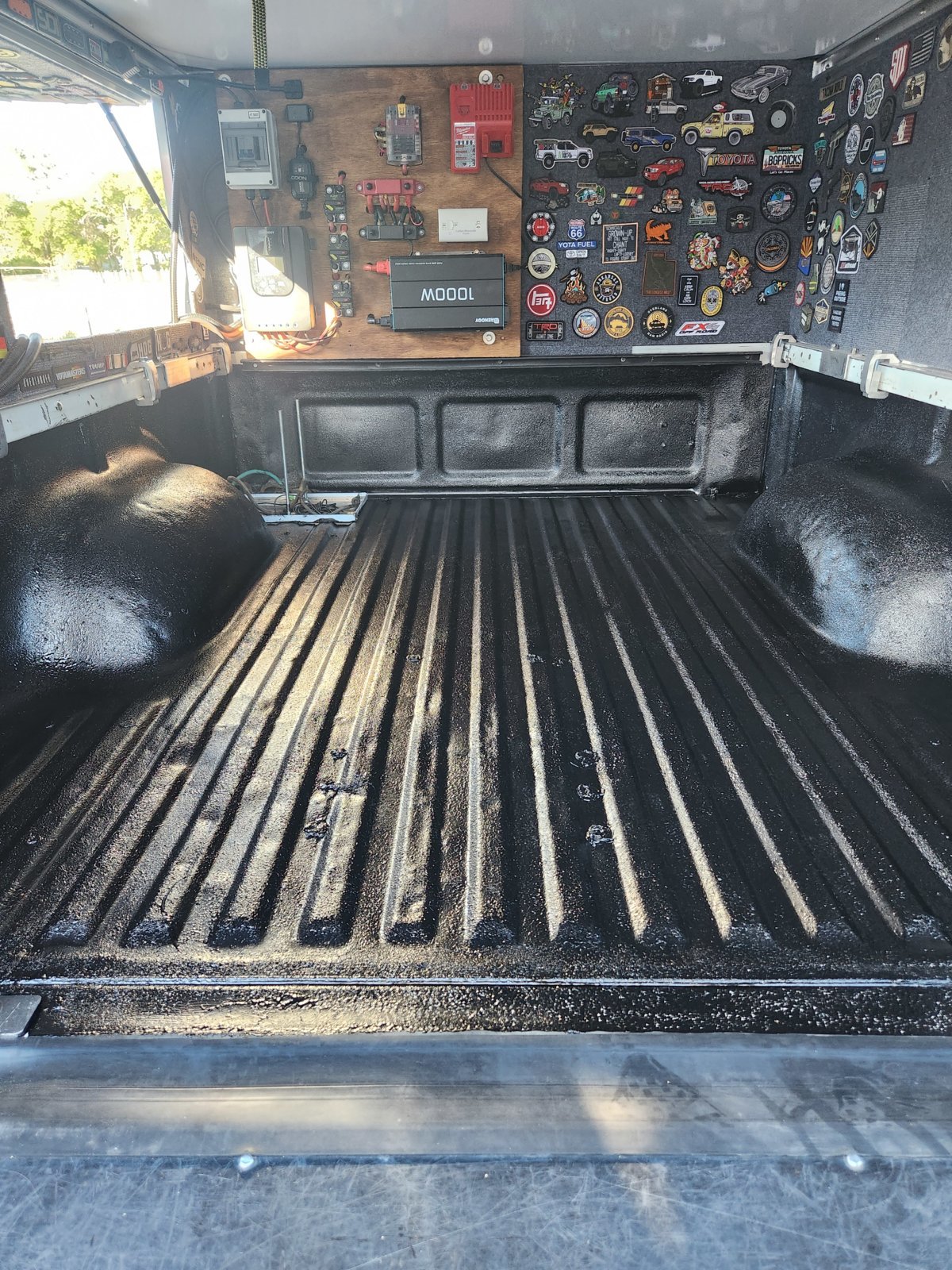

    Finally rhino lined my bed.

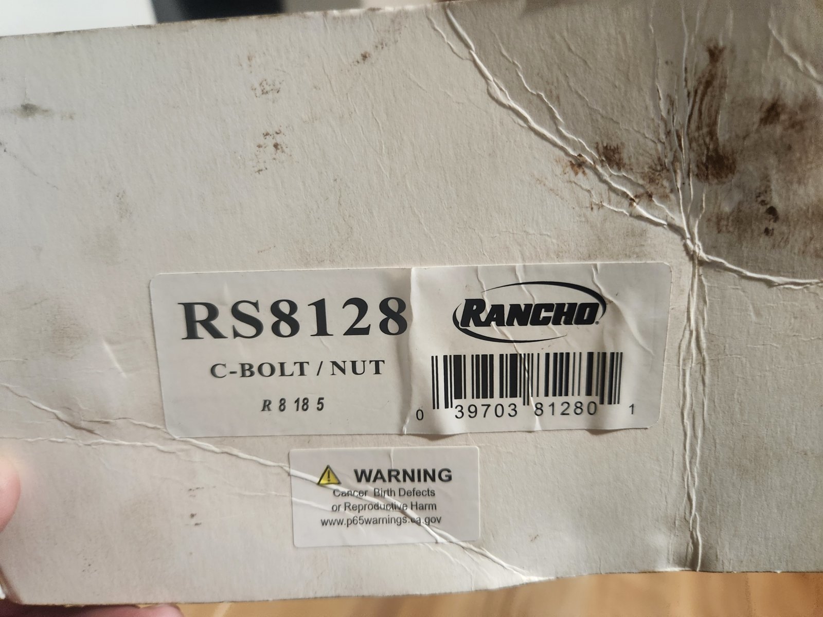

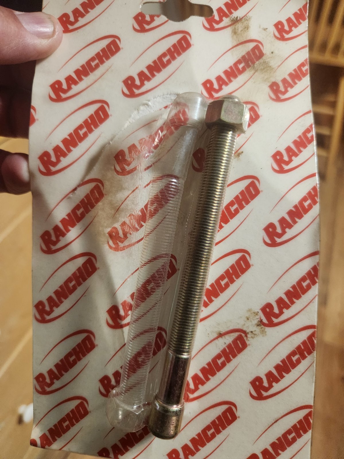

    @Phessor hey man. I’ve read through your killer build and love it. I couldn’t find anymore information on what bolt you used for your air ride set up?! It’s by far the simplest and most quality set up I’ve seen by far. Ide love to mimic it. Is that leaf spring centering bolt just replaceable or is it something that needs to be cut and welded in place?
    any info would be great. thanks again man. Your rig is inspiring.
  19. Jun 18, 2024 at 8:28 PM
    #739
    Phessor
    Phessor [OP] Well-Known Member
    Feb 15, 2014
    #123156
    3,579
    Bob
    1998 TRD XTra Cab
    Stuff
    Thank you, it is a pretty easy modification. I used these bolts to replace the factory ones. Once installed, just cut them off flush with the second nut securing the airbag cradle.

    It's a good setup to copy, I did the same lol. One thing I found was getting a flange nut to secure the cradle helps keep the setup lower overall without needing to use a washer and a nut. Mine stuck up a little bit originally and the clacking of the airbag on the centering pin/nut drove me nuts.
