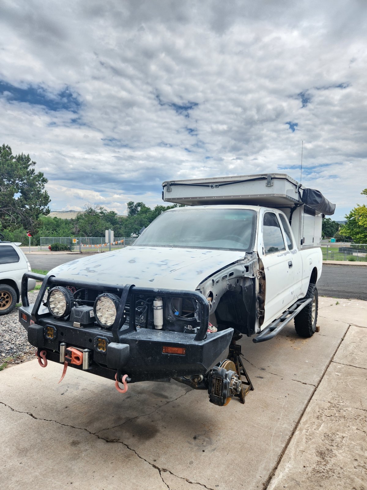

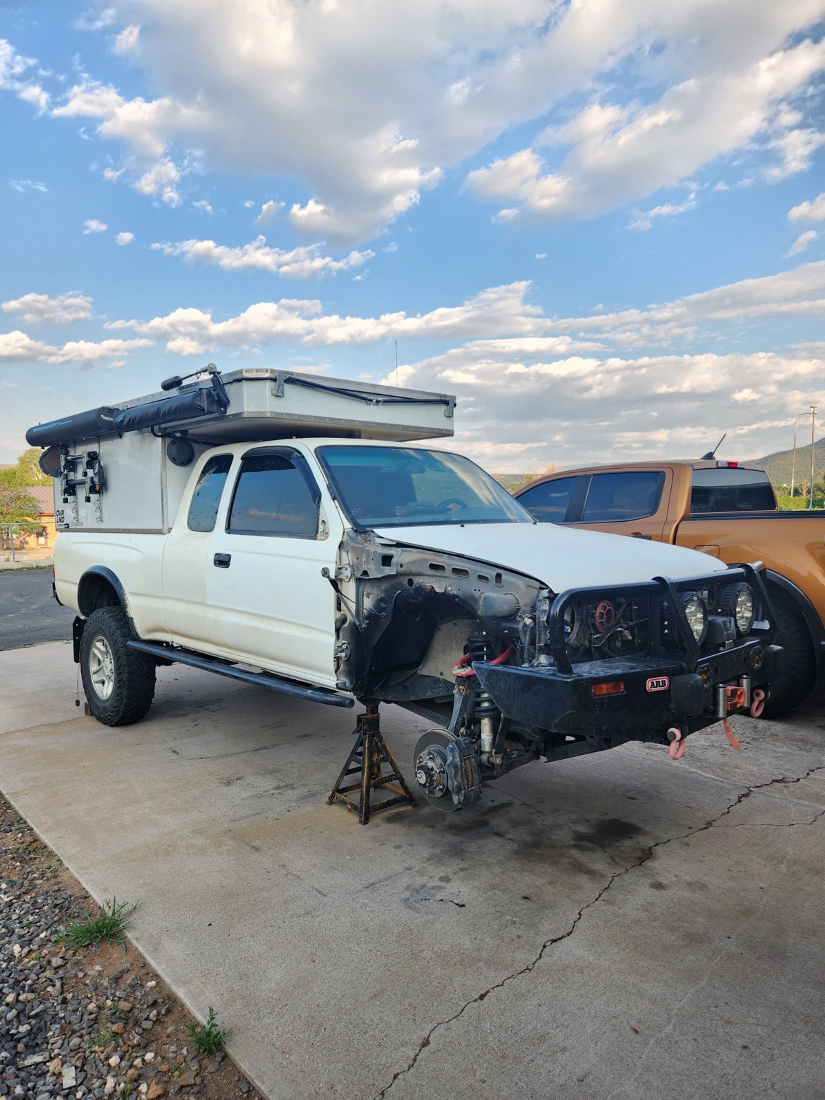

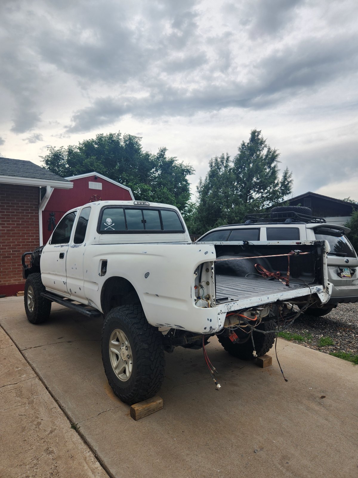

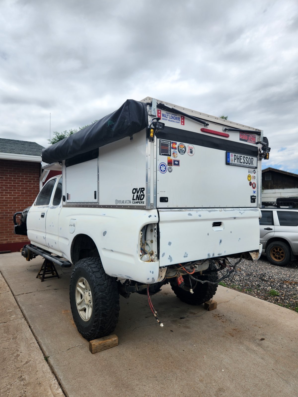

    Well, some things have happened since the last time I updated this page. I decided to raptor line my truck. the old paint was so bad, it made me cringe to look at it. So here is were I am at to this point.
    Started the disassembly process.
    Started sanding.
    Removed the OVR LND camper.
    Finished sanding.
    Tomorrow I will wash it good with soap and water, and use some degreaser on it. Then let it dry and get it all taped.
    Hopefully I can get it painted Friday and reassembled on Saturday. I have a big trip planned for Colorado in less than two weeks.

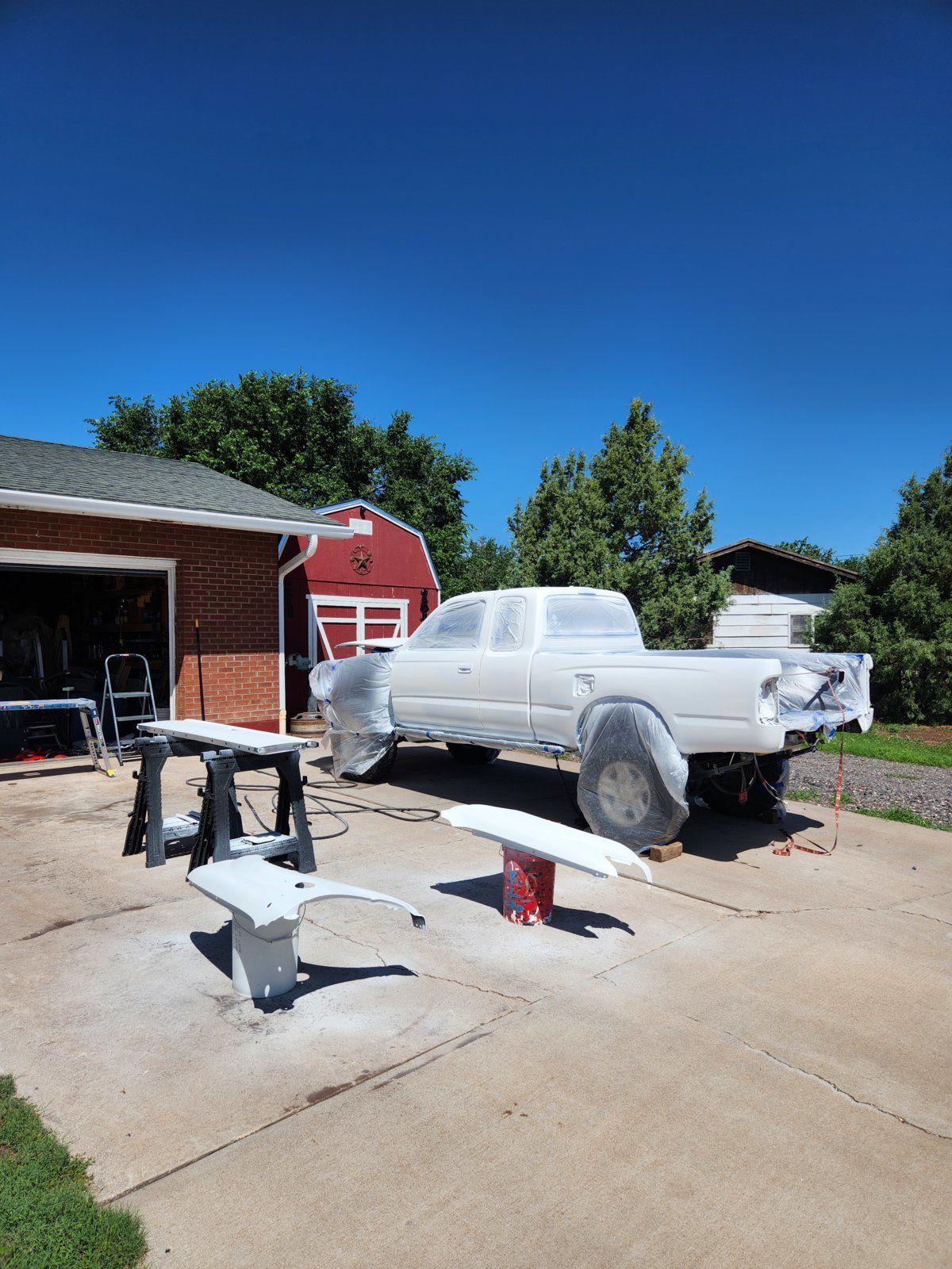

    Paint is done, now it gets to sit in a buddy's shop for a few days to keep it out of the rain.

    All painted and back together.

    How easy was it to apply and get it looking consistent? It looks really even.

    The prep work was the hardest part of it all. I purchased the 8 bottle kit and could have used a couple more because of the white over primer.
    I also purchased the better spray gun and ran my pressure at 60 psi. Overall I am happy with it.
    Spray time was about three hours with 45 minute flash periods.

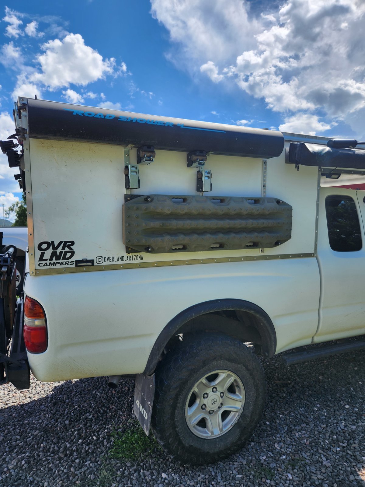

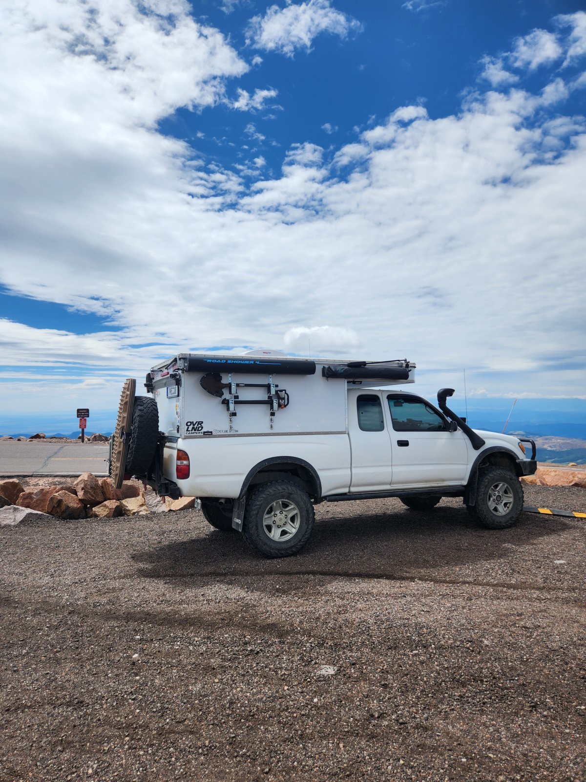

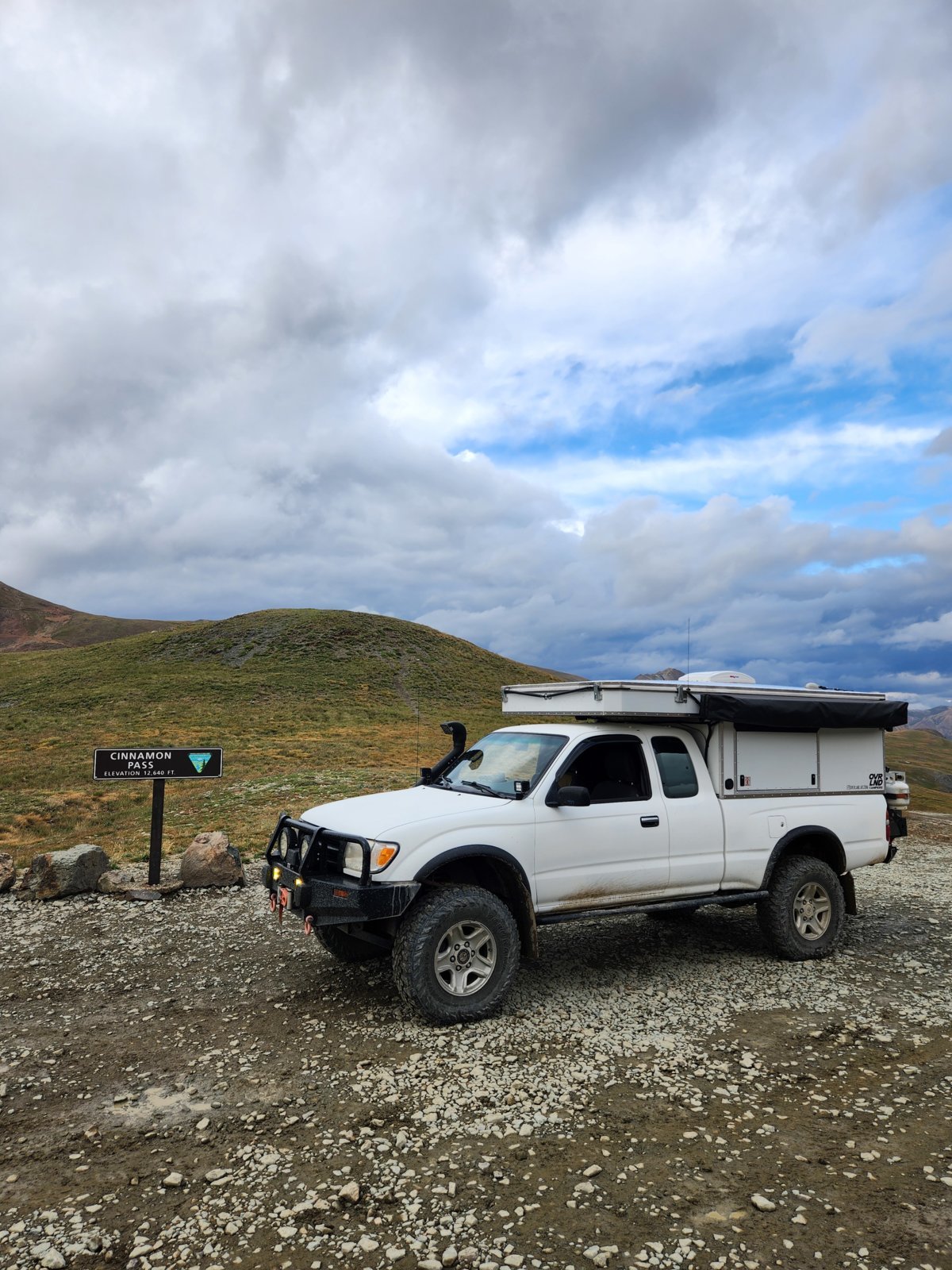

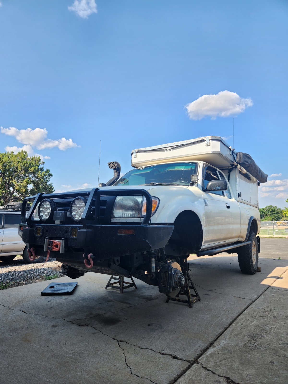

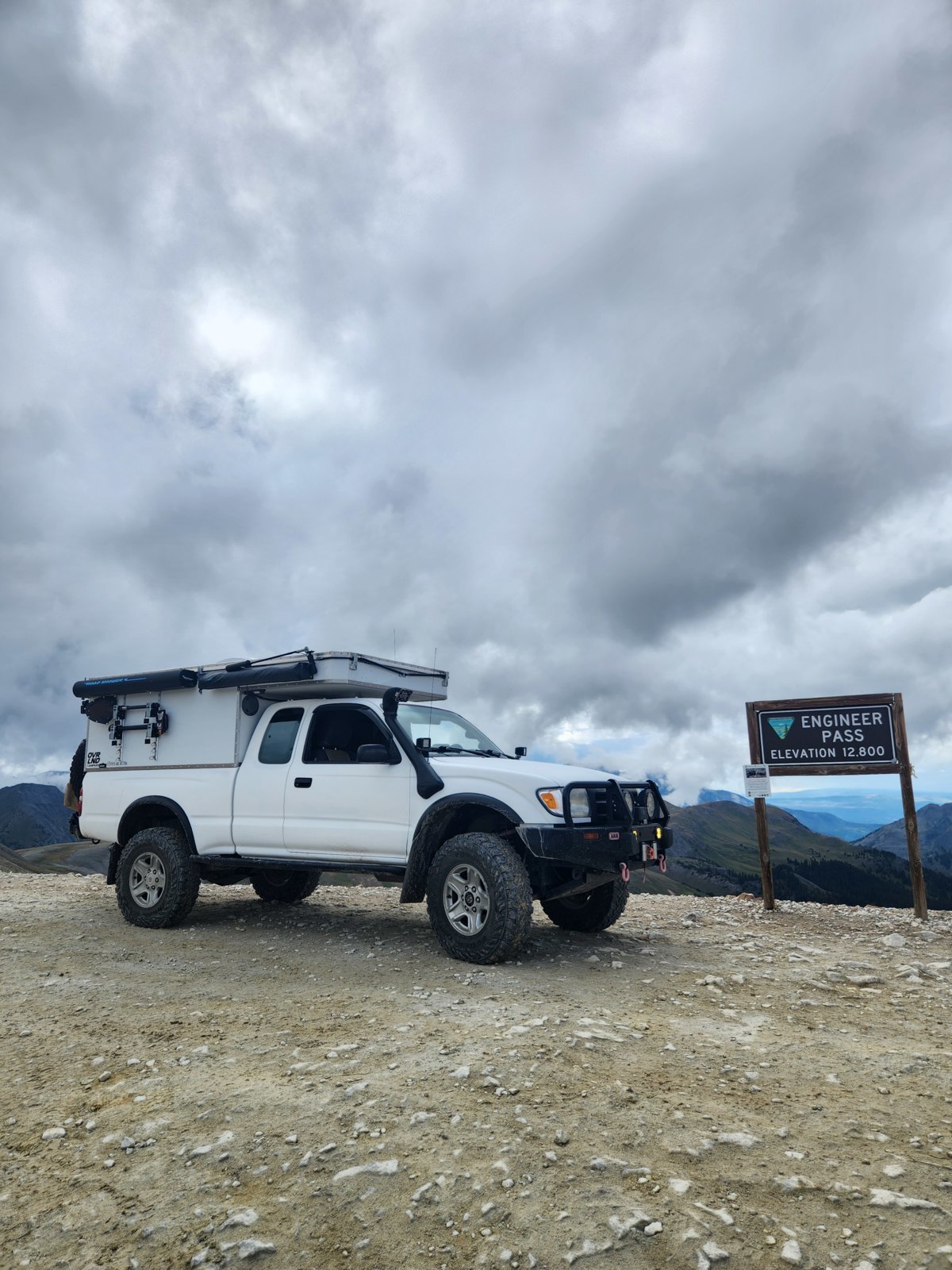

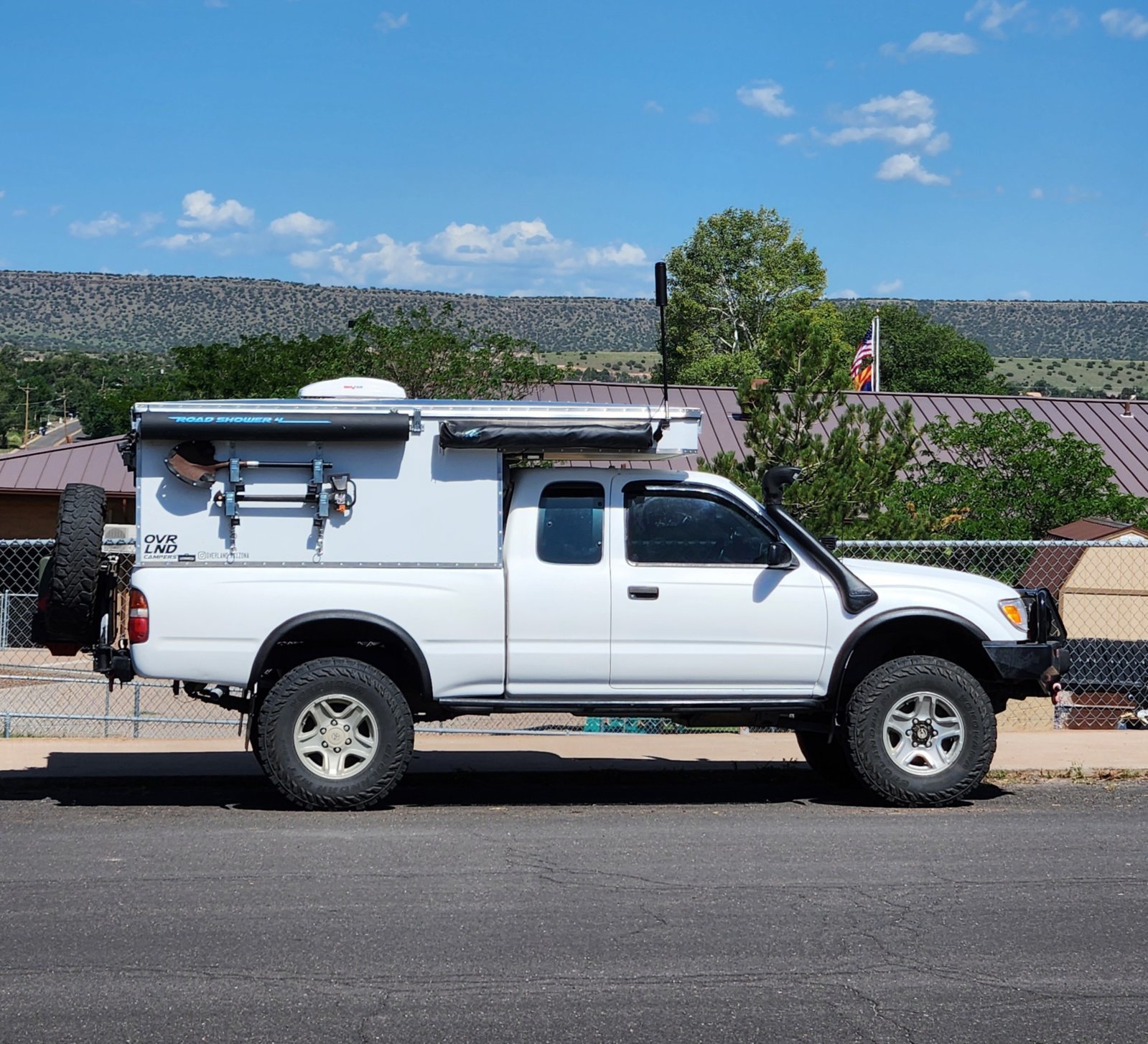

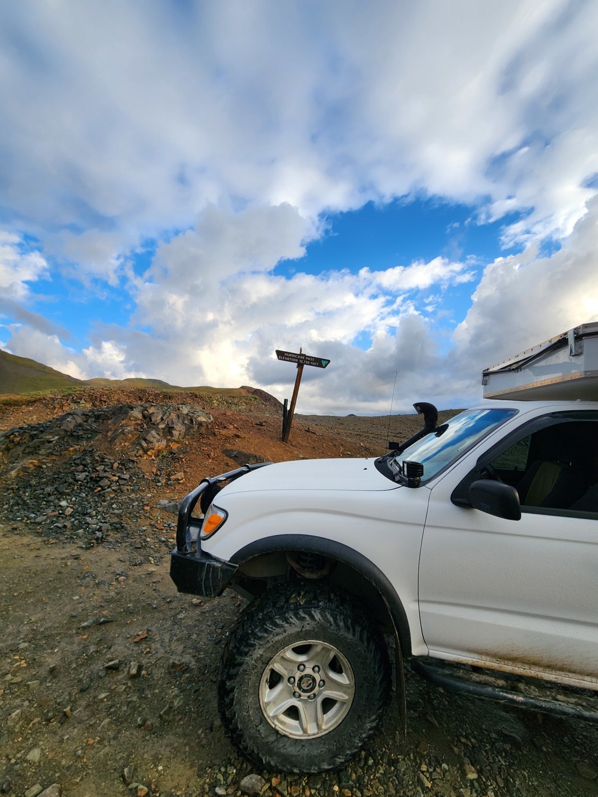

    Just a few shots from this week.
    20240809_143416.jpg 20240809_160842.jpg 20240809_184603.jpg 20240810_065841.jpg 20240810_071005.jpg 20240810_074113.jpg 20240811_115548.jpg 20240811_115258.jpg 20240811_121921.jpg

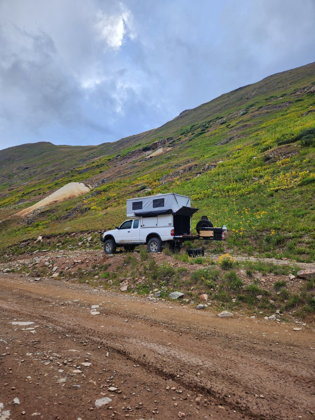

    Camping at 11,170 feet in Colorado.
