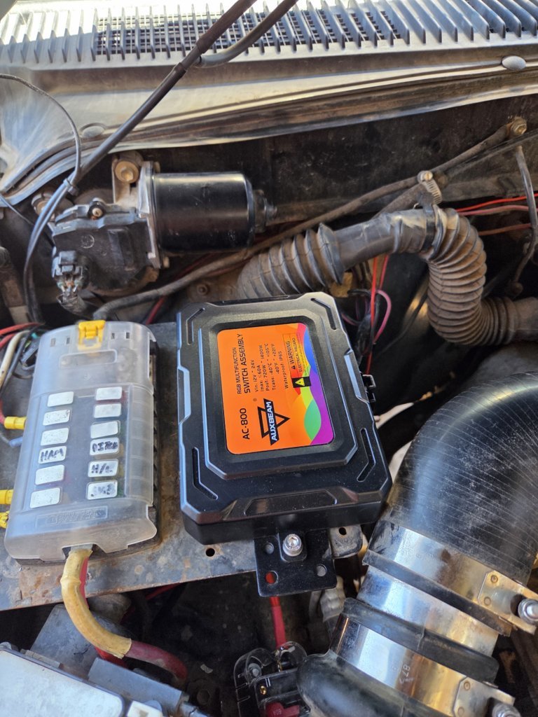

    Thanks for the response. Always looking for something that fits right, and stows small.
    So with your mount at the battery, is that bent and bolted underneath to the battery mount then? Just trying to figure out what size plate to get and bend to fab a mount, it is the best location (most room under a crowded hood). I the red block near the base a fuse holder?
  2. Apr 4, 2025 at 10:27 AM
    #802
    Phessor
    Phessor [OP] Well-Known Member
    Feb 15, 2014
    #123156
    3,716
    It is a piece of flat stock I had laying around with a couple pieces of angle brackets bolted to the fender, and the battery.
    The red block is just a bus bar for all the powerpoints.

    Looks good and functional. Thanks for the info. I have to put a battery disconnect switch on the rig till I can chase down the short. It’s also a back up rig so it needs to be easy for my sweetheart.

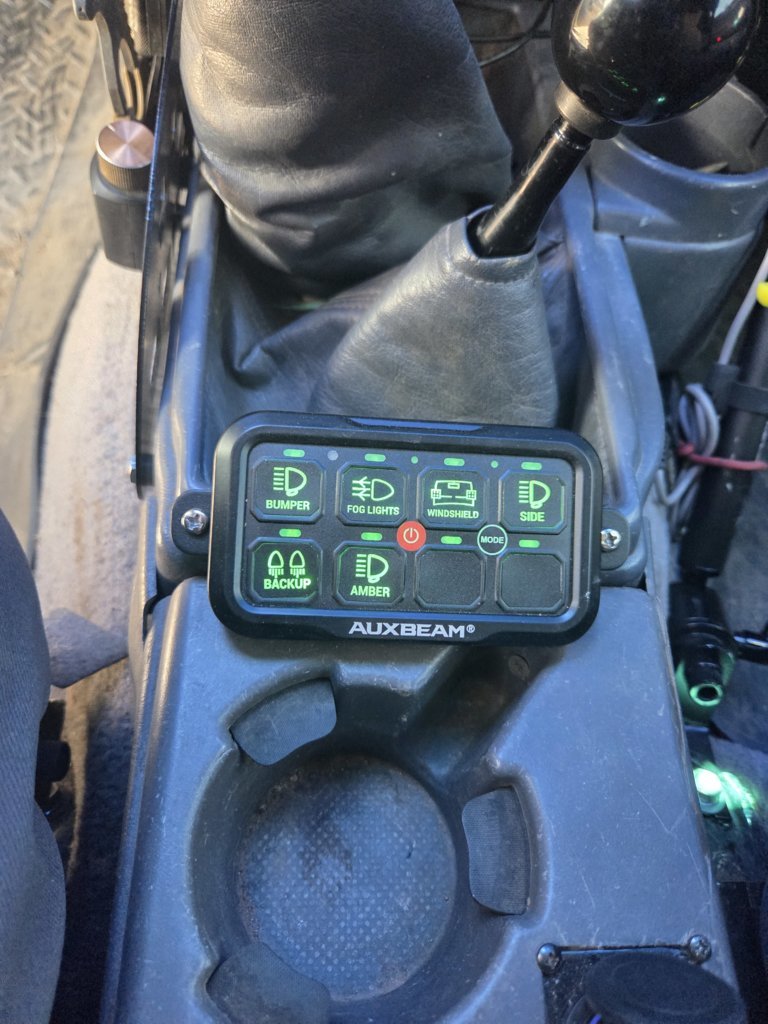

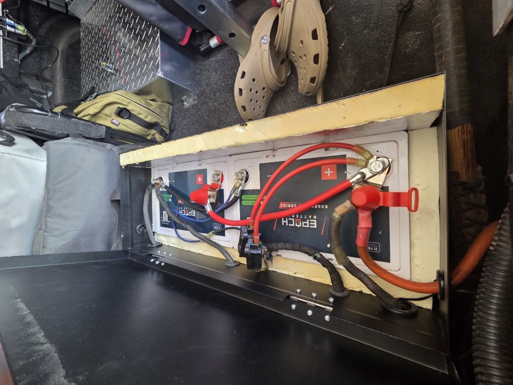

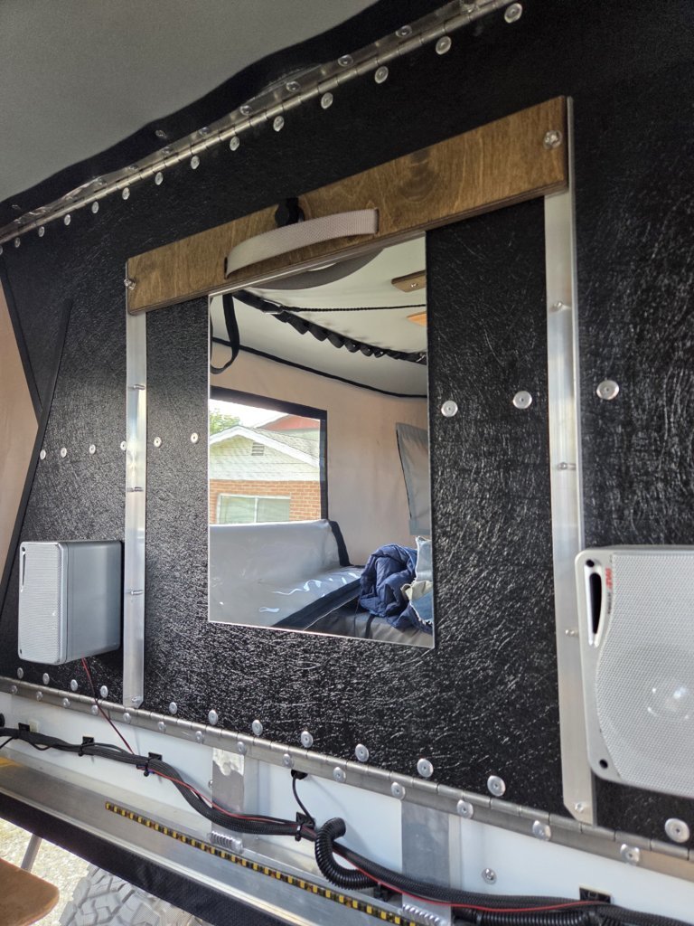

    Added some updates to my truck.
    I now have two batteries for my camper power system.
    I also added a mirror.
    I also replaced my old lighting system with a new one.

    How's that auxbeam setup? Is the quality there?

    I like it so far. I have wanted to replace my six shooter for years, it never worked correctly, and the switch ate batteries.
    The aux beam allows me to use the control panel, remote, or my phone.

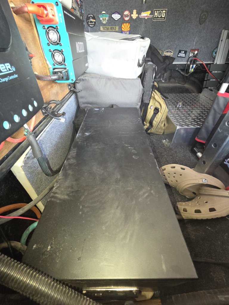

    After my last week long trip to Idaho, I found some issues with my truck that needed fixed.
    First was the bed, the front mounting points were cracked and broken. I had to remove the bed and weld everything back up. I plan to keep an eye out for a good replacement bed for the future.
    Next was some wiring issues. I have ran my power for my fridge and water pump to a double Hella plug for a year now with no issues. But the long trip and the extra gear caused things to bump into the wiring causing wires to come loose and loss of power. The other issue is my Renogy solar controller, it has random faults that shuts off the unit, which I had my fridge power tapped into the load circuit.
    So to fix this problem, I build a power distribution box for the fridge and water pump. I ran the power directly from the fuse box, and I switched to Anderson plugs. So no more dealing with my solar charger, which I am looking to replace with a Victron or Redarc unit.
