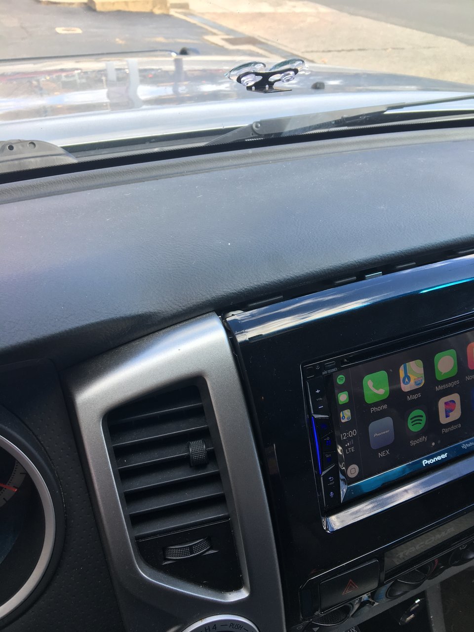

    You may have seen my thread complaining about pioneer and carplay. Turns out that is all on the iOS side of things. I am having a couple of other minor issues with my install.
    The maestro RR steering wheel controls are acting a little funny. I have up/down arrows set to seek +/-. Those only work sporadically. I am using spotify. Sometimes they work when I press them, sometimes they don't. The odd thing is the volume up/down and ALL other buttons have not given me this problem, they work ALL the time. Weird. I am going to try a re-flash but seeing if anyone else had this problem.
    Also having a fitment issue with the Scosche trim kit. HU is Pioneer 1330NEX. I just can't for the life of me get the trim kit to fit all the way around the top of the stereo. The top clips don't even reach the top holes. Is it possible I just don't have the wires behind it tucked away enough and it's forcing the HU to bulge out too much for the trim? I'm going to try and pull the entire thing out and re-route the wires, but I've also done that twice already...

    Reflash the module. Are your clock springs worn out? If it’s just on Spotify it’s peobably the communication.
    Can you post a pic of what your talking about the fitment? Is it a problem of the kit and radio or kit and dash?

    One pic shows the actual fitment of the trim. It is screwed in tight, must just be the wires behind it not allowing it to fit flush right?
    I also attached of pic of the very top of where the trim is supposed to clip in, am i missing the inserts in those holes to allow it to "snap" into place from the top?
