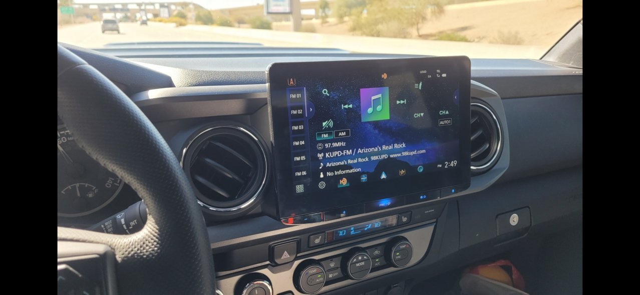

    After a couple adjustments, it sits up pretty close to the dash. Sounds alot better than the stock jbl system sounded.

  5. Jun 29, 2021 at 7:25 AM
    CoastieRon
    CoastieRon Hammocking Fool
    Jan 1, 2018
    #239946
    2,431
    Ron
    Nashua
    Lil' Silver
    Too much.
    Looks great, I think I might be going with this model....
