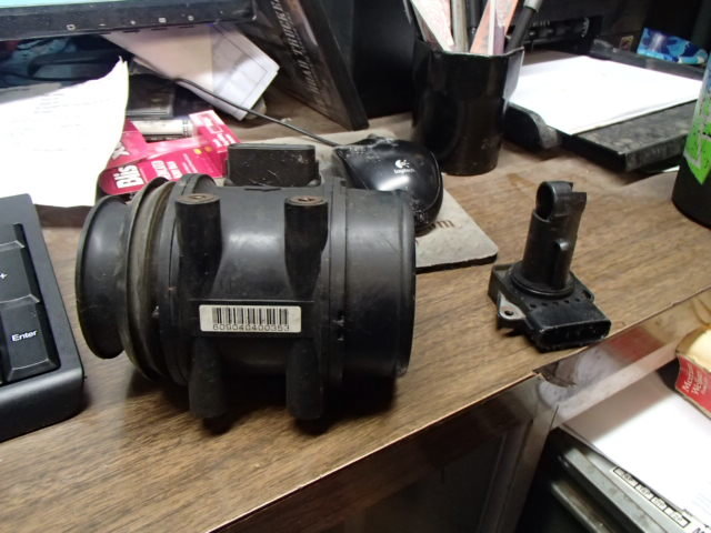

    I've got a 97 tacoma with a 3.4 that I needed to replace the airbox. I ordered a replacement from parts galaxy which is supposed to fit 1999-2004 3.4 tacomas. When I received the new airbox I quickly realized the MAF for my 1997 is not the same as the 1999 MAF. The 1997 MAF looks like the image below and connects to the intake tube on one side and inserts into the airbox on the other side.
    The replacement airbox has a hard plastic MAF connector (which the actual MAF just bolts onto) that is permanently affixed to the airbox which then connects to the intake tube. Picture of replacement airbox and 1999 MAF below
    So my question is, can I buy a 1999 MAF and install it in my 1997 with no ill affects? Do those MAFs have the same operational specifications and share the same wiring harness connections?

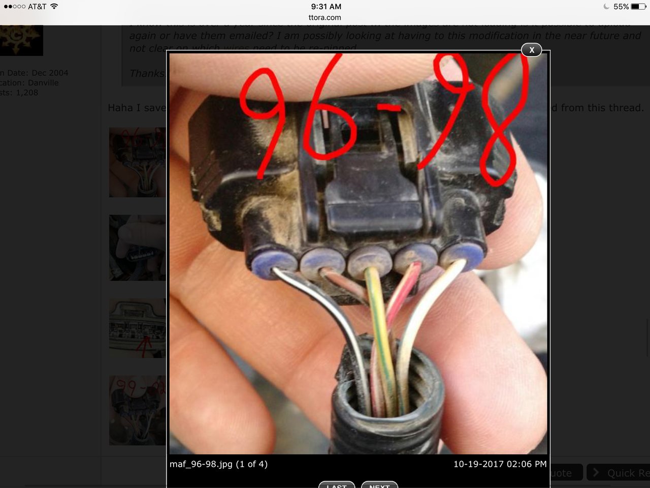

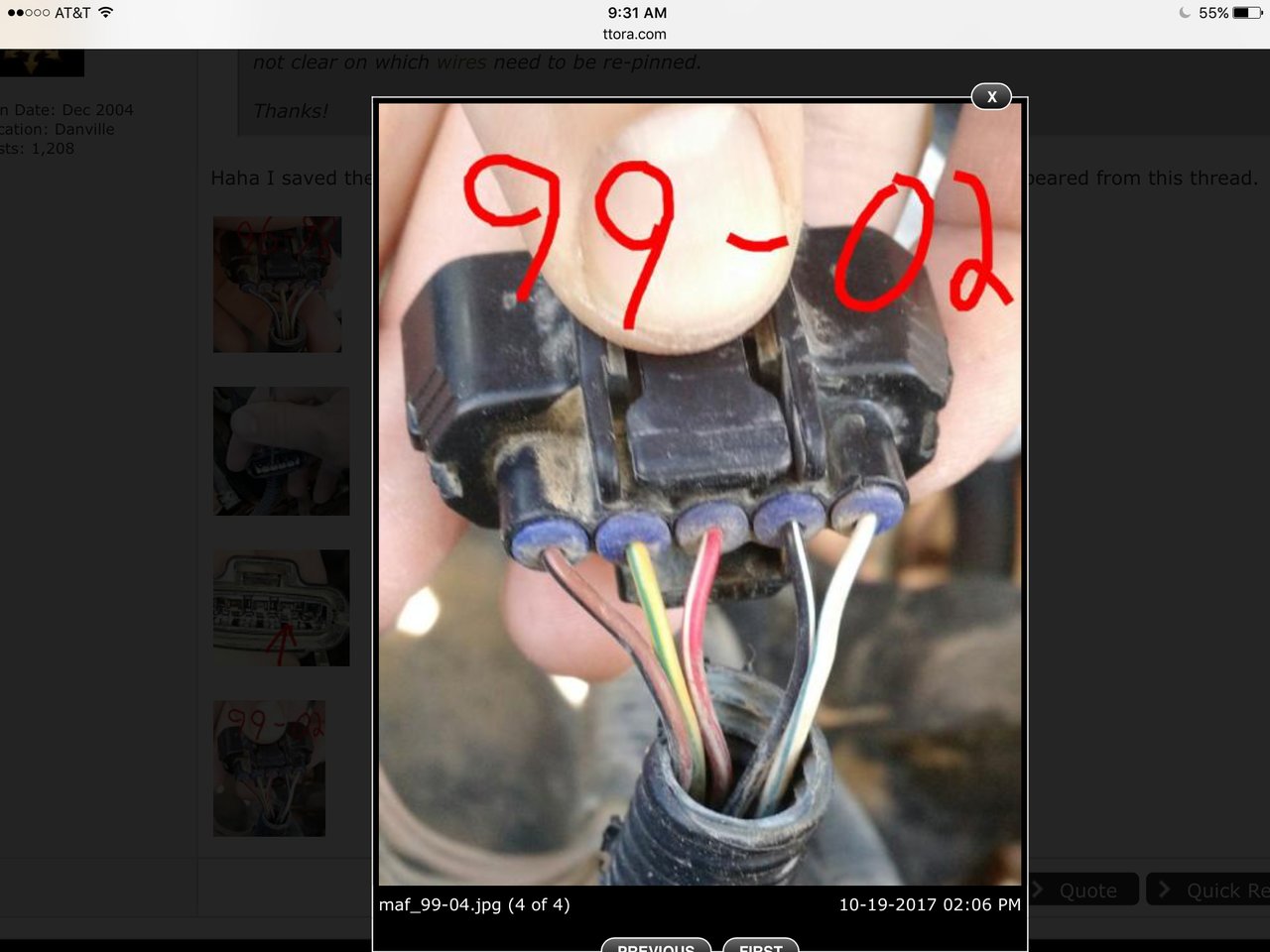

    Thanks, I've had trouble finding links that have still functioning pictures as many of them are old links. I found one on ttora that seems to work:

    Very doable, just re-pin the connector to match the pin out of the new MAF. There is a little plastic piece that is on the inside of the connector. That will pop out and
    then you can get a small screwdriver under each pin and release the pin out to the back of the connector. I've done a few.....

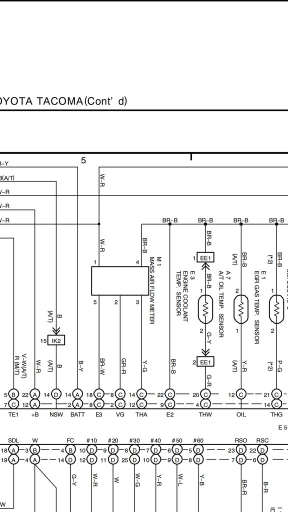

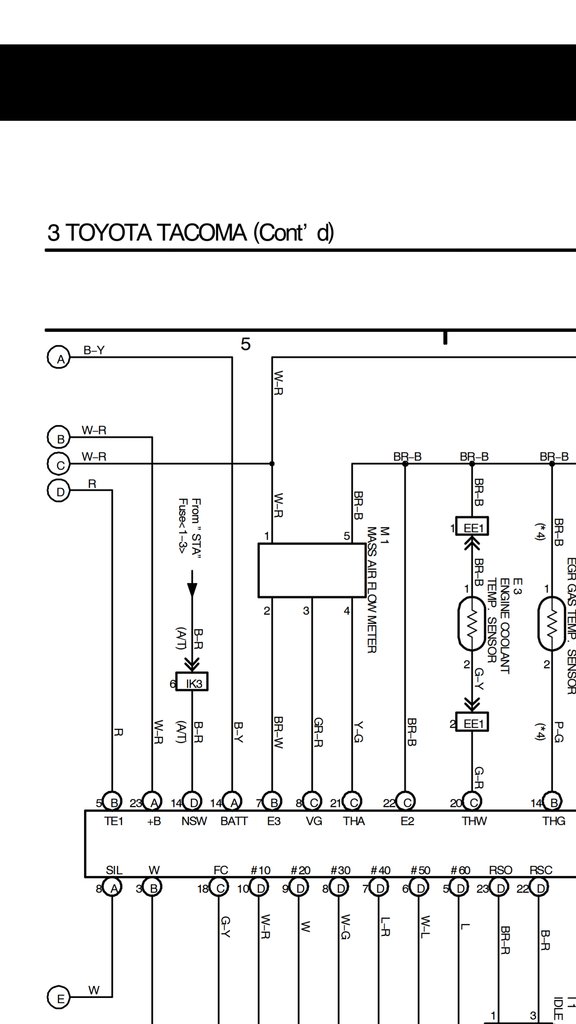

    Looking at the front of the plug, with the latch to the top, (pin side, not wire side) you read the female plugs left to right. You read male plugs right to left. Your plug is a female. Looks like the only wire that is in the correct place is the W/R wire which is power.
    Here is the 97 Tacoma
    And the 99.

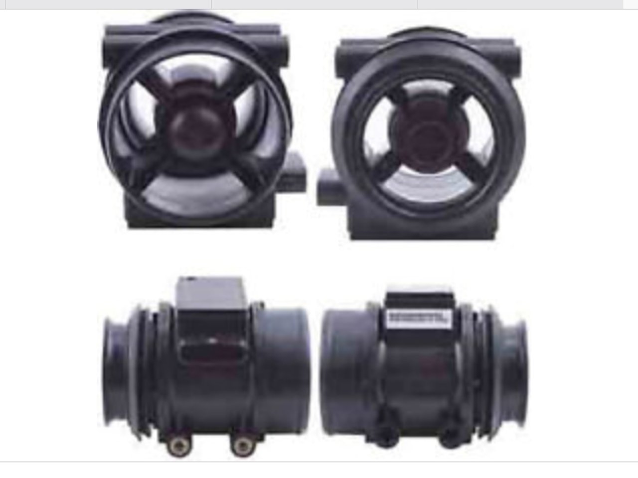

    No it will not!! Completely different
    I just cut the part where the MAF installs on the 2000 of a broken air box
    One on the left old style on the right new style
