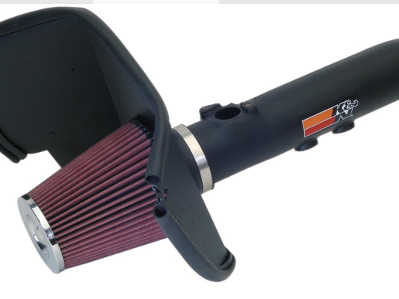

    Ok, I will look into my options, I have a KN airfilter so don't need the whole air cleaner box,
    Just the tube section that will hold the newer sensor that will hopefully fit in the KN air filter end, that's not restrictive like the original one

    I figured it out, all I need is to get the plactic tube section that KN makes for the 2000 model
    and replace it with my 1997 version and then just add the sensor on top and pin the wires correctly.
    Now no more restrictive tube section and a 60.00 MAF sensor

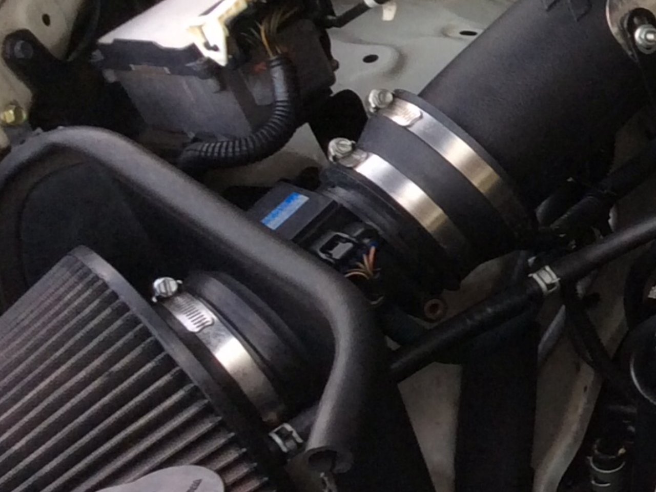

    Got everything installed today and drove to work. (40 miles one way through rolling hills.)
    I installed 3" tubing from the air box to the throttle body. (Throttle body is 2.75")
    Drilled aluminum piece for methanol injection fitting.
    I had to swap three wires, started without a problem before change, but would not accelerate.
    My old air box had the deck plate mod, this one does not, I plan to do that this week and see if it improves anything.

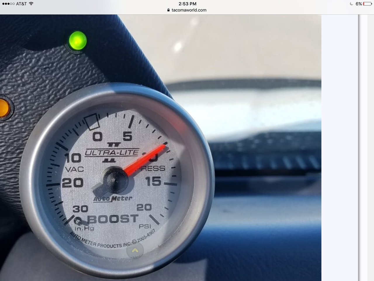

    With my old air box and deck plate mod my average WOT boost was 7 pounds, sometimes 8 pounds but not very often.
    With the new air box and MAF and NO deck plate mod I could get 8 pounds easily at WOT coming to work today.
    Pros:
    1-Idles really nice, not that it was bad before, just seems smoother.
    2-Better throttle response, seems smoother all the way up to WOT.
    3-AFR is just a hair more than before, bounces around 14.5 mostly, before was 14.7
    4-WOT AFR is 11.2, before was 11.5
    Cons:
    I went with a cheap aftermarket air box, it is definitely thinner and cheaper. It works fine, but I will be on the lookout for a factory one.

    How is your ping issues at the 2500 rpm spot.
    I went to a #2 nozzel from a #1 nozzel and my boost went from 9.25 to a little over 10

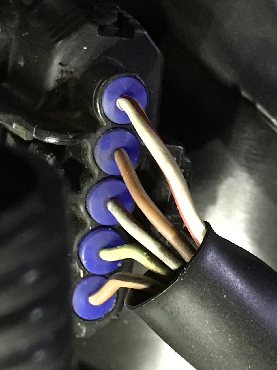

    My 1998 plug has different colored wires, do you know which ones I have to swap? I did the swap, changed the wires I thought were correct, it works, but now my gas mileage is down by 5MPG.
    My current plug swap.
  13. Jan 9, 2018 at 12:27 AM
    #33
    Luv my yota
    Luv my yota Well-Known Member
    Aug 27, 2017
    #228278
    965
    00 turd lift 33's
    Kings,total chaos uppers, Deavers, JBA headers, Borla exhuast, engine mods, DC power 270 amp alt, 2k watts of sound, gps alarm.
    You have youre wires the same as mine. I think you should stay with the new maf, as for 5mpg drop it is cold and creating lots of h2o in our tanks, star enzyme gas treatment gets her done for me give it a try.

    I'm running the TT Supra MAF so my wire placement is different. Between the two of you, looks like you have the correct placement. The 5mpg drop seems drastic.
