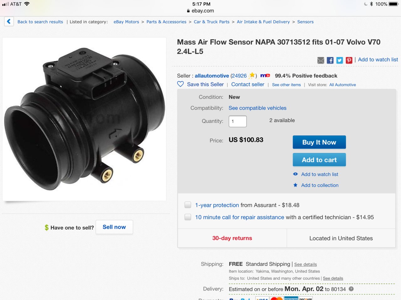

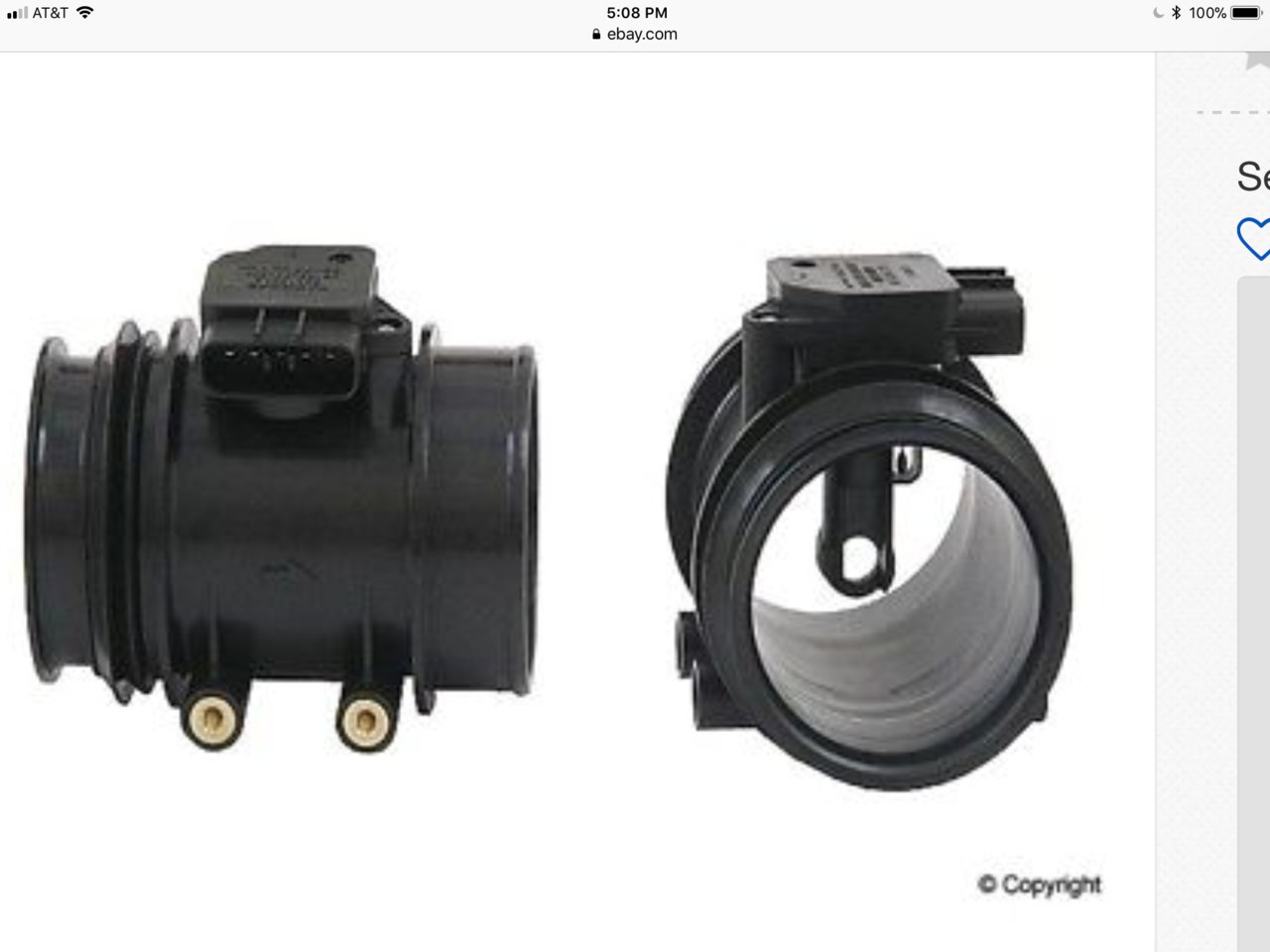

    Wow, that’s exactly what I’m needing!!! NO bullet in the center!!! And the MAF sensor is removable
    New for 100.00
    Did you use the Volvo MAF sensor? Or did you add the 2001 MAF sensor?
    You said the MAF sensor is the same? Made by DESNO?
    The 2001 MAF sensor is a direct screw in fit into this housings ????
    MAN I LOVE THIS PLACE FOR INFO!!!!

    The MAF sensor is the same they are exactly cross referenced. Look for a better price than that. Bought several and have never paid more than $30. If it is used just clean the sensor with QD electronics spray cleaner. Don't forget to repin. Very Easy.

    Ok, yes will get a used MAF tube and probably buy a new DESNO sensor.
    Can you shot me a photo of your wires color?
    I have a 1997 v6.
    Hopefully yours are the same color combo as mine
    Can I put the 2001 Toyota DESNO senior in the Volvo tube or will it show a
    lean code as the 2001 tube area is a bit larger?
    Maybe I have to use the Volvo sensor as it’s tuned to the tube air flow size??

    The Toyota and Volvo MAF are the same. The tube is just the right size. No worries. Just do it.

    Well after a lot of research I see that the MAF mod works for some people but most people have the
    lean code that you keep getting and need to tune the ECU. The MAF tube for the 1999 forward is larger
    and the ECU will see the air as going through slower so the fuel mixture is going to be lean because of this.
    So you have to have the same size tube section that the ECU was designed for. The 1999 and up is larger thus you will get a lean code. I’m going to order the 2001 Volvo MAF tube that has no restrictions
    with a new DESNO MAF sensor this coming week and will keep you posted

    Ordered the Volvo MAF tube section bullet free :) and a new DESNO sensor
