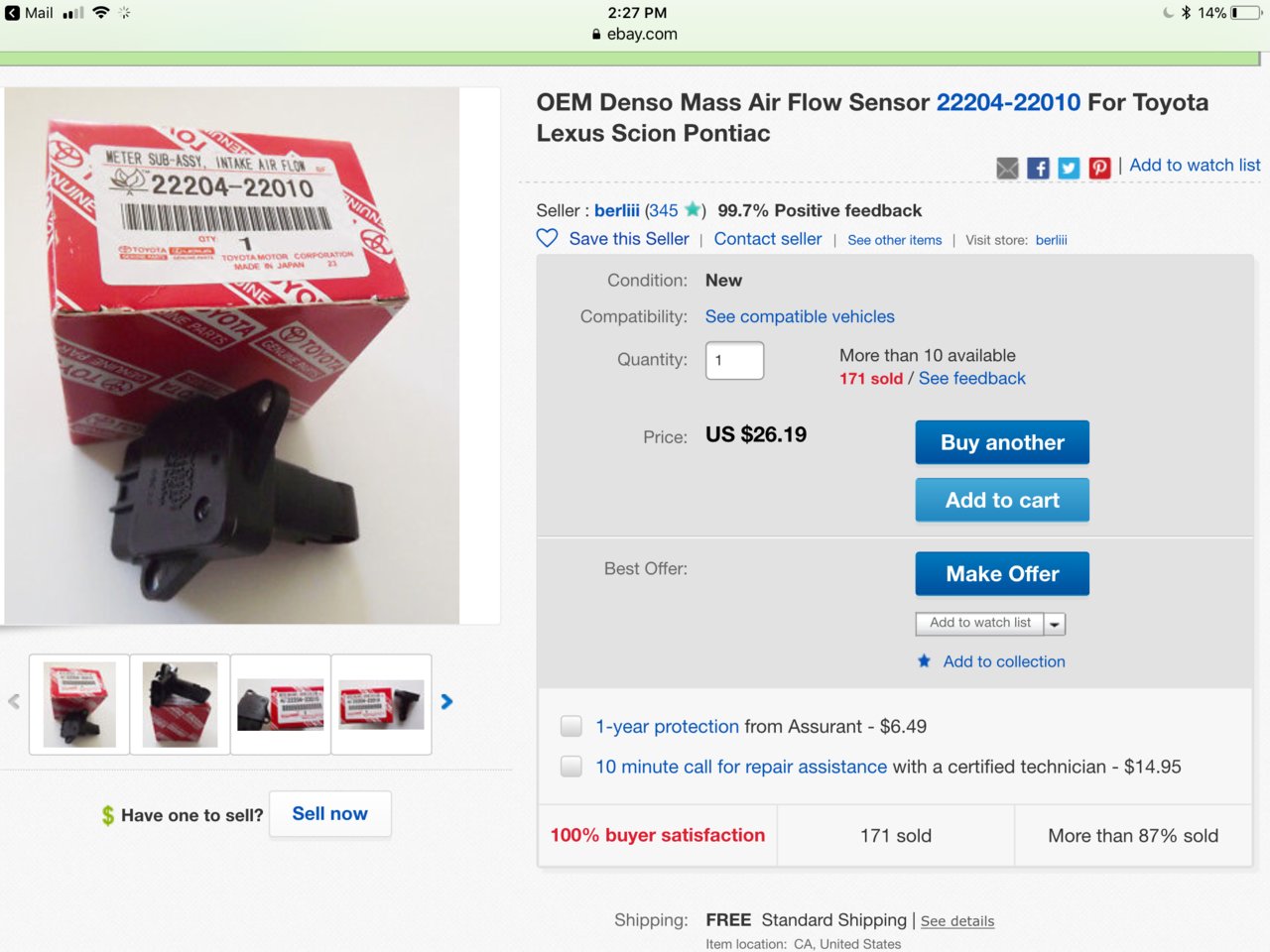

    Were did you find a new sensor for $30.00?

    Actually 26.00, free shipping, this seller has more available.
    I believe that’s the right part number

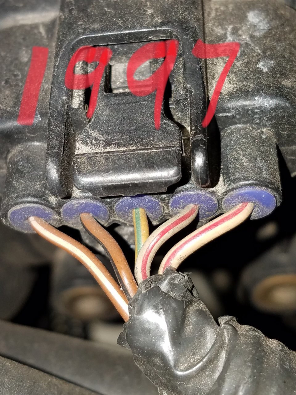

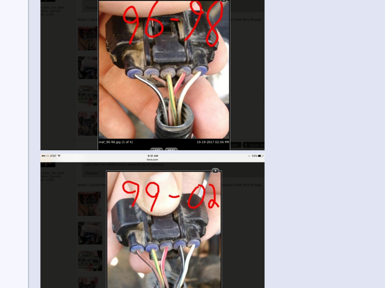

    Ok, so My wire colors look different than what I have found for other OEM wire pin setup.
    Anyone know how I pin my wires going from 1997 to the 2001 MAF sensor?
    Apparently the wires are NOT all the same colors from 1996-1998
    The two wires on the right are the same color with the same color strip on mine.
    the bottom is a photo of someone else’s conversion but the wires are different colors than mine.
    I’m guessing with my color it would go like this using the 2002 photo below as reference.
    Pin1 brown black strip
    Pin2 yellow with green strip
    Pin3 white with red strip that is in slot 4 from the original pin out
    Pin4 Brown with white strip
    Pin5 white with red, this one does not get moved

    My wire colors didn't match the conversion photos either.

    Did you just line them up by the wire locations instead???

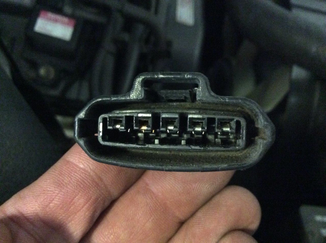

    This is how I had them wired before, not sure if it was right, but it worked.

    Ok perfect, that’s what I was guessing too, thanks
