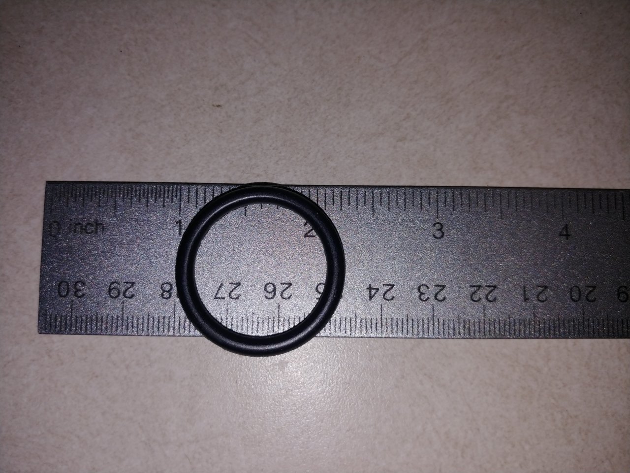

    Do you guys know what size the O ring is for the MAF sensor on an 02 with the v6 is?
    I'm chasing down the cause of my P0420 CEL. Today I replaced the gas cap with an OEM unit and while cleaning the MAF sensor I noticed the o ring has been pinched and is swollen.
    Hoping I can get one today and see if these 2 items will fix it.
    Thanks!

    Do you still have the smushed ring, I replaced mine out of the generic harbor freight o ring kit just by matching them up side by side.

    I do.
    That's the kit I planned on getting. Just wanted to confirm it'd have the correct size before making the drive.
    Thanks!

    If you measure it I can check the kit for you to make sure, it's been like 6 years since I replaced it but I'm 90% sure I got it out of that kit

    It looks to be about 1 1/4"

    But thicker but she's in there

    Nice! What size is that?
    Just picked up the kit

    In the package named 215

    Thanks! I went to a few places and couldn't find one that was of similar diameter and thickness. I used the 215 from the metric kit but I'm going to get an OEM replacement sometime so the MAF sits more flush than it is now.
    Thanks for the help!
