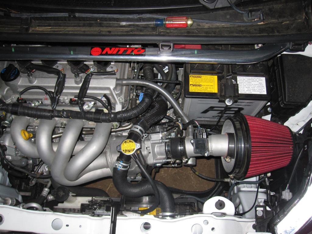

    From my own experience, that's true. I replaced the stock plastic intake manifold and 46mm throttle body on my Yaris with a larger aluminum intake manifold and a larger 55mm throttle body from a Corolla...
    ... and as long as the MAF sensor remained within it's stock tubing diameter section, it worked just fine with no codes thrown. The air filter and intake in front of the MAF sensor is also larger.

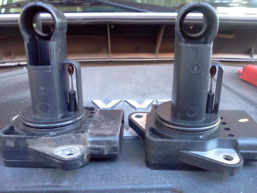

    I've seen two different kinds of MAF sensors. One where the wire runs across the diameter of the housing, like this one;
    But the one in the 1GR is a little different;
    61529d1345923972-maf-sensor-cleaning-img_d66ef58c9747ed21ba84d4889259b8d4d449fdc4.jpg
    So what I'm thinking is the first type is tied to the diameter of the housing and I wouldn't expect much change if you put larger piping in front of it.
    But the MAF on the 1GR could be mounted to whatever size intake pipe you wanted. I was concerned in doing so that it wouldn't take the change in pipe diameter into consideration.
    Ok...so in the setup posted by tooter, the MAF reading shouldn't change since the MAF housing is the same.
    What do you all think happens when the intake diameter is reduced to stock size after the MAF sensor, as in the OEM intake manifold or TRD S/C manifold with a URD throttle body adapter?
    I'm thinking that if the intake manifold is the choke point and you place the MAF in a larger housing, it will read reduced air flow over stock. My thoughts being that a larger housing will result in less air flow velocity past the MAF for a given flow rate...maybe causing lean conditions?

    The diameter of the inlet and outlet are irrelevant. Only the diameter tubing where the air passes by the MAF matters. And it doesn't take much. The MAF tubing section is only 4 inches long. The intake tubing and throttle body diameter on each side of the MAF tube are both larger.
