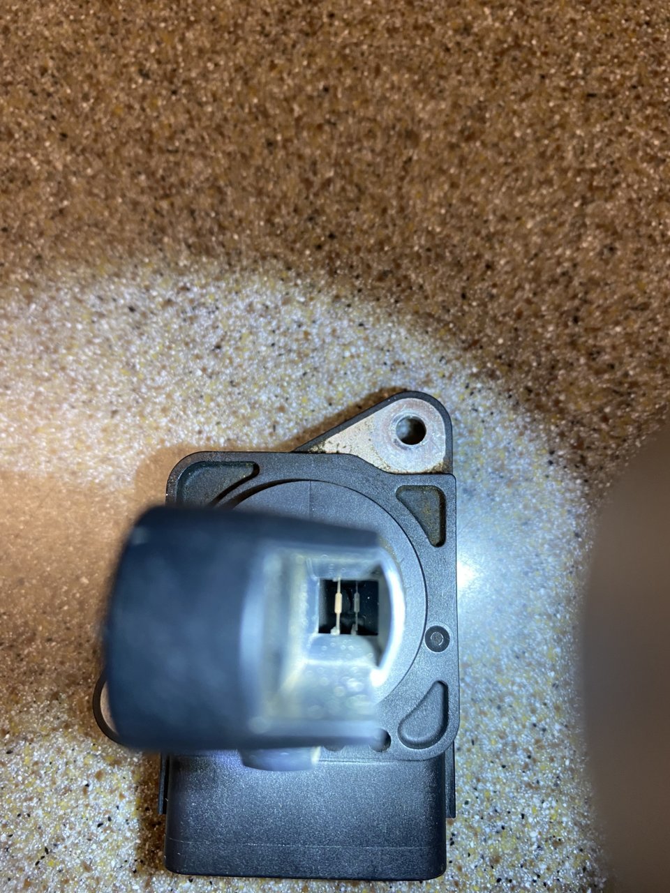

    That "little bulb" thing is the intake air temp sensor, the MAF is down inside the tube next to it. Looks like little resistors.

    Yes. You beat me to it. Here’s my old MAF that I replaced
