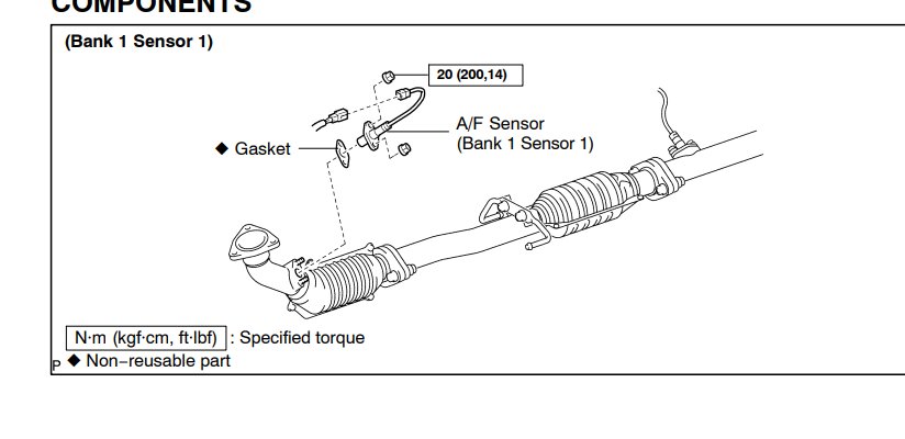

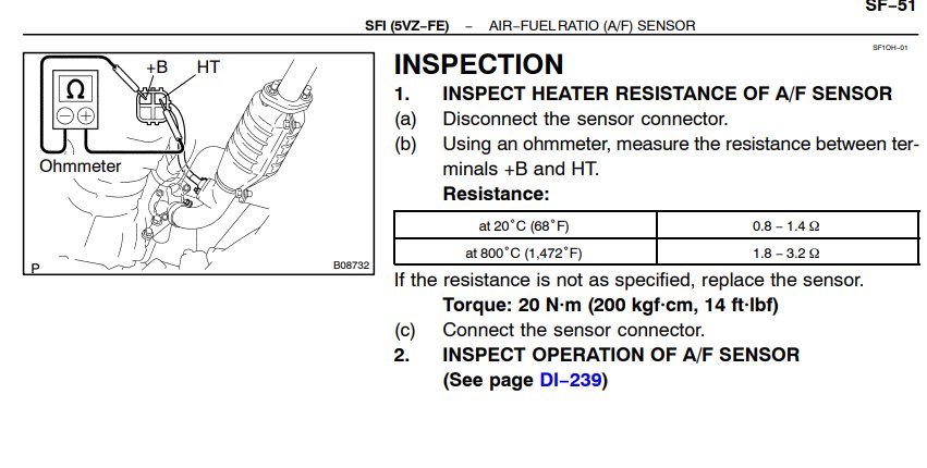

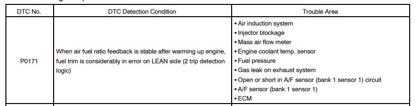

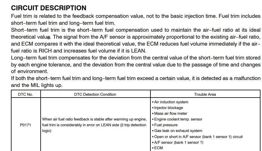

    You shouldn't have to clean the MAF more than once. Either the MAF is higher than a kite on the cleaner (lol) or something else is causing your system to throw the P0171. Perhaps its simply your MAF and needs to be replaced. I'd be checking everything else first before throwing parts at it.
    It measures the oxygen content in the exhaust and provides feedback to the computer. Based on that, the computer adjusts the air to fuel ratio to keep it at the optimum level.
    Since you're seeing a P0171, start with these areas (why I included the A/F sensor info in post#4 - easiest to check next) -

    Thank you so much, this is super helpful! I had no idea that the ECM had such an involved cycle - it makes sense that it’s taking 3 or so weeks to readjust because my wife has been driving it and she doesn’t put many miles on. I'll pull the O2 sensor and check for resistance like you recommended. I don't have a lift - is it easy to pull by just laying under the truck?

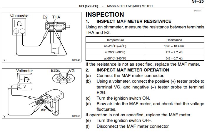

    Also - would it make sense to do a resistance test on the MAF?

    If you do want to check the MAF -
