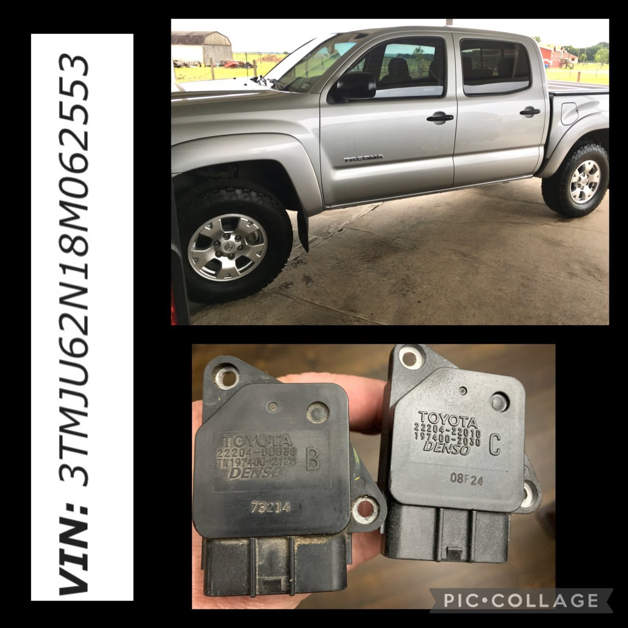

    Bought this truck in 2013 with 12,000 (u read that right). Never had any problems with it until a few weeks ago. Started throwing P010. Wasn’t running any different that was noticeable except MPG dropped - gas quality has gotten so inconsistent that it’s hard to say where the issue is. We could clear the code and the SE light might not come on for days or weeks. A few times it came on just after fueling.
    Here’s the prob: MAFS #22204-0D030 was replaced w/22204-22010. Bought a Toyota one. Truck will not run with the new MAFS. Battery was disconnected about 30 minutes. Put the in the old MAFS and truck runs but will throw P010 periodically. Anybody if there some kinda reset that has to be done for the ECM to acknowledge the new part?

    It’s been cleaned a few times and 99.9% sure everything is connected right. Shoulda said that it started when the screws for the MAF backed out by themselves. This was about a year AFTER the cold air was put on. When it started throwing the code, we figured something got messed up with it from it bouncing around. Trying to eliminate every possibility before saying the new one is a dud and all the hassle that goes with it.

    No other codes ever. The 22010 replaced the 0D030. New MAF is an OEM Toyota/Denso
