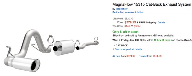

    I was snooping the late-night internet and stumbled across a significant price change on Amazon for the single outlet Magnaflow cat back system. I bit the bullet at $380. These are normally $653 online.
    I'd originally considered Magnaflow but Flowmaster was closer to my price range. The Flowmaster catback dual kit was $550 but I recently found one for $420.
    There are 4 left in stock so go grab one if you need one:
    http://www.amazon.com/MagnaFlow-153...d=1421901207&sr=8-3&keywords=magnaflow+tacoma

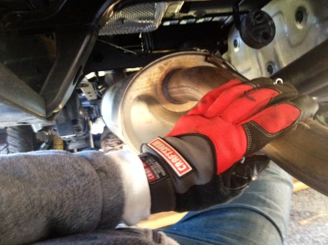

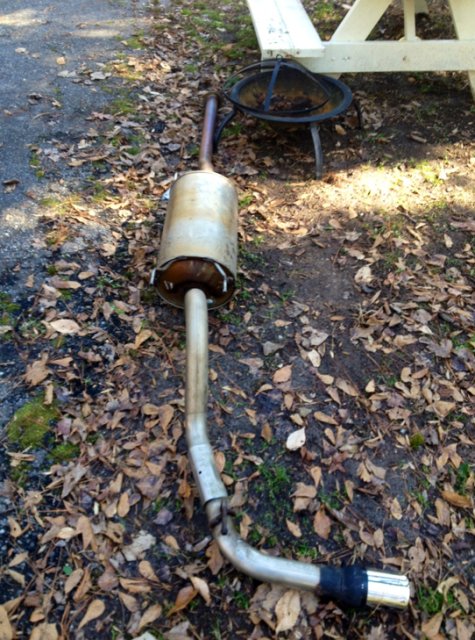

    Removal:
    1) Spray all the rubber hangers with PB Blaster. Let 'em drip a bit & soak.
    2) Moved the truck to warm, sunny spot. Lay down tarp & some cardboard so as not to ding up anything during removal. (flat, dry surface, parking brake ON)
    3) Remove spare tire (you'll need the room when snaking the stock pipe around)
    4) Grab 15mm socket, loosen spring bolts.
    5) Loosen rear hanger. Just work it a bit, it will come loose. Do the same for the most forward hanger. Slide under truck, parallel to stock exhaust, place legs on rear hangers, grab pipe and basically hump it until the hangers slip out of the rubber bits.
    6) Snake it all out towards the front of the truck. This is where you need the tarp/cardboard whatever to keep from scratching stuff up. Probably a good idea to tape some cardboard or bubble rap over stock tip if it's polished.

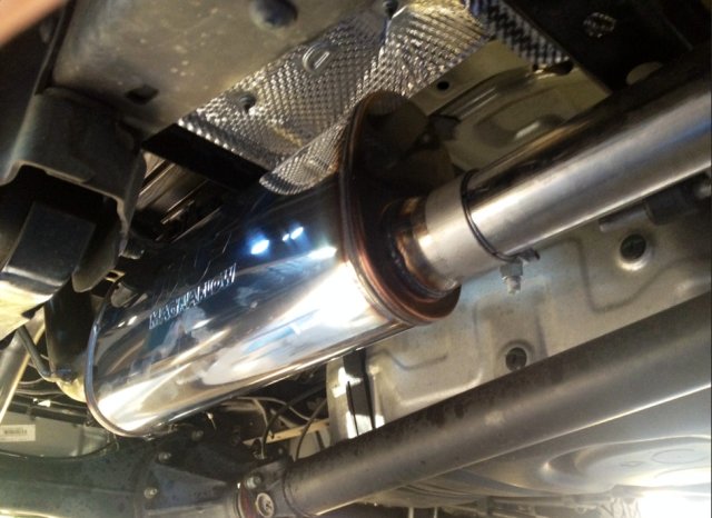

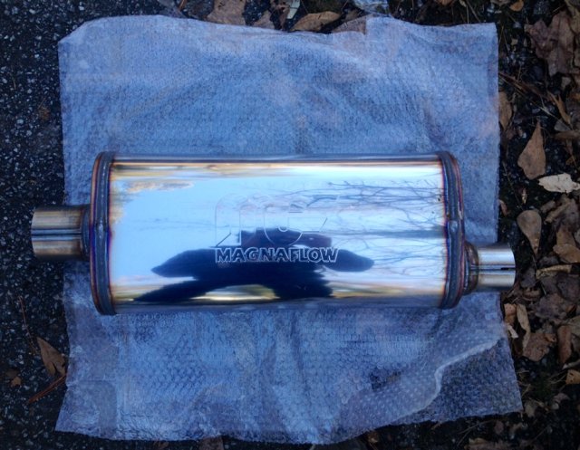

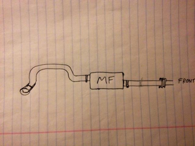

    Installation:
    1) Connect new straight pipe with stock bolts.
    2) Hit all those rubber suckers with more PB Blaster.
    3) attach muffler, don't clamp down.
    4) attach rear piece (be sure to leave protective wrapping on tip until finished).
    5) Hit all the hangers with some lube and slip them into the rubber bits.
    6) Tighten everything up. Double check all the hangers. Put spare back on.
    7) Fire up truck, crawl under and feel for leaks. Turn off and make adjustments.
    *8) If you do have leaks and do not intend to weld the exhaust, I advise you go to local auto parts store and grab some Tiger Patch ($4). Put one or two loops of that on each end of the muffler before clamping down pipes.

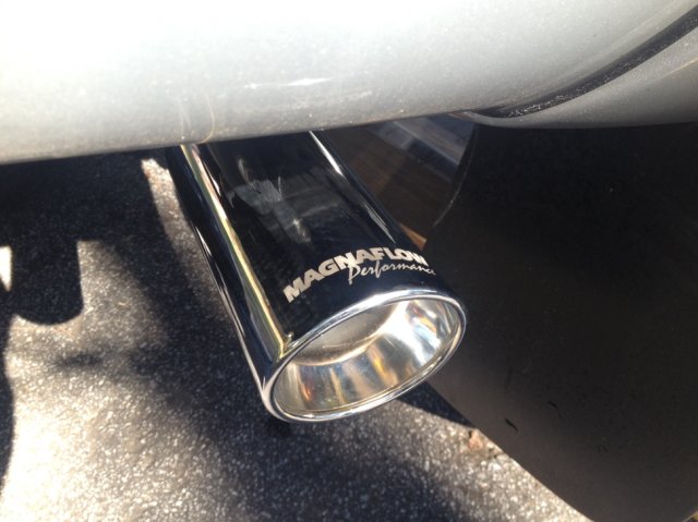

    Screen%20Shot%202015-01-24%20at%204.17.2_54d4adb8aa3164a903499cdd4a9837f1b7edc91b.jpg

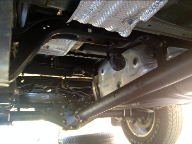

    Bye Felisha:
    Screen%20Shot%202015-01-24%20at%204.17.3_f881fd034ef21e92fb8f87224c0a2f21fbb761d0.jpg
    Screen%20Shot%202015-01-24%20at%204.17.4_e34b8aea78b447eb5da1f09d75798b487131e8ea.jpg
    Screen%20Shot%202015-01-24%20at%204.17.5_ae79c8d528d8940cd1df0a4517aeac45833b5250.jpg
    Screen%20Shot%202015-01-24%20at%204.17.5_bd77d00acc4fa6a4b4f77c1970fbf47cb0268421.jpg
    Screen%20Shot%202015-01-24%20at%204.18.0_cdef9fe3be2033086cc17af452f4289ce8b60974.jpg

    Great! I look forward to hearing your feedback. It was an enjoyably quick and painless install. Be sure to get some of that Tiger wrap for the slip joints to avoid leaks if you're not welding the muffler.

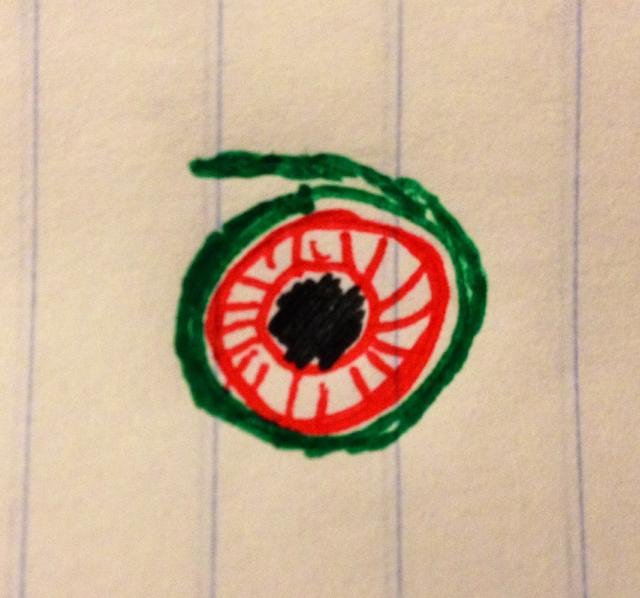

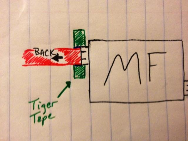

    Here's the way to wrap it up (lol) if you're not welding:
    Pretend, imagine (or even practice) by slipping two drink straw ends into each other. Blow water through. Some will leak at joint. Wrap tape across the joints like a bandaid on a finger. This will seal the joint and keep from leaking.
    Easy fix with this stuff called Tiger wrap. It's maybe $4 at the auto parts store. Once you have everything in its final position, cut a strip of Tiger wrap long enough to go around the pipe once and an additional inch or two for over wrap. Don't do any more than this. You want the clamp to fit over this wrapping. After wrapping, squeeze it tightly to bond with the pipe. Clamp everything down and drive for 20 minutes. The heat will bond the wrap to the joint and seal it up :)
    image_zpsiyfq250d_ad7b896217f89ff5b3a6b8f5f52b64d49447844a.jpgimage_zpsl2jcaat3_8c8a75bd251456da5b10ae90a88daff4ee661922.jpgimage_zpsifcxgg7s_ba91fec30dec0e6efc8e644765e8b17c74bfd759.jpg
