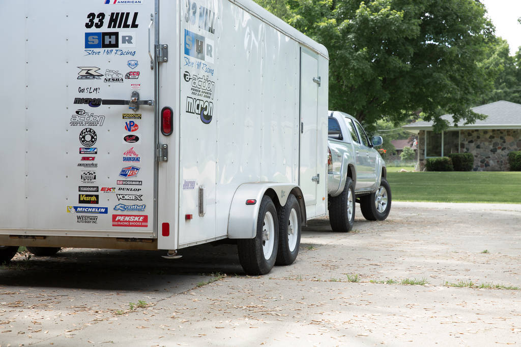

    So after towing I can say larger exhaust hurts pulling power and reduces torque.
    I installed my OEM lift and exhaust and now was time to test them...
    So I hooked up my 16' enclosed trailer to see how it goes...
    Accelerating is worse with the trailer (about 4000 lbs with gear) with the new exhaust and it is much louder towing. to tow with a smaller muffler would be annoying..
    It does seam to hold speed good but accelerating is weaker... I could be running leaner but I think the larger pipe shifted the power curve higher. It still pulls good it just slower than before with the trailer on... It defiantly has less torque/ pulling power below 3000 rpm...
    For towing or low end torque stick to the stock pipe diameter....
