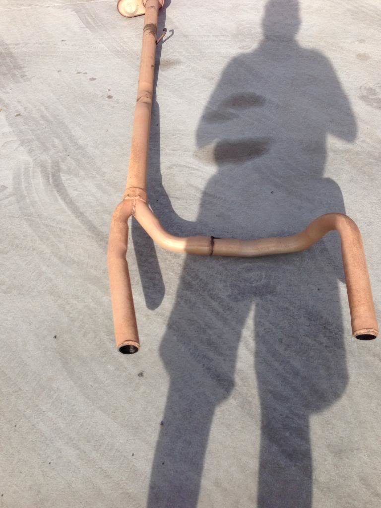

    Now those above urd y pipes are $500. The shop I go to did this for me (essentially same thing)
    Cost me $270 and that included the muffler. So if you went to a muffler shop that knows what they're doing, they could replicate the y pipe without any questions. May not be as pretty and may have a few tiny creases, but saves a shit ton

    No offense, but if it's not smooth outside it's not smooth inside that pipe. I can count several kinked and restrictive bends on that pipe. You maybe should have found a better shop that could of done mandrel bends rather than those kinked ones that interrupt flow. Again, please take no offence, but I could of made that pipe in a shop. I'll just order the flawless URD and maximize my results.

    I see a few problems with the Y in your picture. The merger of the two halves, will cause a restriction, as the exhaust pulses from either side can go into the other, as well as towards the muffler.
    You already mentioned the kink bends. Those cause restrictions, but I am sure you are aware.
    Then the most important piece which is missing from the exhaust shop version, is...dun dun dun.... some form of a flex coupling.
    The URD Y-pipe utilizes the same style flange where it bolts to the catback. That way the OEM donut gasket can be used, as well as the spring bolts. Which allows the catback to flex at the flange of both the OEM y-pipe and the URD Y-pipe.
    Without that gasket, or a stainless steel flex coupling, your exhaust will soon crack. Some where. There will be exhaust leaks, no matter what.

    No I know I was just saying for $270 I got the the pipe and the muffler, not saying it was perfect at all, I didn't ask for it to have minimum bends and creases, I just told them to remove the cat. I'm just saying if someone is looking for a cheaper solution, a muffler shop could recreate what you want but cheaper. Obviously material and workmanship is why it costs $500. But without the muffler, the shop quoted me $125 to redo that section in multiple pieces to reduce the bends/creases. So max hp/TQ the $500 are worth it, but for $/TQ and $/hp the "custom" job at a muffler shop is a better buy

    Undertsood, read the post above. It was a shitty example no doubt I was just showing the options for people who may not want to drop $500
    And about the cracking, I had the same shop pipe my Subaru (gorgeous job) with a nicer material, minimum bends and had no creases at all. Did the same thing with the flange as you stated, so there was no flanges. If was on there for 3 years of racing and beating the shit out of my wrx, and it never cracked. So I guess it's who you get it done by

    Just to get technical, in your course you more than likely talked about closed systems and not an open exhaust. The results will be dirastically different for an exhaust system over, let's say, a coolant exchange loop or steam loop at a nuclear power plant. Even though some of the base principles and the physical laws are the same there are differences when the gas is not regulated to a consistent flow. I took a lot of fluid dynamics in University, trust me :eek:.
    Secondly, there are huge differences between the way you want a supercharger set up and a turbocharger. The main one I always think of when it comes to exhaust is that you DO NOT EVER want any valve opening overlap on a turbocharger, but you absolutely want it on a supercharger. For a supercharger this is a great way to get a little extra cooling in the combustion chamber which helps decrease pinging and increase power. For a turbocharger this will cause a backflow problem since the exhaust will pressurize and damage to the turbo will occur.
    True dual exhausts like I think you are suggesting would be sweet, but ultimately more than I need and a PITA to fabricate. I think with the Y-pipe upgrade I'll have relatively free flow compared to the stock y-pipe :D.

    Or you just got hella lucky.... Don't take one experience to mean it's a good long term practice.

    Don't get me wrong, I 100% understand what you're saying, and I completely agree too! The urd y pipe for our truck, and an exhaust system built for our truck specifically are going to flow better, have better gains, look better and hold up better (the better material) and is just all around the choice to go when you have the money. But for someone who's looking for similar gains, but no where near as much, has other options. But a $300-$500 cat back system and a $500 ypipe is an expensive investment. Where as for max $400, could have a muffler shop pipe and put the muffler on for you. The $1000 investment will be the max gains and best results, but for half the cost or less, you can have a similar set up.
