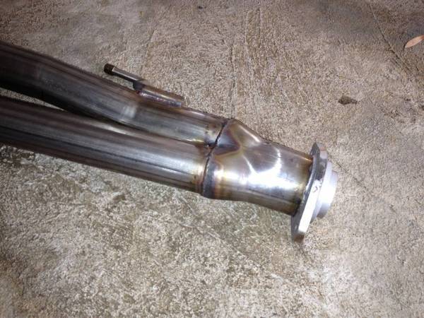

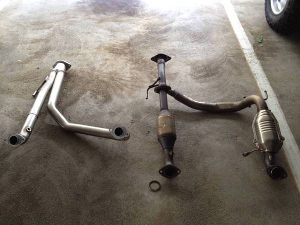

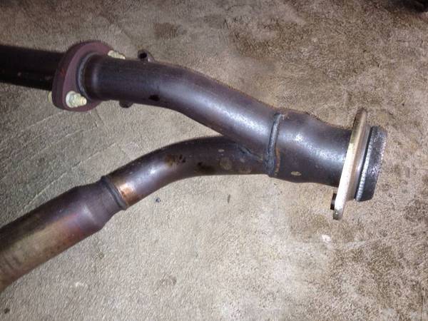

    Here is the 4x4 one for those wanting to see the difference in the collector location
    URD collector
    Stock
    The crossover pipe for driver side to the collector is double walled, so the actual diameter it the size of the pipe entering the collector.
    Without supporting mods, it seems that the powerband shifted into the higher rpm range with a little loss down low in torque. This is probably due to less backpressure from the cat delete. I donn't have enough mods to warrant a dyno run, but that will change in the near future.

    Ah, you said something really interesting...
    The driver side runner is double walled. So the flattening isn't actually the inner pipe being obstructed, but is the outer heat shield! :)
    The stock pipe being smaller in diameter keeps the exhaust gas velocity up and is more for low end torque than for top end performance. The URD runners are longer because the junction is further away from the engine. That should help the low end even though each runner is larger in diameter.
    Technically, the Y pipe is still a part of the header because it's upstream from the final collector. Sort of a really long tube tri-Y. ;)
    I personally believe that cats are flow neutral rather than being an obstruction. They're way larger in diameter to allow the exhaust gases to be exposed to as much catalyst surface area as possible. And the hundreds of individual passageways are all perfectly straight through. I should think that they would actually cause less turbulence.
