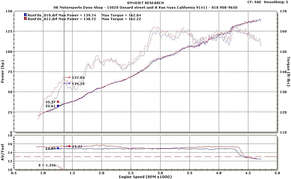

    It sure felt like the Flowmaster pulled better off idle, but I had chalked that up to its neato sound. Now the dyno shows that it actually does do a little better at very low rpms. :)

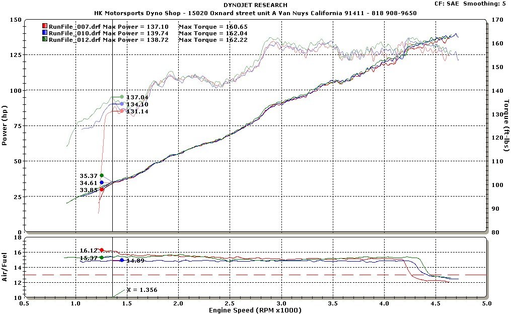

    Well, that was my intention to finally put a stake through the heart of that stupid lie that Flowmasters don't flow as good as Magnaflows. :)
    Check out the dyno runs, with the stock muffler, the Magnaflow, and the Flowmaster. All three are actually pretty close...
    No, the muffler was the only change. In normal closed loop driving the A/F is normal. Right now I'm checking out the Split Second MAF calibrators. ;)

    The dyno runs are SAE corrected for temp and pressure. :)
    Even though they were corrected, the conditions for each day were very similar.

    Another intersting tidbit...
    The Magnaflow hit its torque peak at 2,900 rpms...
    ...but notice that the Flowmaster meets and surpasses the Magnaflow torque peak at 2,800 rpms.
    This is a torque peak an even 1,000 rpms below the stock peak of 3,800 rpms. :)

    In normal partial throttle driving, your O2 sensors feedback signals to the ECU which is constantly adjusting the air fuel ratio. That's closed loop because it is constantly self correcting the air fuel mixture.
    However, in a wide open throttle situation, the ECU ignores the sensors and reverts to a factory preset fuel map which was designed to work on a stock engine... which mine is no longer stock. ;)
    Greg

    All of the A/F ratios indicate pretty much the same lean condition. The preset factory open loop fuel map at wide open throttle can't handle the increased flow capabilities of the engine.
    Greg

    That's what the dyno chart shows...
    It's a modest difference, but it's definitive and consistent.
    Note how the leading edge of each rising Flowmaster line precedes each rising Magnaflow line? That shows the Flowmaster torque coming on just a little bit sooner. The 100 rpm difference between the two peaks quantifies that difference.
    Rather than backpressure itself, I think it's more a matter of retaining exhaust gas velocity. Something is going on inside the Flowmaster that isn't going on inside the Magnaflow, because each one has a completely different design and operates on different physical principles. The Flowmaster just does it a little bit better. ;)
