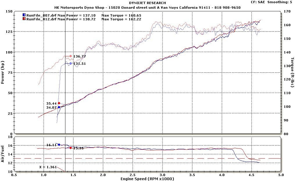

    One more dyno comparison. This is the Flowmaster compared to the stock muffler. Even though the Flowmaster does better overall, they're still quite close.

    The only mufflers on the Moderate/Mild-Stock side of the chart that fit our exhaust is the 50 Series Delta Flow, 60 Series Delta Flow, and the Super 50 Delta Flow. They say the Super 50 is more for high performance applications (large engines), so that is out. I had emailed Flowmaster many months ago asking which would be best for our engine, and if a turn-down is OK. They replied, "Hi Daniel I would go with our 50 series delta flow muffler 2.25 inlet and 2.25 outlet. it will give you the most performance and the best sound for your truck and when you do a turn down run at least 10-12 inches of pipe.". So, the muffler Tooter tested is probably the best for our little 2.7L engine!
    The 70 Series would probably be quieter, but I'm thinking there would be a loss in performance. Not acceptable (for me).
    I hadn't yet ordered a new muffler because I was afraid it would be too loud and sound ricey. After hearing Tooter's, I am sure I'll be very happy with the 50 Series Delta Flow! :D I have one more question to ask Flowmaster, then I'll be ordering mine . . .

    I also came to this conclusion, I just hope the results would be similar with my 4.0!

    Thanks for doing the comparison! I already knew I wanted a flow master for the sound (my bro has the super 40 on his an I LOVE it) but now I'm also convinced of the performance gain; while small, better is still better!

    Much appreciation to Tooter for going to the time and expense to gather this info. But please be very careful about extending his results to the 4.0. The Toyota 4.0 seems to respond differently to performance mods then expected, given other engines. For example, headers, the 4.0 responds totally backasswards to short tube vs. long tube headers then every other engine I have seen.
    Chris4x4 did a similar muffler effort on the 4.0 several years ago that does get referenced alot. His results had a Dynomax turbo muflfer "winning" with the Flowmaster "losing". As I recall though the difference between winning and losing was about 5hp at the high end. To me, these differences are not even relevant differences (same opinion on Tooters results, please don't hate!).
    So, be careful about extending these results to the 4.0, pick your exhaust by sound, and don't increase pipe size if you want to maintain low end,,, IMHO.

    In my opinion, at least some of that reason for different behavior just might be the Y tube which is still technically part of the header (which the 2.7 has none), because exhaust pulses from each bank are merging at a final collector. In fact, the length of the two runners might be instrumental in timing the merging of the exhaust pulses which could have a different affect on the torque.
    A factory stock 4.0 also hits it's torque peak at 4,000 rpms which is a little higher than a stock 2.7.
    It might be really interesting to take a look at some of the 4.0 dyno charts to see exactly what happens to the torque peak with various mods. That would give 4.0 owners the best idea of their 4.0's specific performance behavior. :thumbsup:

    This test showed that a well designed chambered muffler can flow at least as good or even better than a straight through muffler. Heck, even the chambered stock muffler didn't do all that bad, and showed the power of factory R & D design engineering. ;)
