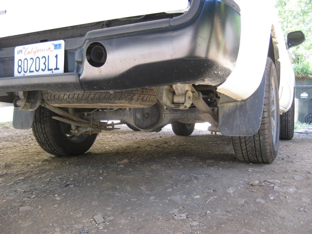

    The leaf springs are under the axle? is this a 5 lug thing?

    Yes. 2.7L, 4.0L XR, some heavily modified 6 lugs.
