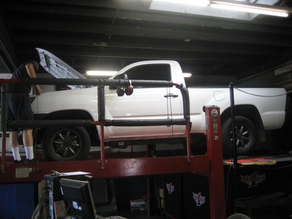

    Did the dyno run today. :)
    And all the Magnaflow muffler produced was..... sound! :laugh:
    Here's the chart:
    The previous run was 4th gear so the speed limiter cut it off at 4,700 rpms. I did this run also in 4th gear so as to be done in as identical conditions as possible. Basically +2hp +2tq... which is a very slight difference between the stock exhaust and the Magnaflow muffler. We did get the run to start recording at only 1,100 rpm because I especially wanted to see what the off idle torque was.
    Run 007 was done with:
    Injen intake
    tooter intake manifold spacer
    LCE long tube header
    stock muffler and stock tailpipe
    Run 010 was done with:
    Injen intake
    22" long 5"X11" oval Magnaflow muffler and 2.25" mandrel bent tailpipe
    Harry suggested that I do some kind of tuning to richen up the mixture as it's running really lean at WOT.
    The Flowmaster gets installed this coming Wednesday. I'll run around a bit to get the ECU to relearn. Then it'll get tested again and I'll post the results. :)
