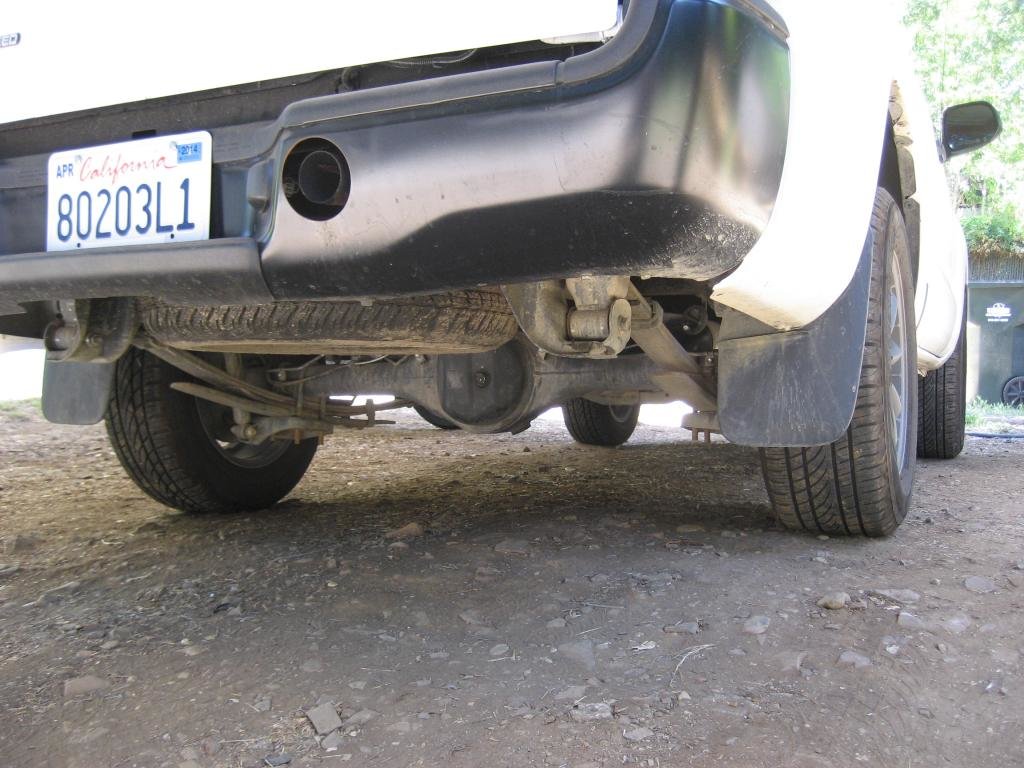

    :anonymous: I haz 4 kink bends in my pipe aft my muffler which is the same 22 inch mag you've got. Will be changing that when URD/Gadget releases the 12+ urd headers :D
    what it looks like now... Great high clearance tho!
