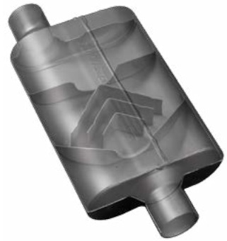

    There are four 50 series models.
    50 series:
    It has one Helmholtz resonator and one Delta Flow plate, but is a quiet muffler. It's got a really big case, and is made only for big block V8's.
    Super 50 Series Delta Flow:
    It's called the SUV muffler. It has a large case, one Helmholtz resonator and two delta flow plates. It's moderately loud, and made for large vehicles with large engines.
    50 Series HD:
    It also has a large case, one Helmholtz resonator and two Delta Flow plates. It's made for large displacement engines like big block V8's, and is aggressively loud with cabin drone.
    This model has a smaller case, three Delta Flow plates, and two Helmholtz resonators. It's made for 4 and 6 cylinder passenger cars, has a moderate sound, and is relatively quiet inside the vehicle.
    The first three are not recommended for our trucks. Our engines are too small, and don't produce enough exhaust for them to properly work.
    I have the 50 Series Delta Flow as it has the most quieting features (two resonators and three flow plates) and is specifically recommended for our smaller engines. It's a #842452 in stainless steel, 2.25" center in/offset out. Got it off of ebay for $105 with free shipping and no sales tax. This one has a smaller case and is designed for passenger cars. And yes, I believe that it will be small enough to fill properly and will be the right size to retain exhaust gas velocity.
    People run into problems with Flowmasters when they get mufflers that are too damn big for their engines and they end up sounding ratty and raspy. Or they get the loud race mufflers that sound great on high performance V8 engines, but end up sounding raggedy on regular stock engines.
    Tomorrow, the Flowmaster gets installed. I'll let you know how it goes. :)
