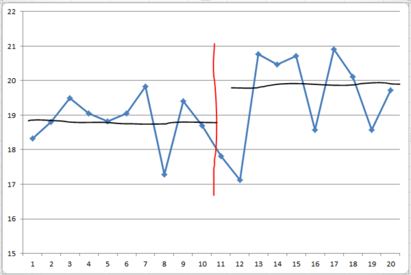

    Really don't know why you assume the Flowmaster is going to cause a power loss. As long as you stay with the size same pipes (which he did) less restriction is better. We'll see what the dyno numbers say.
    Oh, wait, I have some real numbers from a muffler change. But MPG numbers, not HP/TQ. Uh, don't go anywhere, lemme look. I've posted it here before . . .
    OK, below is MPG before and after a muffler change. This was on a '98 F-150 with the 4.2L V6. The change was: cut out the old system just before the muffler, clamp in a 50 Series Flowmaster, and then clamp in a 45* turn-down. (yeah, I always meant to get it welded, never did. It worked fine for 14 years!). I asked Flowmaster if a turn-down is OK, they said fine as long as it is at least 12" long.
    So, I plotted 10 points before the muffler change and 10 after. (I always track my MPG.) The red line is when I changed the muffler. Then I tried to draw a line through the MPGs to get a visual average. The first point after the change was lower cuz I was near the end of the tank so it was really an old muffler MPG. The next point is even lower cuz I was enjoying my new muffler, letting it rev and shifting late. :D Then I settled back to my routine driving. I can see a definite 1 MPG improvement.
    The MPG went up probably cuz the engine didn't have to work as hard pushing out the exhaust? I never ran it on a dyno, but there was probably a measurable increase in HP/TQ.
    And, it sounded great!
