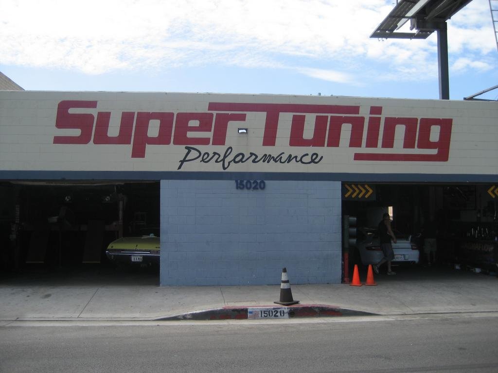

    My appointment is for 10:30 at:
    15020 Oxnard Street
    Van Nuys, CA 91411
    It's easy to get to just a few blocks East of Sepulveda Blvd on the South side of the street. See if you can make it. :)

    Yep, I know the area. I go to a surplus electronics store on the next block. I should be able to make it!

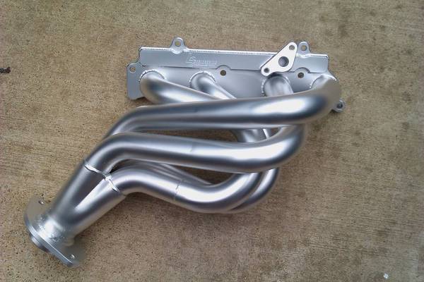

    And the bottom one is LCE:
    http://www.lcengineering.com/
    Both companies utilize the same principles as Formula 1 exhaust designers to achieve equal length runners when the common collector is at a different angle and at various distances from the exhaust ports.
    This is just one example of how competition racing technology constantly pushing the performance envelop filters down to our regular vehicles. :)
    Greg

    Oh, I didn't realize that. URD could integrate the air passages with a larger flange with air holes drilled in it and a cast channel welded on top of it, although that would considerably raise the cost of the header. The LCE is $450 for just one header, but they accurately duplicated the stock air injection arrangement. It works great with no codes thrown even though it's not CARB approved. In my opinion the extra cost of production is well worth it and I was totally happy to pay for it.

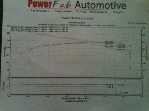

    This is a dyno when a guy added the y-pipe with forced induction

    So if I'm reading that right, and I might not be, he saw ~10 HP increase and lost a small bit of overall torque while gaining very good bit of torque on the low end. If that's what I'll get I'm sold lol, that's only $40ish/HP for a good sized gain of torque right where a truck needs it.

    LCE got around that issue by folding the long runners so as to occupy exactly the same space as the stock exhaust manifold. The cat remains untouched right where it was.
