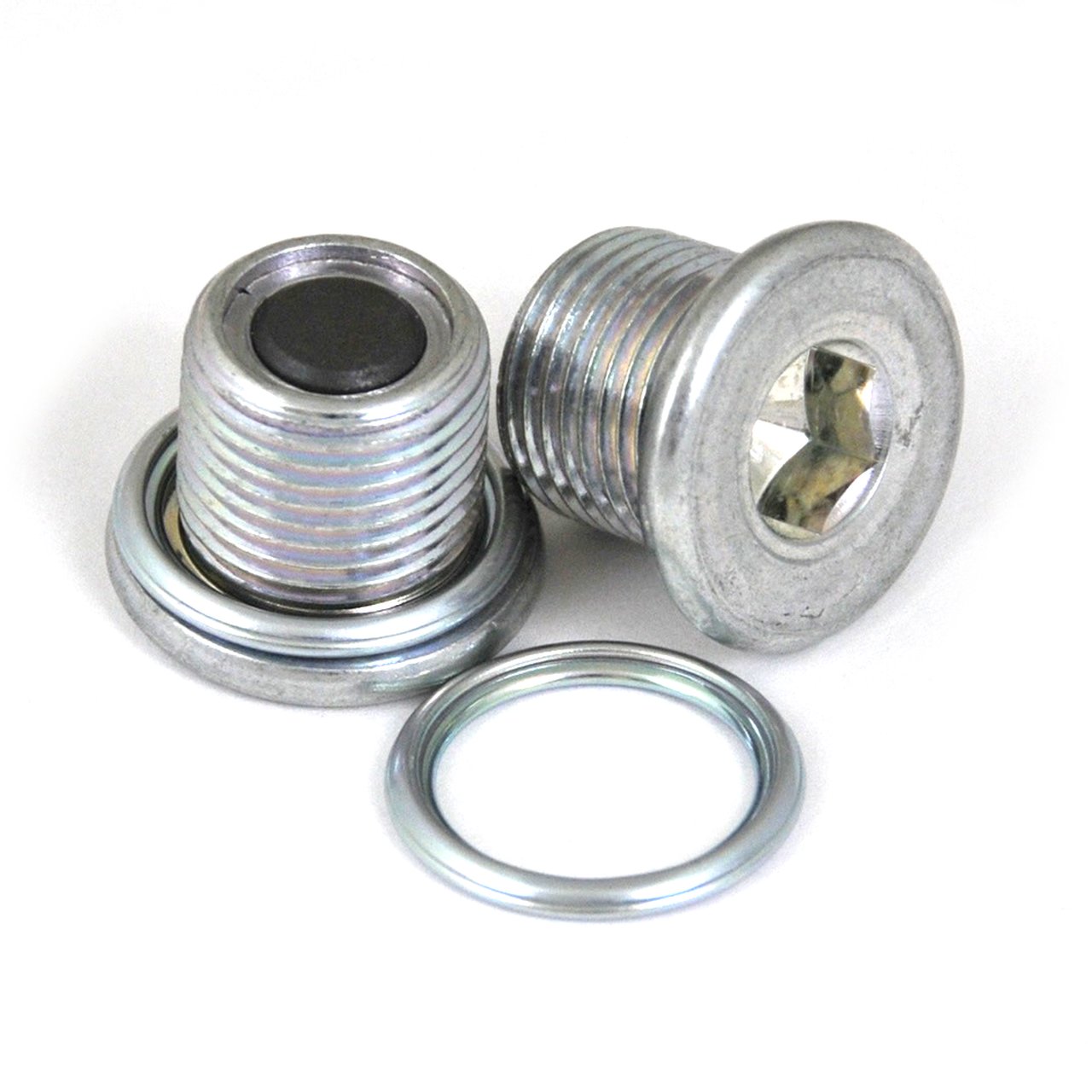

    Looking at stainless aftermarket oil drain plugs: mag drain plug M12x1.25 for 2023 tacoma. What is the proper thread LENGTH which no-one specifies?
    Should I care whether I use disposable fiber washers or the bronze washer that these stainless plugs come with?
    Looks like these drain plugs are machined to accept a press-fit or glued magnet- should I be concerned about it coming loose and wrecking my engine? Has this ever been documented? If the plug is stainless it's not magnetic, or barely.
    I've thrown out a couple of hand tools and unistrut fittings where a "permanent" magnet popped out and got lost or became nonfunctional.

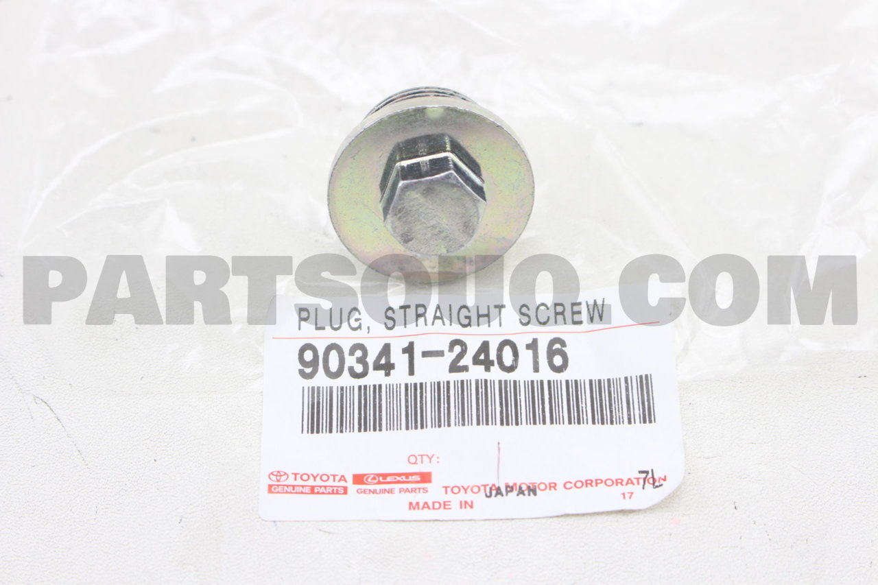

    Lexus P/N PLUG (FOR FRONT DIFFERENTIAL DRAIN)
    9034124016
    Cost me: $ 9.24
    Easier to get off the next time than the Toyota one - get it from a local dealer

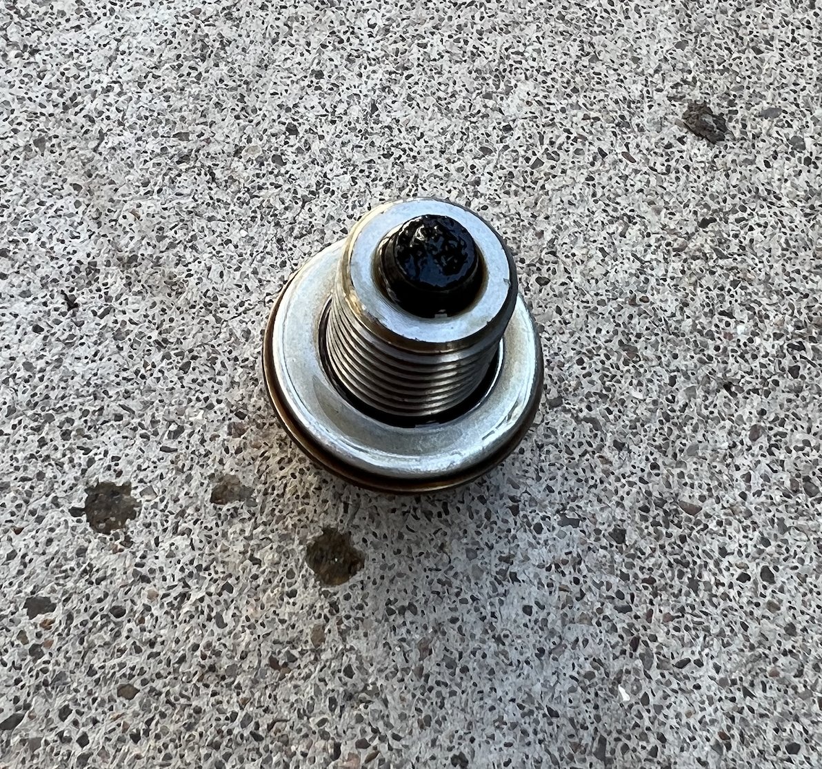

    I did my 500 mi oil change and installed a stainless magnetic engine oil drain plug.
    With my RCI skid plates, draining via a roughly 2 inch dia hole works... but a little tricky.
