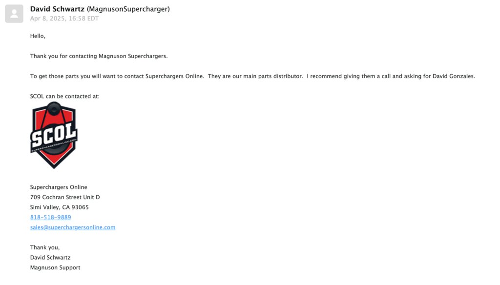

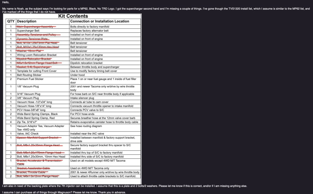

    Quick follow-up about missing hardware/etc. I emailed a list of parts that I don't have to Magnuson and they recommended I reach out to SCOL. Has anyone ordered from them before?

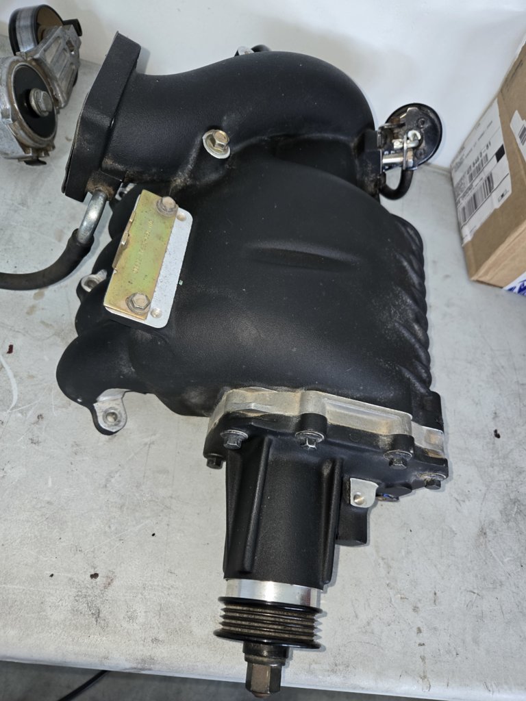

    Going back and forth in an email string with the guys from SCOL, can someone send me a picture of the factory plate that gets removed where the 7th injector mounts? I don't have the factory plate on my SC

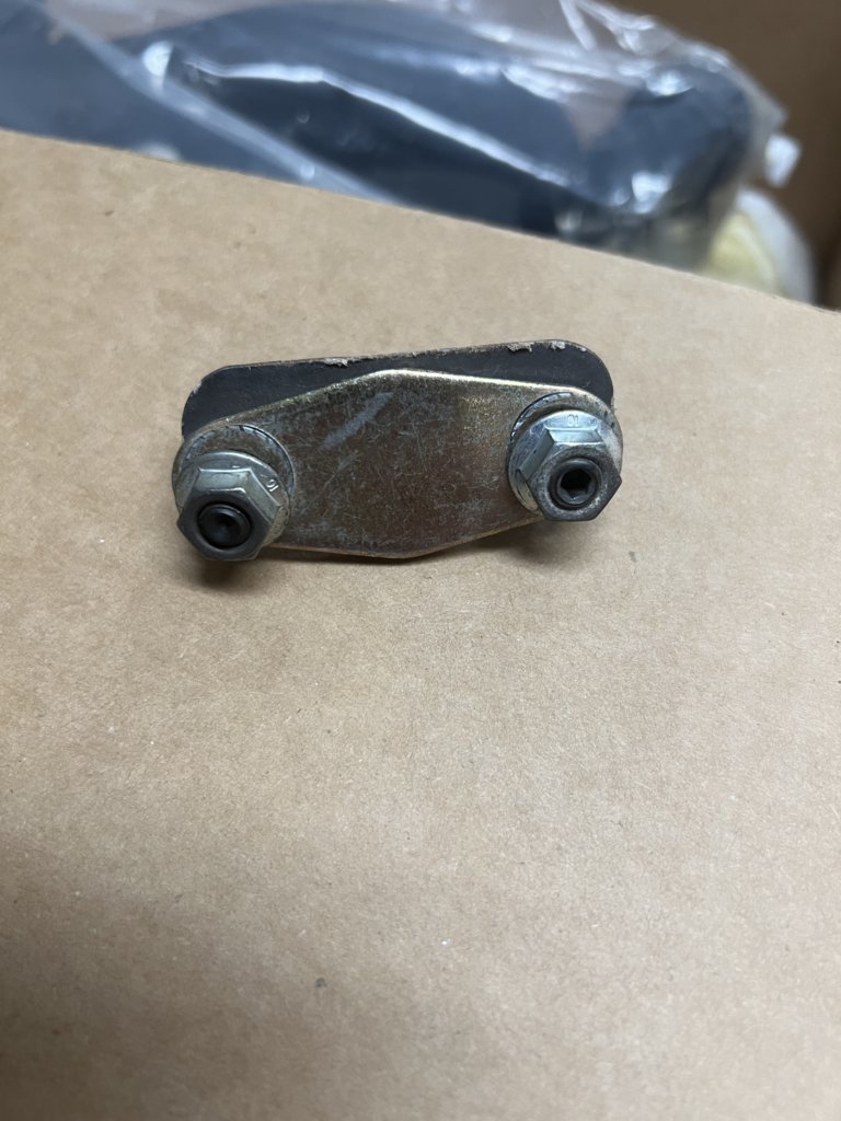

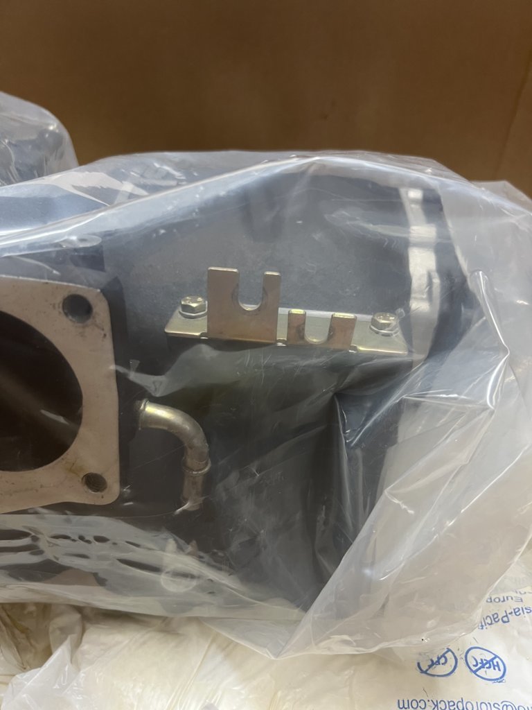

    You might need a different throttle cable bracket, my truck is an 02 and uses a different one from the one on yours.IMG_2814.jpg IMG_2815.jpg

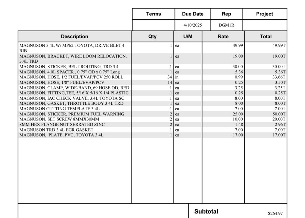

    Fire. Thank you everyone. Got a quote back. Looks reasonable.
    They call the plate the PCV plate. So I had them add it to the order.

    Holly cow they changed you $55 for 2 stickers?

    Yeah I thought that was kind of.. overkill? But I'd budgeted about $350 in "additional parts" cost to mount this SC, so I'm still under budget.. it just doesn't make it sting any less
